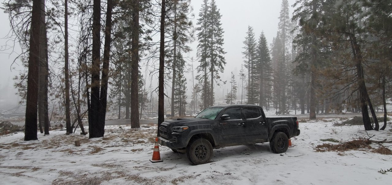

    Hello all, first post here!
    I have had my 2020 TRD Pro for about a year now and it's time to change the stock tires. I use my truck for work in Northern California and spend about half my time on the highway and the other half in all kinds of off road conditions. Currently around Yosemite area and it's snowing. I'd like to keep the TRD Pro rims and just upgrade to a bigger and more aggressive tire, but I'm mostly unsure of size. I have been looking at the KO2's but open to any recommendations. I'm sure you all know the Pro comes with the stock lift but I'd like to add spacers if possible for added room. I'm not well educated on tires and lifts so it's what I'm having the most trouble on.
    Basically will it work to add spacers on the stock Pro suspension and how big of a tire can I go?

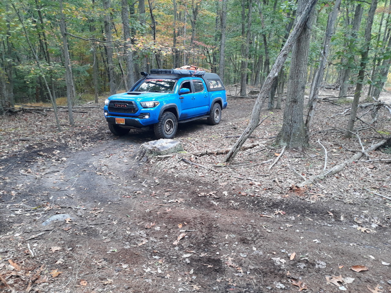

    255/85 r16 Cooper S/T Maxx (33" and the same width as OEM).
    I have not had them in any substantial amount of snow but others that have swear they get the job done. Very quiet, smooth, and wear evenly. I can pull 19s (mpg) on the highway on average. On the trails they are fantastic. If needed, you can drop them down to as low as 10 psi.
    I can say the Duratracs or Ridge Grapplers are better in the snow than BFGs.
