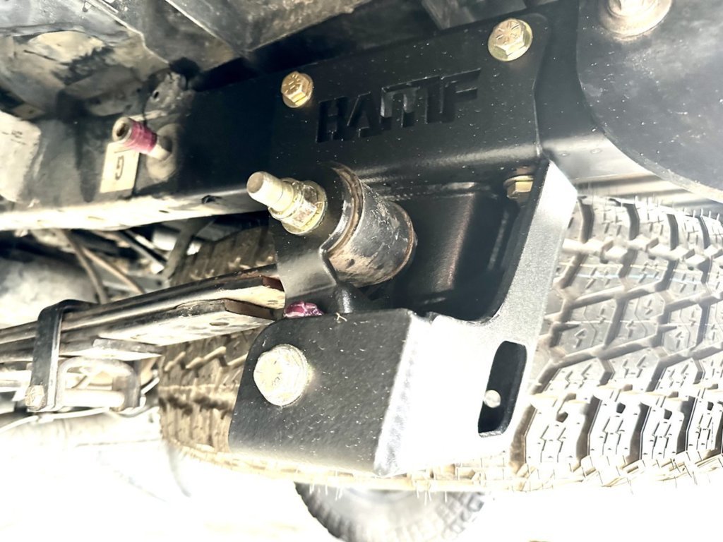

    for that problem you would see the best results with beefed up shackle hangers like archive garage hammer hangers. after i installed them the whole back end of the truck felt united with the front, ridding of the jarring feeling hitting bumps. none of those other upgrades with make you see results like the hangers mod do, actually most of them will make it even worse. for example, people really think they will have a better ride installing bilstien 5100 on the 3-4 notch with stock spring, one or two size up tires where they dont realize what the load rating is, and then to top it off install control arms that have stiffer bushings in them...all making for an even worse ride than stock. theyll never admit its worse because of how much money they wasted and how much little research they did. mods or expensive parts DOES NOT always equal better ride. if your main gaol is to have a more comfortable ride while offroading maybe once a month heres my quick suggestion:

    this is good advice, but if you want to avoid lifting the rear too much you can go with the BAMF hangers and not get the extra 1” of lift in the rear just mentioning

    do they lift up the rear using stock leaf springs? i was under the intention that they do not raise the rear but i used deaver springs and never bothered to measure if they lift because of the shackles. @ARCHIVE

    i think archive hangers yield an additional inch due to the design. BAMFs are a little different, both are stellar products (image not my truck)
    https://www.tacomaworld.com/threads/bamf-hd-shackle-hangers.496200/#post-15373285
