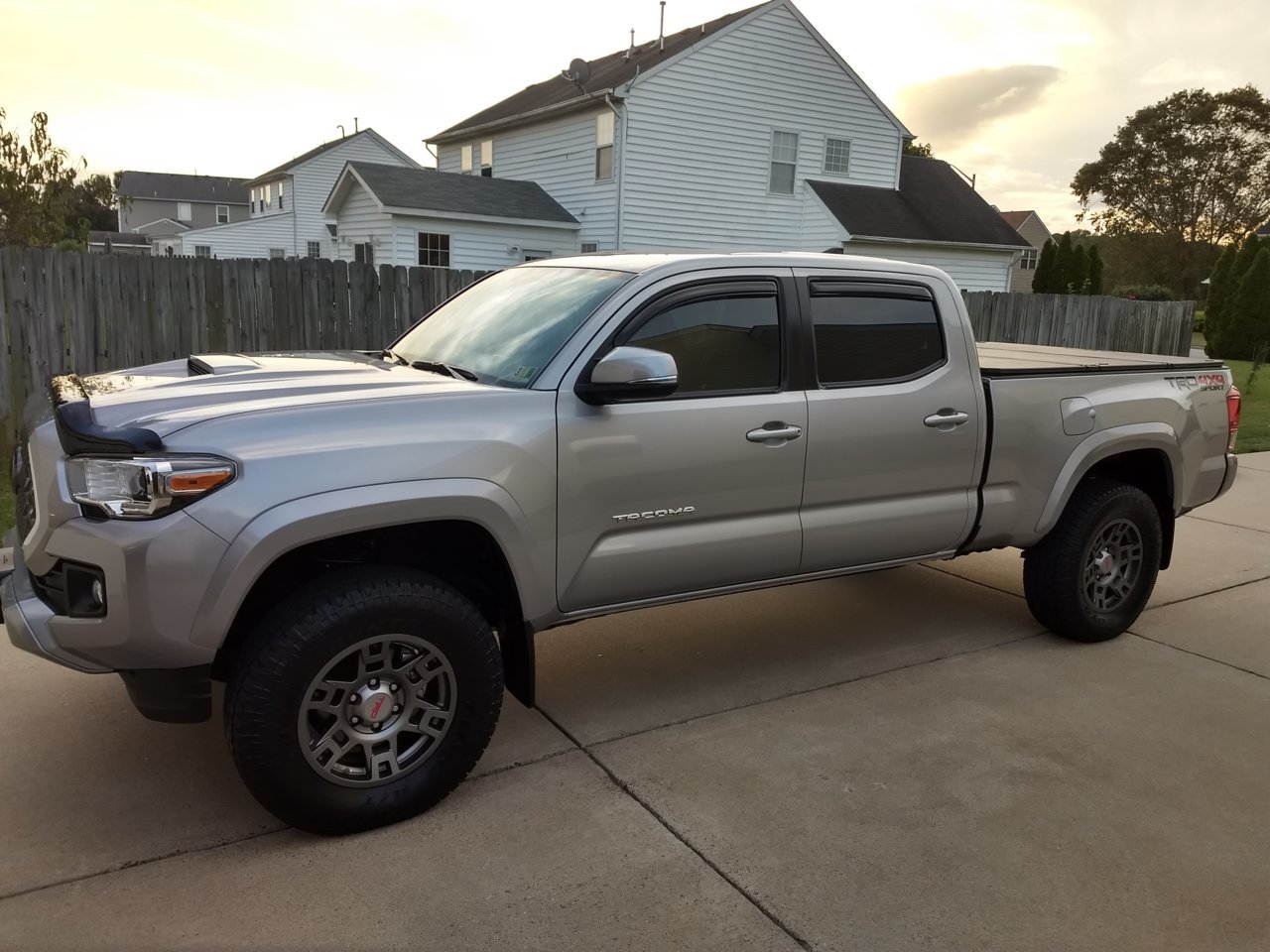

    I'm no expert but I have been studying a lot lately. I just did my 18 DCLB sport. Bilstein 5100 front and rear. Set the front the 4 the notch, 1 inch block in the rear, stock coils and uca. The ride is so much better that stock. I did the 1/4 shim for the lean and a ECGS shim for the needle bearing for added insurance. Then went with 265/70/17 SL rated 40 lbs and some mat grey trd pro Sema wheels which I think weigh in at 24 lbs. So that helps me stays with factory weight specs. Rides perfect and no issues at all with allignment. Now we're setting up a time for my son's 18 DCSB sport.IMG_20181009_181822806_HDR.jpg

    What wheels are those?

    IMG_20181009_181822806_HDR.jpg TRD 4runner pro sema wheels.

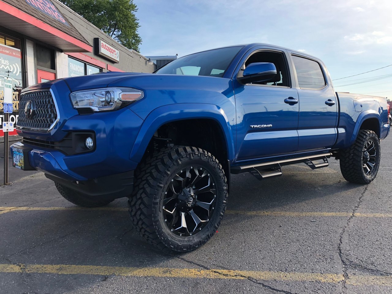

    Options are endless. I wanted to SEE the look on a truck before I picked mine. When I saw what I wanted I knew right away. 500 trucks and I said “that’s the one”. 3 months later I still get excited every time I walk to the truck after work, every time I get in it in the morning. Make sure you love it before spending $$$$. Here’s mine pre-cap.

    Awesome truck man, glad you got exactly what you wanted!
    I am the same way. I want to see it before I do anything drastic so I know what to expect. I will be driving it every single day and want to make sure it is exactly what I dreamed of lol. What are those tire specs/rims?

    I’ll tell you for a longer commute, which I have as well, I’ve been happy with the RC 4” lift. It still feels like factory because it maintains suspension. That 3” is gonna be a little rougher over the bumps.

    Fuel 20” x 12.5
    33” Nitto trail grappler
    I wanted more of a street truck look. A smaller wheel gives you more of an off road look. Don’t get bigger just because. It should match the look you are going for.

    This LB looks super long in silver. I like it. My BBP doesn’t appear to be so extended.

    Aren't those tires designed for more off road? Or more of a multi purpose?

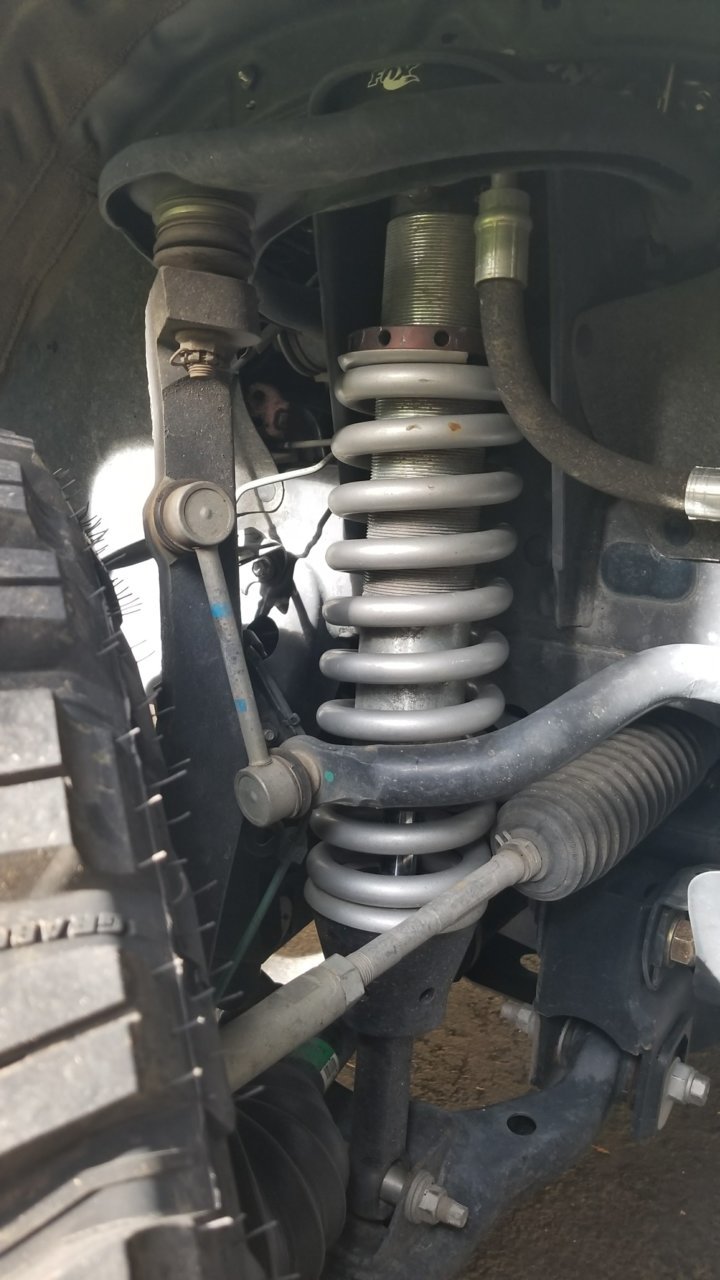

    Open your wallet let the moths out and prepare yourself. Once you start you wont be able to stop, I quit heroin but I cant stop moding my truck. Its a hell of a drug. I have the fox series 2.0 shocks and adjustable coil overs not too expensive like the icons are but still lift it high enough to clear 33s no problem if you plan on removing your mudflaps I would not reccomend getting tires wide enough to go past the fender, you will shoot rooster tails of snow on to the cars behind you. I now remove them during the other seasons but winter they are a must with a wide stanced truck. Other than the lift and a decent pair of all terrains you wont need much more for the snow, you should focus more on preparing yourself for the worst (stuck in blizzard) make sure you have all the right gear to get you through a rough winter night. There was a car pile up on the freeway one night, started by a prius going to tahoe and I was stuck in the snow so long about 5 hours, ran out of gas, had no water or food. But I sure as hell had a nice looking truck but was not prepared enough. Good luck with the truck and have fun with it brother.

    Heck yeah!!! More of a mud tire which mine will almost never see. However they look WAY cooler. They have tires designed for highway but I was going for the look, not the function. I have almost zero concern for mileage / efficiency. I have a second car for commuting and offsetting some of the miles. This is more for enjoyment.
    I have a lifted beefy street truck and I love it.
