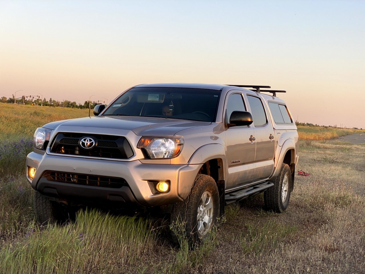

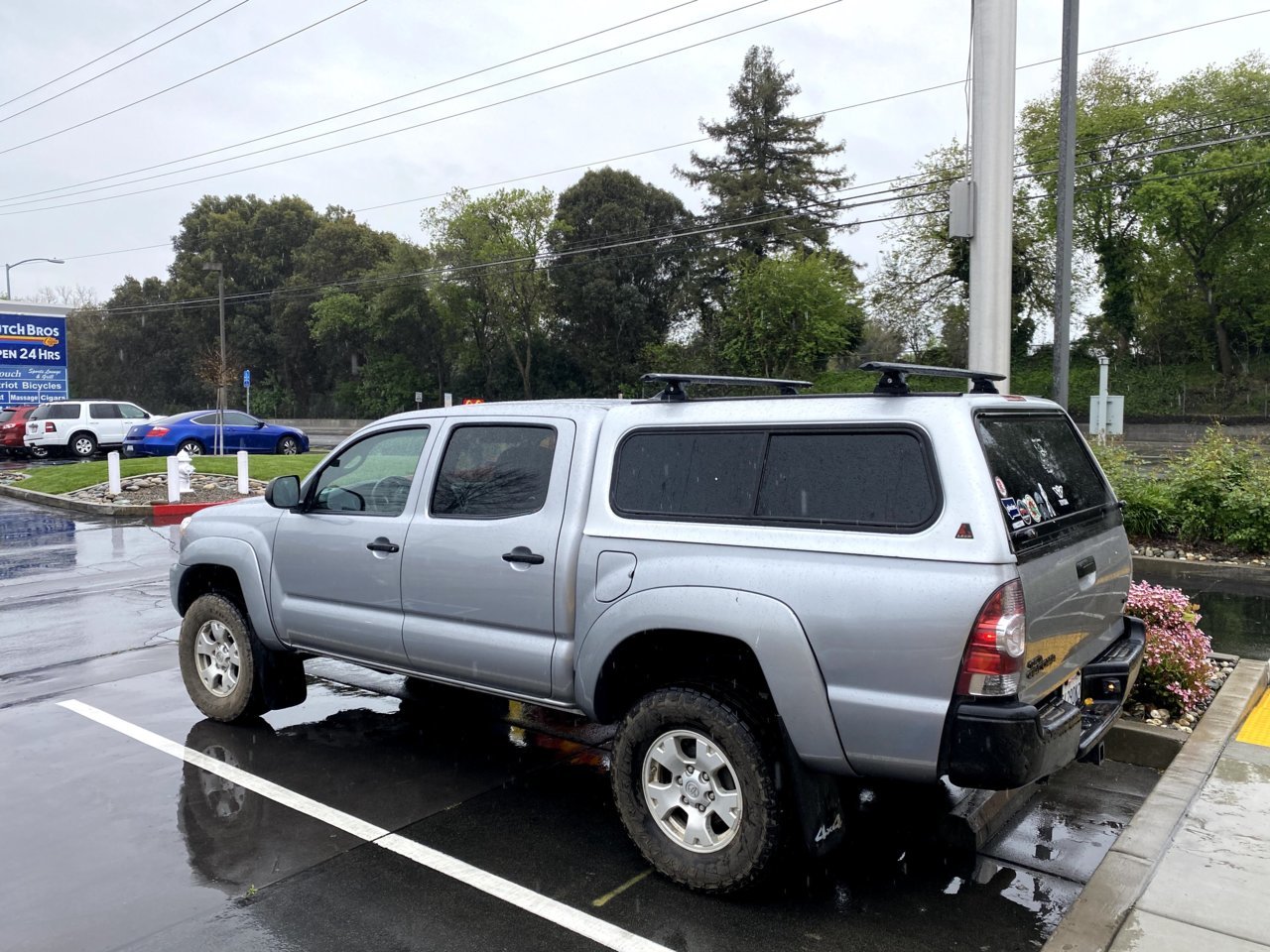

    Crappy pictures, but here you go. I lifted my truck with a spacer lift using the stock hello bilstein shocks.
    it did ride rough. But that is to be expected. I had this set for about 3 months, then found a deal on some 6112/5160.
    I did not need uca. I got perfect, factory alignment. I ran a 265/70-17 later on, and it fit great. With no rubbing.
    and when you buy a uca. Buy only the spc one. the other ones just move your wheel towards the firewall and you will rub your wheels after. Uca are not really needed. Only if to allow more Down travel if your stock ball joint is maxed out….or if the uca is hitting your spring on down travel.
    (pictures are from when I bought the truck and just put the spacer lift on)
