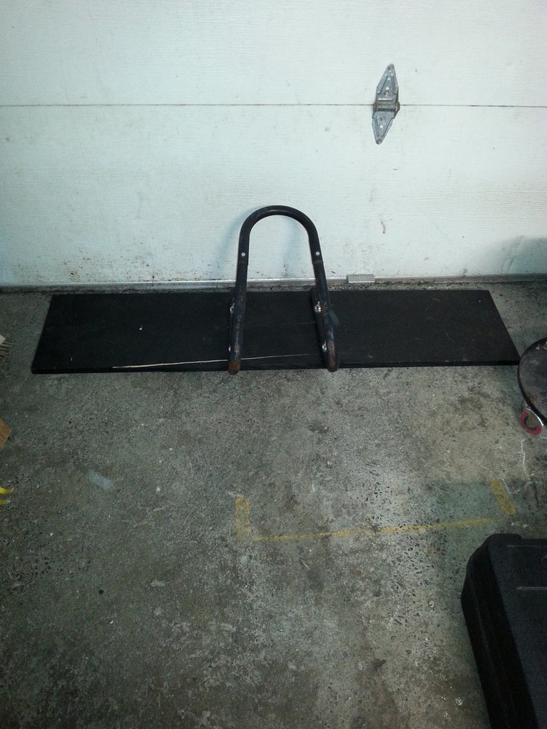

    I prefer this Harbour fright wheel chock(I have both btw) It costs way less, and allows for a better mounting. I mounted it to a piece of wood, cut to fit the front dimensions of the bed. In the pic below, it is built for my old Honda Ridgeline, but I have the same thing to fit at the front of a LB Tacoma bed. It is notched to tuck infront of the wheel wells.
    I use the truck mounting locations for my straps. When I am driving around at my destination it can stay in the bed without being messed with as it blends in with the black paint.

    The cheap one I have mounted to the wood in my post. The fancier one, doesnt have a easy way of securing it in the bed of the truck.

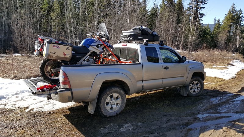

    Thanks for all the advice folks. The trip was a success!
    Bike was rock solid...used a wheel chock and 8 ratchet straps - 4 primary and 4 backups. The bike's rear wheel didn't sit on the tailgate either...
