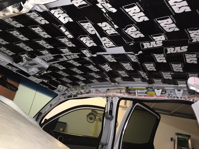

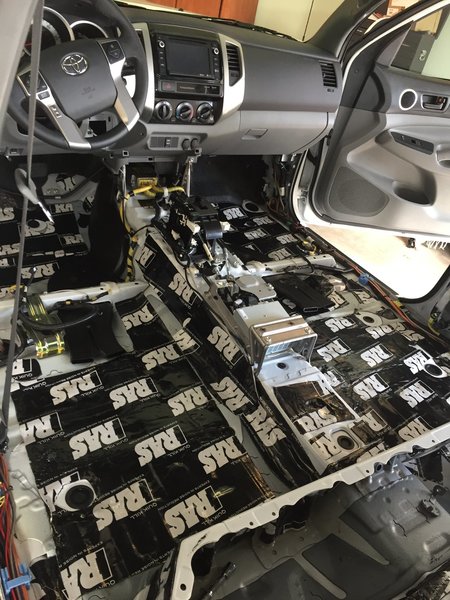

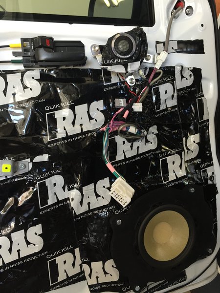

    I sound deadened the entire cab and one of the fenders so far18) 3'x3' sheets. . Upgraded the sound and am good with the results. Pretty quiet at 80mph. And sound is night and day.

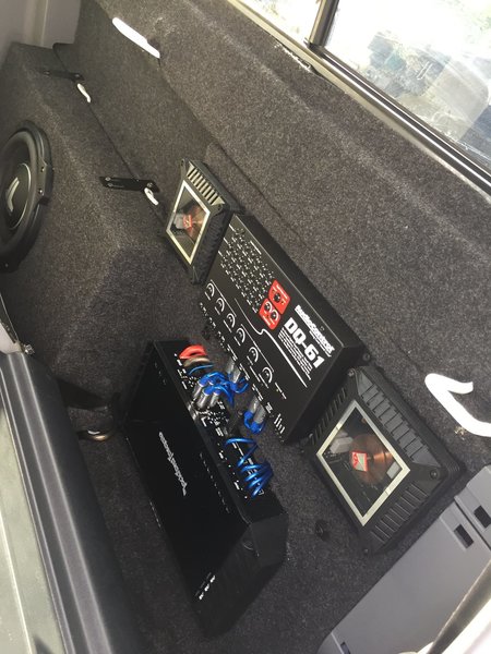

    Will try towel in morn. Thx.

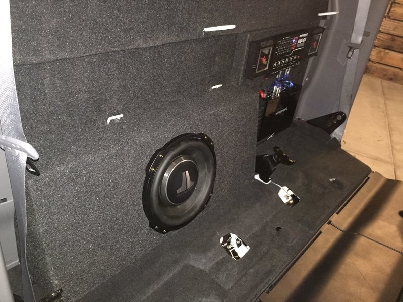

    I keptstock entune. Just have front components and a sub.
    Preamp eq helped. Has alot to adjust. So much depends on eq of recording that u dontnotice as much on lesser systems
    Soundeadening was big difference.

    Wow, that's a sexy install. Mine's a mess behind the back seat.

    the sound deadener eliminated the ringy hollow sound in the cab at freeway speed. the doors shutting and overall feel is more solid.i did one fender and sprayed rubberized undercoating in it and i think that helped with some wind noise. i shouldve done drivers side first.

    I did the same with my cab and the difference is amazing. Well worth the effort...which was substantial.

    BTW that install is tits!

    Where did you get that RAS 3x3 sheets and what's it go for. I tried to Google it and keep getting pest control sites. Lol

    Does removing the headliner and putting sound deadener on the roof really help? Also noticed the sub with the oem radio?
