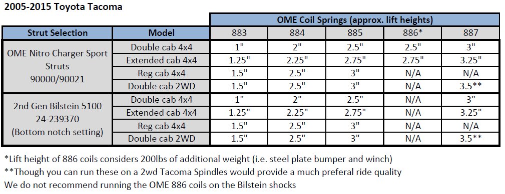

    I'll be replacing my coilovers and rear shocks in a few weeks with my frame replacement. I'd like some suggestions. I'm looking for direct replacement, with no lift. I don't need anything ridiculous. I don't offroad my truck much, but I do tow with it often.
    The ride has always been just okay, so any suggestion would be appreciated.

    Well you might as well stick with OEM if you don't want a lift. However if you are spending all that money you might as well do the Billstein5100/OME 883 coil lift and get 1" up front depending on your setup. 1" should level you out. See chart.
