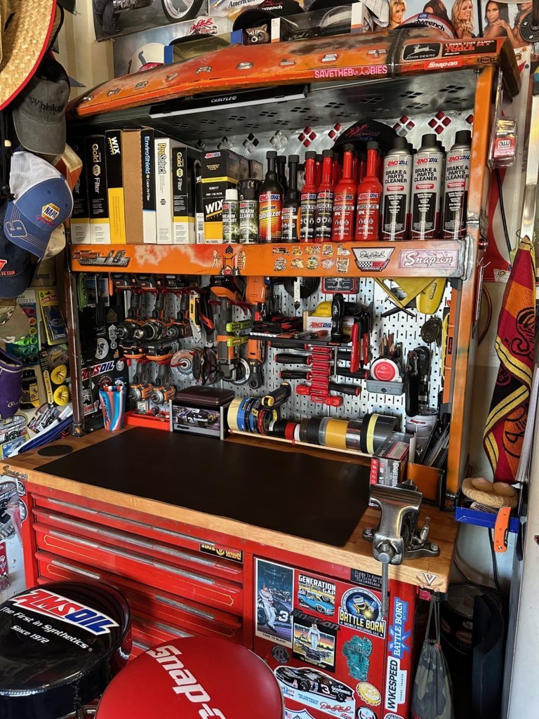

    LOL, you don't have to buy it. Amsoil is not as expensive as everyone thinks it is if you are a preferred customer with an account and buy directly from them. I get free shipping and 25% off list price. I pay $7.49 per quart of oil. I normally get my order within 48 hours of ordering. It works for me. To get that deal you just have to spend $500 a year. With all the cars I maintain and ordering oil for friends I hit that per quarter.
    Kolohe07, MR E30 and Inyo_man like this.

    Agreed, I do not mark it up or try to make money on any of it. I stock a couple of cases of 0W/20, 5W/30 & 5W/20 for my jeep neighbors along with some brake clean, fuel additive and upper cylinder lube. I buy a variety of filters for my vehicles and my friends and families vehicles when they are on sale and keep them on the shelf in my garage. When people need an oil change I gather the things they need and give it to them. I charge $8 a qt and $10-$15 per filter just to cover tax it helps us all out. Don't get me wrong. Most any brand is plenty good enough to use. But Amsoil makes all it's own products. They are not paying one of 5 refineries to produce their products and they do not make products for anyone else. They have been doing this a long time and provide an exceptional product and if done correctly it cost about the same as anywhere else. No brainer.
    I even have a 55gal drum on the side of my house where people can dispose of used oil if they like. Every couple of years when it's full I replace it with an empty and give the used oil to someone who burns it for heat in a shop in the winter. Around here, most places are getting $125 or more for a basic oil change and some dealers are up around $200 now. Even in my GM vehicles that take 8 quarts I can do an oil and filter change for less than $70. And I know it is right and quality products are in it. Those little 3 packs of paper oil filters that Amsoil sells for less than .40 each. They are awesome. Anyone investing the time to do it themselves, it is worth it to look into this route. All the oil fits in my cabinet on the bench and everything else is on my upper shelf. Easy day.
    Inyo_man[QUOTED] and MR E30 like this.
