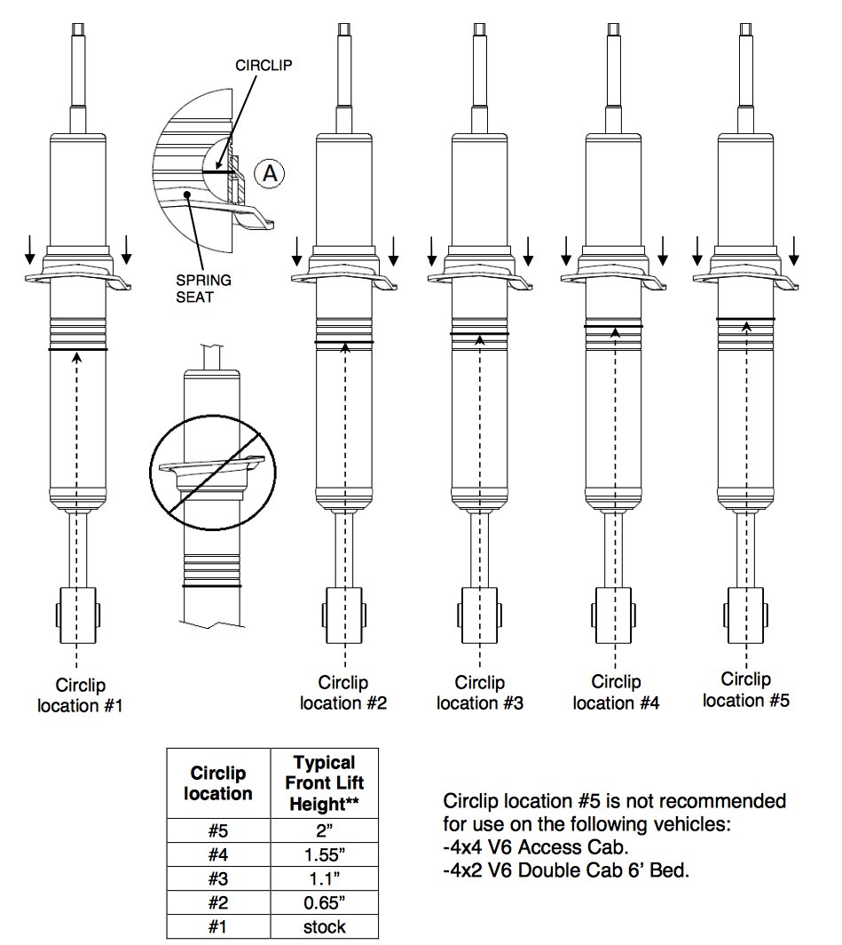

    Alldogs Offroad Complete Lift Kit w/ Bilstein 5100's for 3rd Gen Toyota Tacoma
    ADO Front Coil Spring: Medium (+100lb)
    Coilover Assembly: Unassembled
    Add Upper Control Arms: No Control Arms
    Leaf Pack Assembly: ADO AAL
    Add Ubolt Flip Kit: No
    Add SPC Cam Bolts: No Cam Bolts
    Doesn't say what lift height would be. Any ideas?

    Coil spring will provide lift / leave setting at 0. For rear you could do 1.5” AAL

    There are settings on 5100’s that provide lift. You could use aftermarket coils like provided with kit. So leave settings at 0 when using aftermarket coils. 5100’s can also be used with factory OEM COILS
