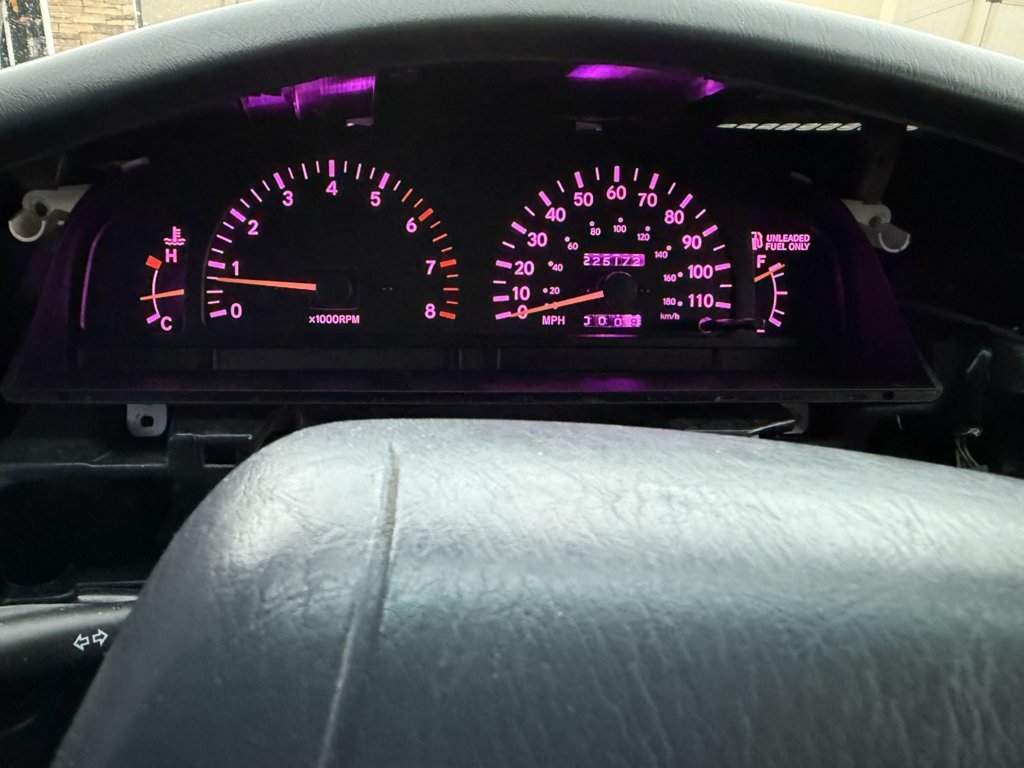

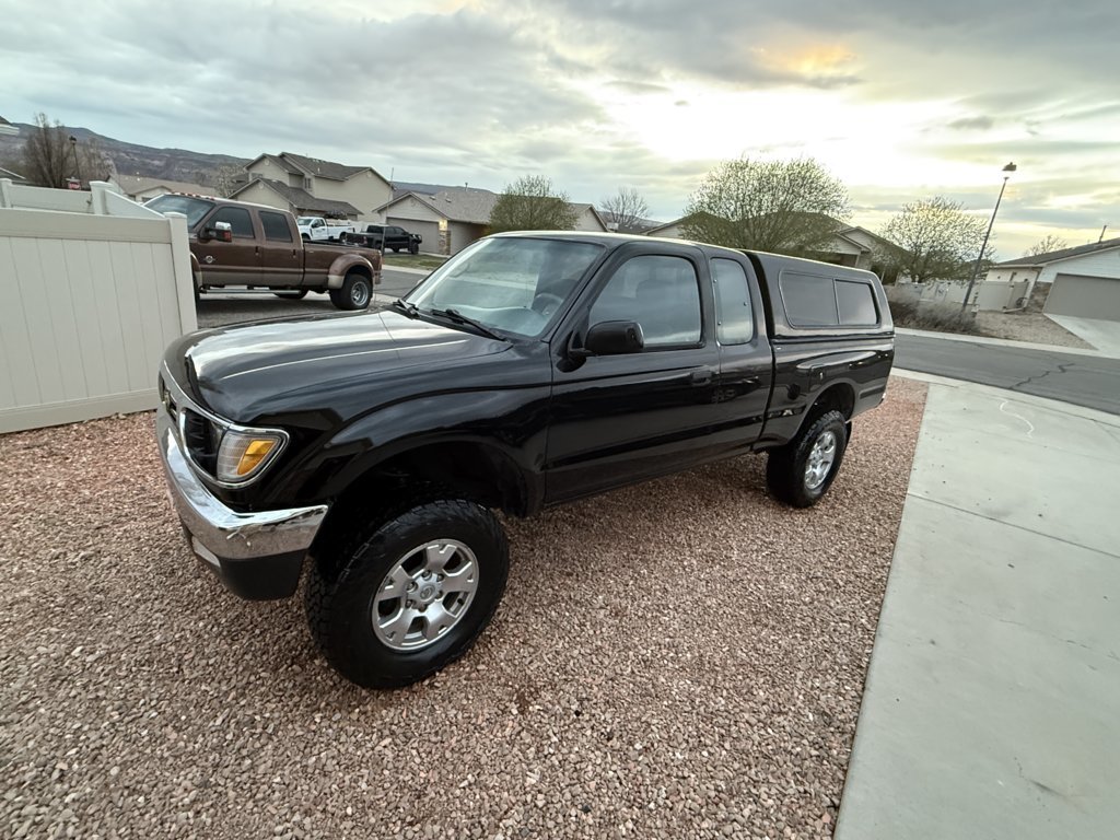

    It’s 4 am and my insomnia/ADHD has kicked in big time. I’m going down the rabbit hole of interior/exterior mods for my 1996 Tacoma. Thanks to the amazing community here at Tacomaworld.com I have been successfully able to go balls to the wall in the three years modifying my truck.
    Things I have done
    Exterior
    Fix cosmetics outsides
    Paint outside of truck
    Fix rust spots and paint underside with “rust proof” paint
    New head and tail lights
    Lift kit
    Shocks/struts
    Lower ball joint
    Brakes
    Shell/Topper
    Paint/coat Bed Liner
    Tires

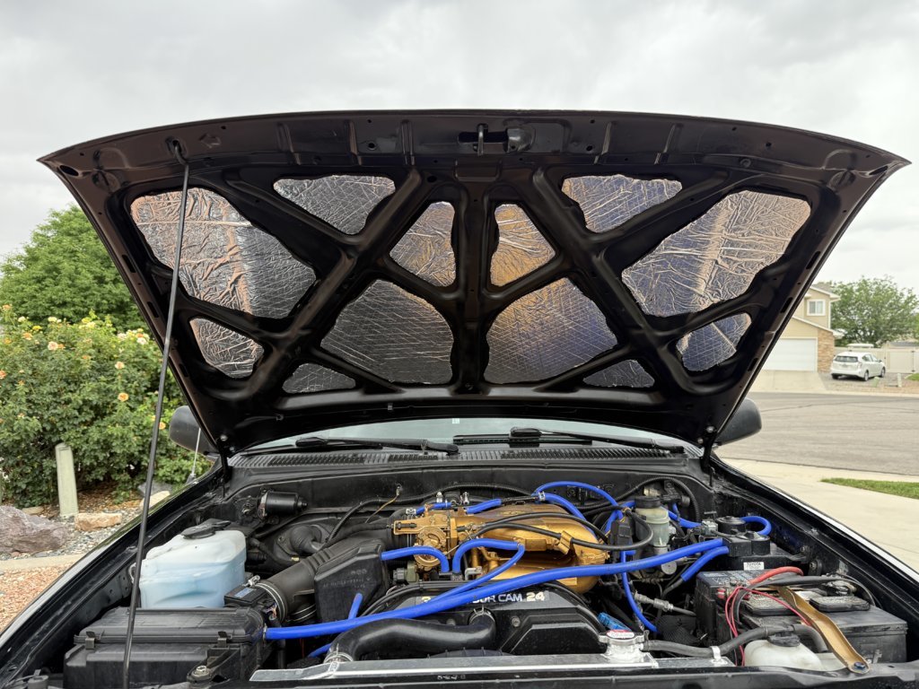

    Sound deadening hood
    Interior

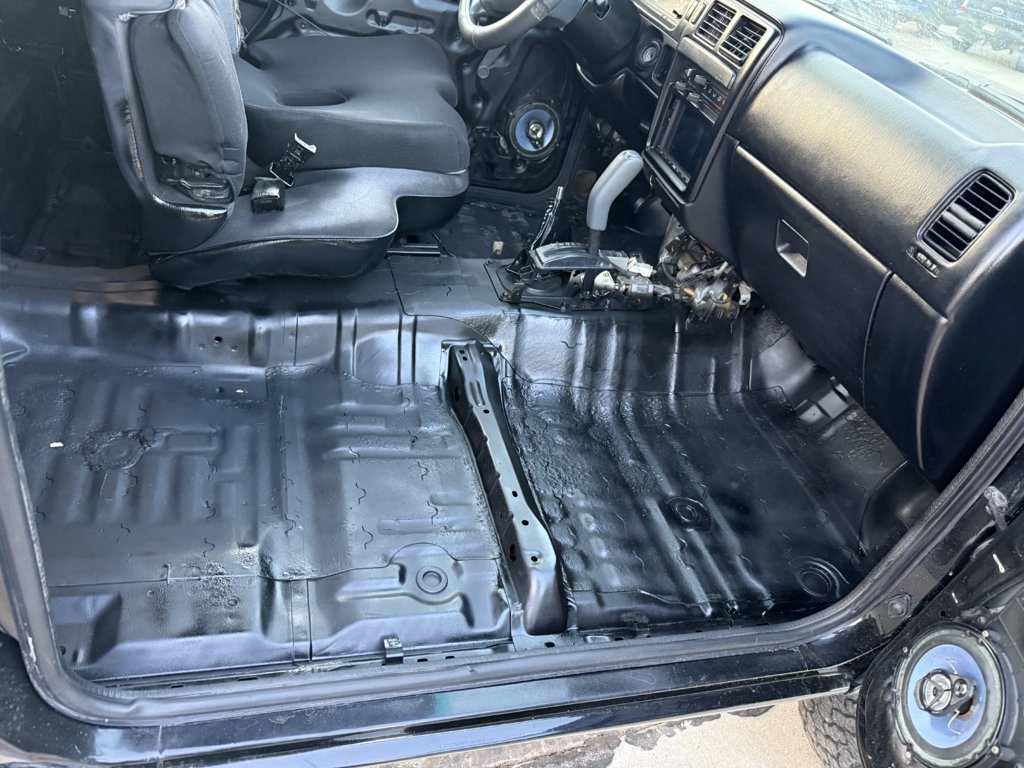

    Complete gut, clean interior

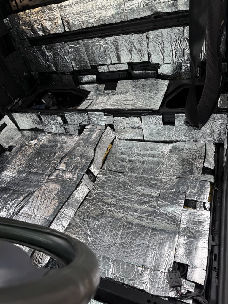

    Add sound deadening and foam to interior
    Paint all interior surfaces

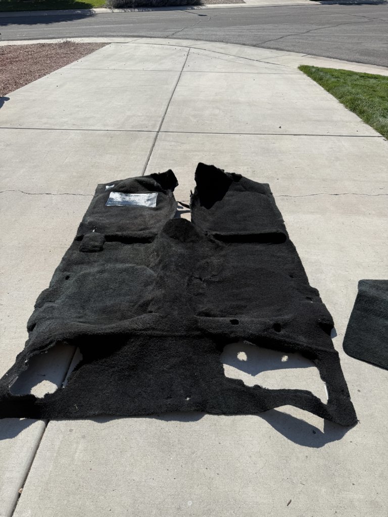

    Paint carpet
    LED Lights interior
    Add overhead LED light from 90s 4runner

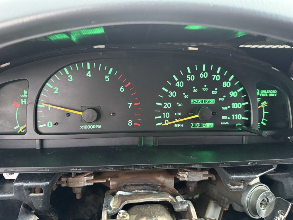

    Blue LED dash lights
    Aftermarket double din radio
    Clean/Polish dash/clock glass
    Mechanical
    Replaced engine
    Head gaskets pre and post new engine (Long story don’t buy cheap engine online)
    Valve Clearance (Fun but holy shit a lot of work)
    Aluminum radiator
    Radiator flush
    Water pump
    Timing belt
    Alternator
    Battery
    CV axles
    Rack and pinion
    Fuel pump

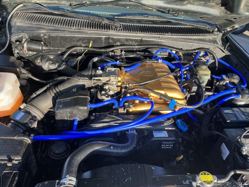

    Vacuum hoses
    Paint engine
    Starter
    Fan clutch
    Replaced all belts
    Replaced spark plugs and wires
    Fuel and air filters
    Oil pan clean and new gasket (Fuck getting this out)
    Valve covers replaced with new gaskets
    New gaskets for anything with a gasket on the engine
    Replacement of charcoal canister
    Vapor Canister Purge Solenoid
    Aftermarket Horn
    Cup holder that attaches to shifter
    A bunch of other engine replacement parts but I don’t remember
    Anyways the reason why I’m posting is for advice on future mods
    Things I’m thinking in the future
    ARB bumper
    Winch
    Paint Rims and brake calipers
    Clock replacement data screen from solvefunction.com
    Mechanically this thing runs great without any current issues and I have zero thoughts to ever sell this Tacoma.
    I’m a sucker for and looking for those tiny little mods or add ons you can add such as the little clock I mentioned above from solvefunction.com and the overhead light from a 4runner or the color LED lights on the dash that are fun/functional that make life so much nicer.
    What are your thoughts about little things you have seen or added to your 1st gen, especially interior little doodads?

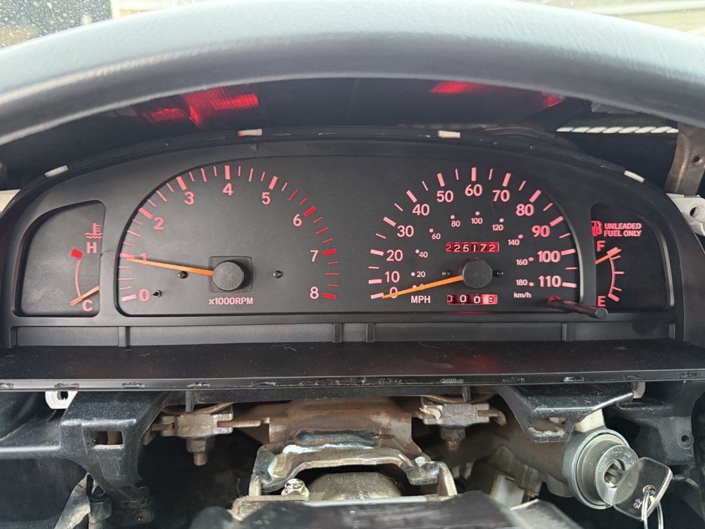

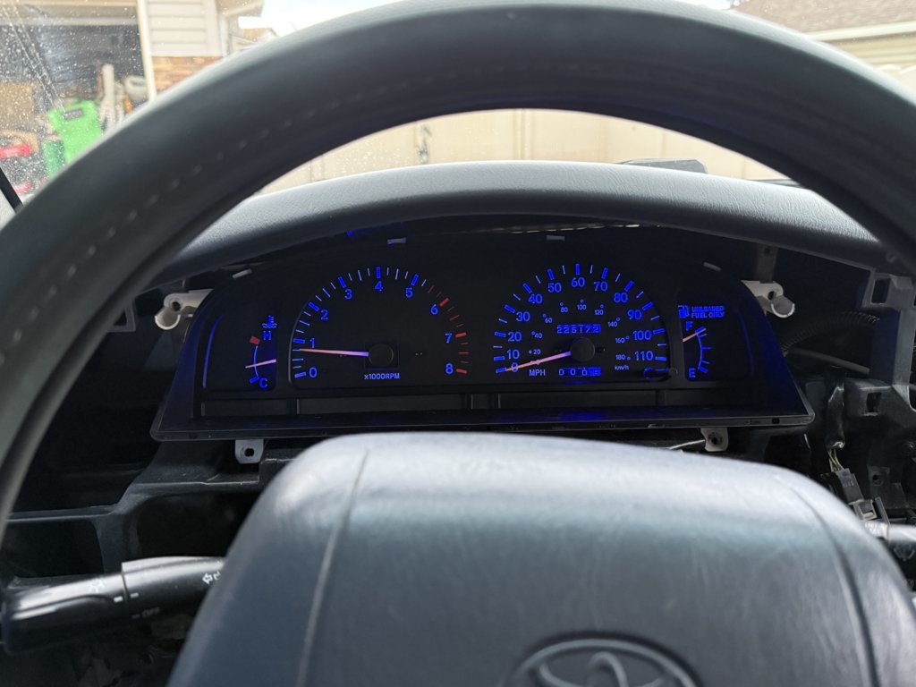

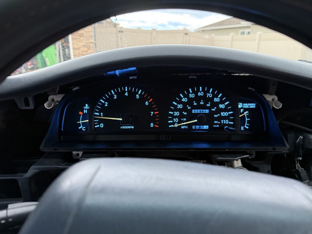

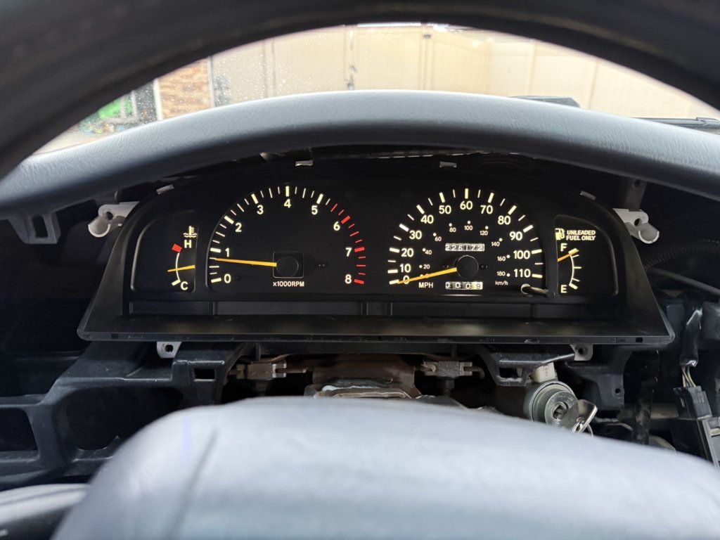

    Blue LED dash lights. I want to learn how to do that mod. Looks great.

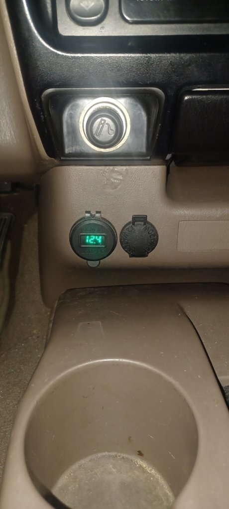

    I did the USB/voltmeter charger mod this weekend bought off ebay. I dig it.

    I need to do my vacuum hoses. Did you buy a kit?

    I bought the vacuum lines from eBay. They were roughly $30-40. Best advice I wish I would have followed was start with the smallest lines and then finish with the biggest lines. I was told to do that, didn’t, instead choosing to do right to left or left to right which definitely left me with forcing a few lines into bigger or smaller then what was called for.
    I really like the volt meter. I was thinking that and an extra charger. Especially to that weird piece of plastic trim behind the shifter and below the cigarette lighter.

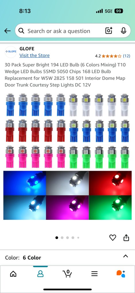

    The blue dash lights are off eBay or Amazon. They came with green, normal blue, iceberg blue (the ones in the picture), purple/pink, white and red. They are look good but the ice berg blue matched my aesthetic best. They are like $10ish dollars for 6 of them which I think you only needed 4 to do the dash

    Say more about "painting the carpet..."

    I pulled the carpet and did a deep wash of it. I then tried to dye the carpet with 4 days is a barrel with hot water, vinager and 5 things of dye solution but that didn’t work literally at all. You can see the difference between just dye on the left and 1 coat of paint on the right.
    The dupli-color vinyl and fabric paint worked wonders. It definitely has its pros and cons but the best way I found to color the fabric. You have to “scrub” the carpet with a thick bristle brush after to break up a little bit of the paint so the carpet is not so stiff. After two coats it looks and feels greats.

    Also for sound deadening using a butyl sound deadener on the floor pan is very low value. Those work by stiffening up otherwise resonant panels, thus cutting down on resonance sound. Our floor pans are already pretty stiff from all the bracing and seats being bolted to it. The best results/value for sound deadening the floor pan is to use mass loaded vinyl.

    At this point, I would just order a carpet kit online in the color you want.
    I’ll have to search but there’s a company out of Utah that makes high quality replacements.

    I appreciate the advice but a little too late on the butyl rubber. That being said I can totally see your point. The butyl rubber had a small bit of foam on the top already which I then added a thick actually foam over it anyways which made a significant difference with the radiant heat and a surprisingly large amount of difference with sound vs what was on there before. It’s not perfect but a bunch better than what was on before.
    As far as the carpet I looked into replacement with carpet or with new vinyl flooring and hard to justify when the carpet I have is in decent shape but just wanting to change the color.

    Oh yeah the butyl rubber will definitely help significantly with heat transfer. And that closed cell foam is great for reducing the higher frequencies.
