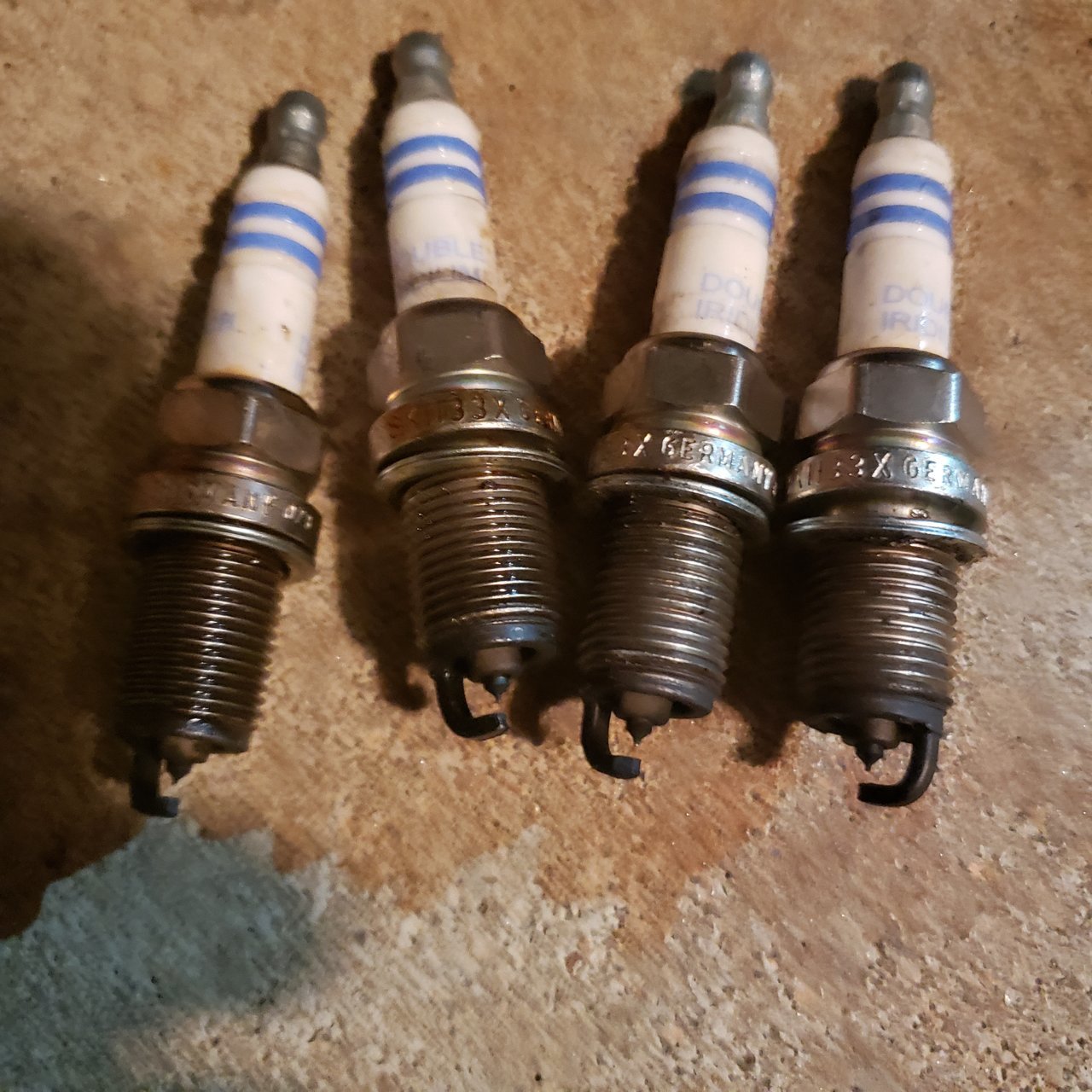

    My 98 Tacoma, 209k miles) began knocking a bit and was hesitant on accelerating, so I decided to put in new spark plugs. I did not put in wires as my budget was zero. I opted for the Bosch irradiums. The guy at Advanced nAuto said they needed to be gapped at .040, and 3 were straight from the box. The other at .038, which I made to .040.
    Don't know what I did wrong, but it began "coughing' after warming up and idling at redlights. Called Advanced and others with the question about Gap. Some said .032, others .040, others still, .044. with all saying the difference was because I swithced to Irridium.
    I had to drive it that way a couple of days. Today, cold and windy, I pulled the plugs to recheck.
    They don't look right. The center electrode on all 4 is just a pencil point. And there was oil on the back one. What's a poor boy to do?

    It's less Tacoma and more mod
    Well, Toyotas historically don't like Bosch ignition products. And v6 tacos require dual electrode plugs.
    Either a Denso 3194 or an NGK 3967 is what your truck should have.

    If you have a 4cyl you want
    Denso 3119 or NGK 2087
    But it sounds like you may have another issue to be honest

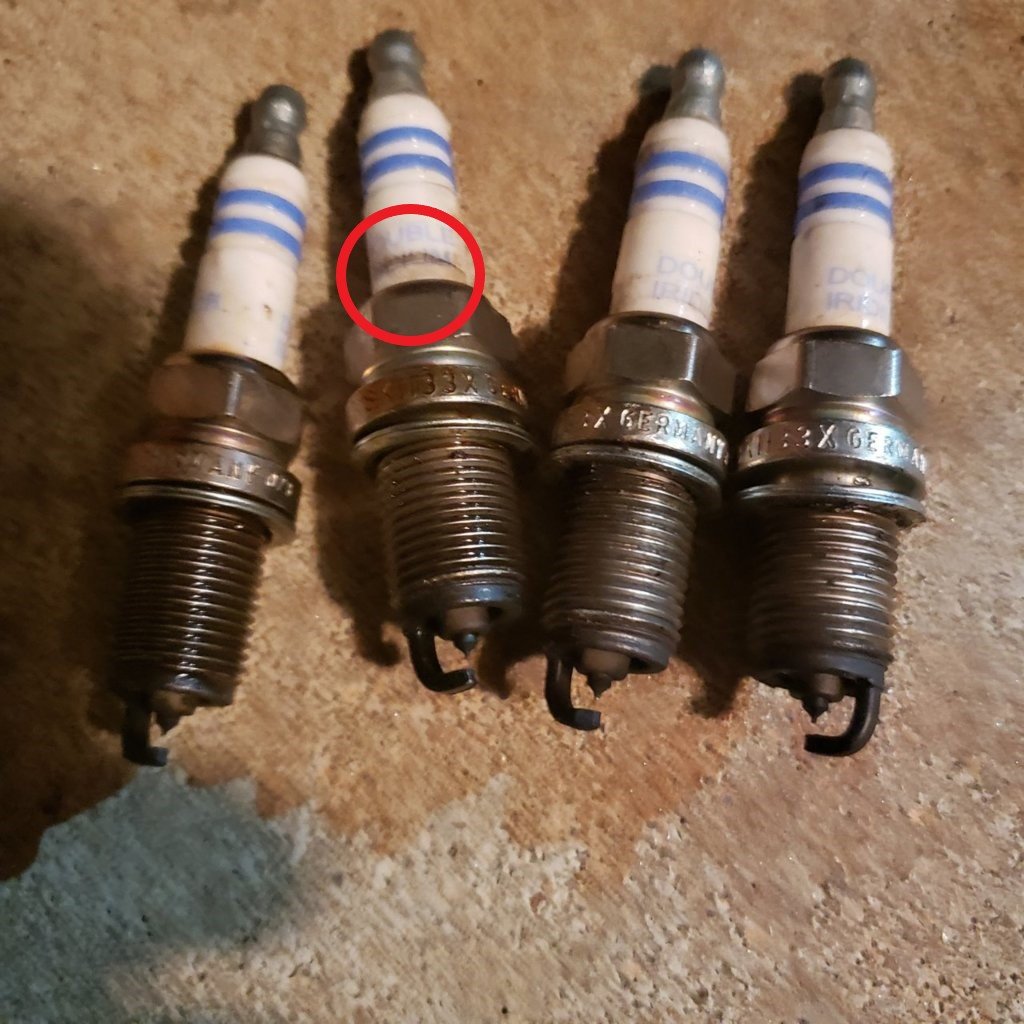

    Anyway, here are the iridiums after >200 miles. The Oems have got me cranking fine, fires right up. And as long as I give it a little gas, it seems to idle alright. But take my foot off the gas and the shaking commences until she bogs down roughly.

    The plugs look a bit dark for 200 miles, but it is hard to read the plugs. It depends on how you did the engine cut.
    Anyhow, your idle issue is likely not related to the plugs. Many items can affect the idle. Sensors, MAF, throttle body, injectors.........

    Are you sure the "coughing" isn't a misfire? Has the CEL come on at all during this poor running? Even briefly? You could have easily screwed up a plug wire during removal.
    Alternatively, could you have forgotten to plug the MAF back in if you removed the intake plumbing (this would eventually trigger a CEL)? I don't think you have a vac leak because those plugs look sooty, like you're running rich, so it's probably a plug wire.

    Also, what's that (red circle)? Is the insulator cracked? If not, why is it so dirty after only 200 miles?
