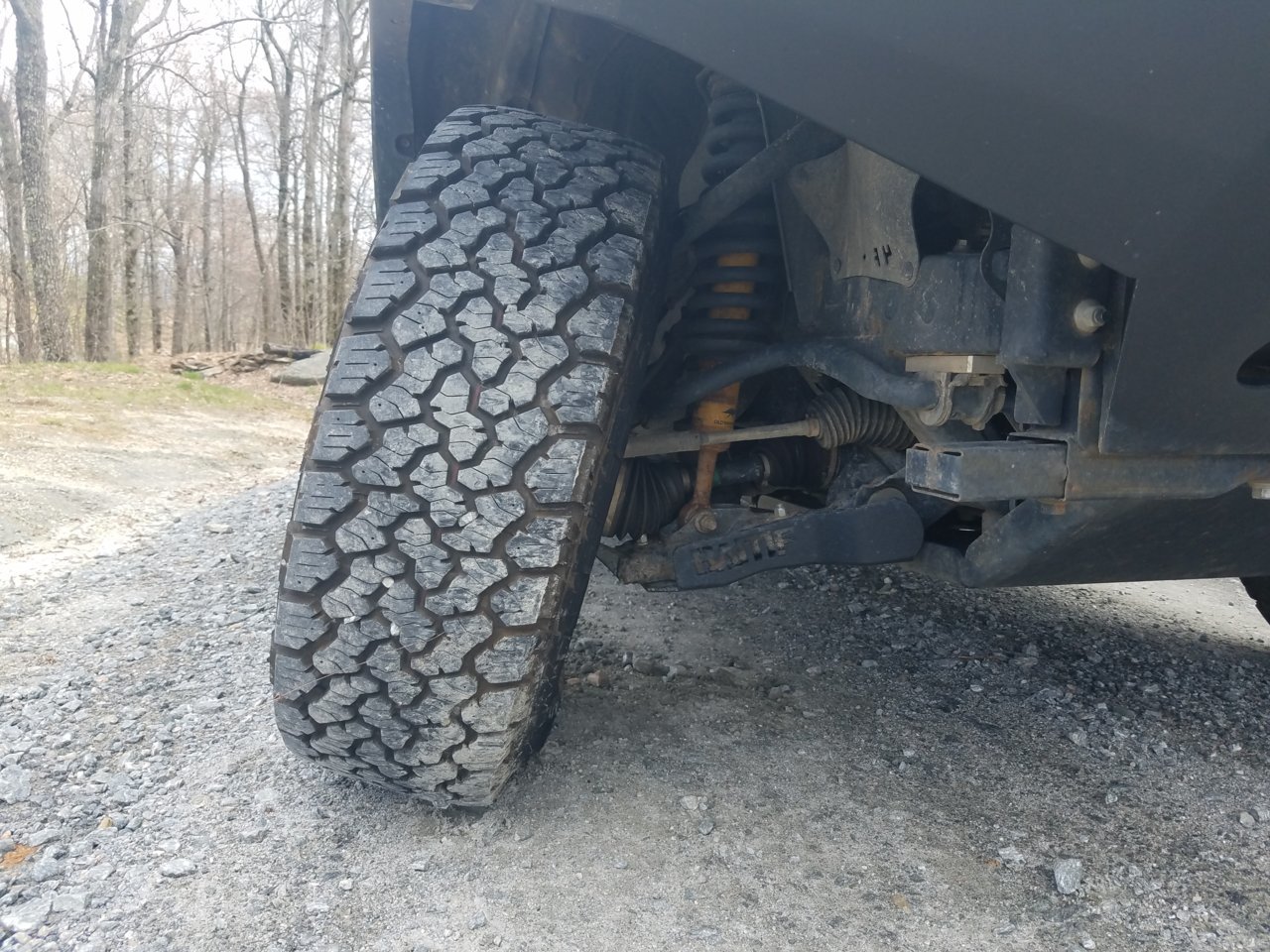

    In 4wd going up an incline and felt the truck bind up, front control arm looks like it broke at the ball joint. They're SPC arms about five years old. I'm panicking and trying to get my insurance to come out to tow. My insurance may cover it, what kind of damages am I looking at? Tire probably punctured, control arm, possibly cv axle or anything else suspension related over there

    Aren’t the UCA’s supposed to be rebuilt/services regularly? I haven’t dealt with insurance with situations as such but my guess would be unless you reported your aftermarket components/add-ons they might be hesitant to cover damages. It doesn’t look like you damaged much, my best guess would be maybe damage to the CV shaft? Everything looks intact. You’ll know more when the tire comes off and start moving stuff around. Best of luck.

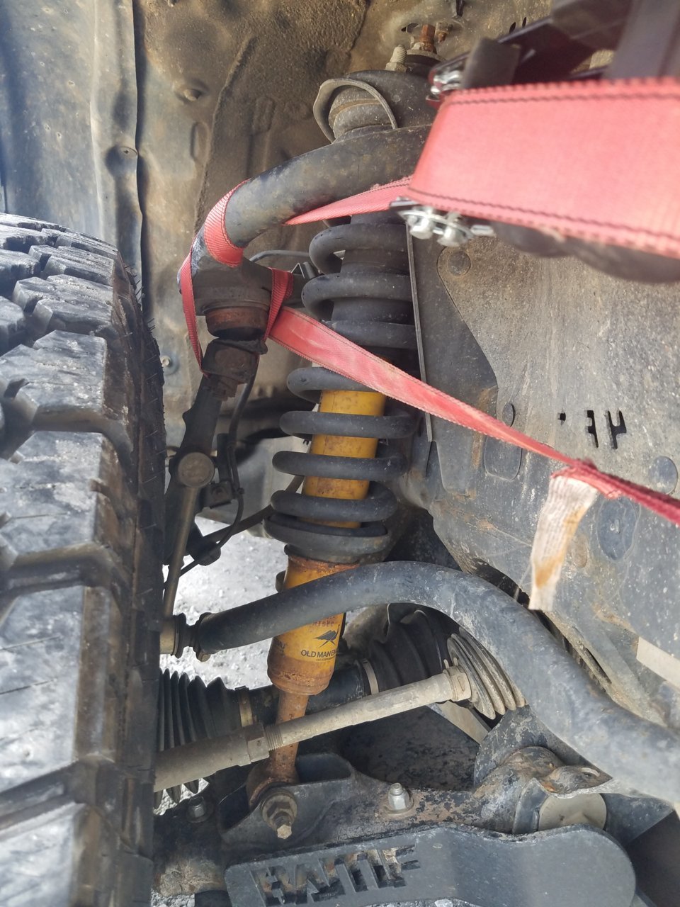

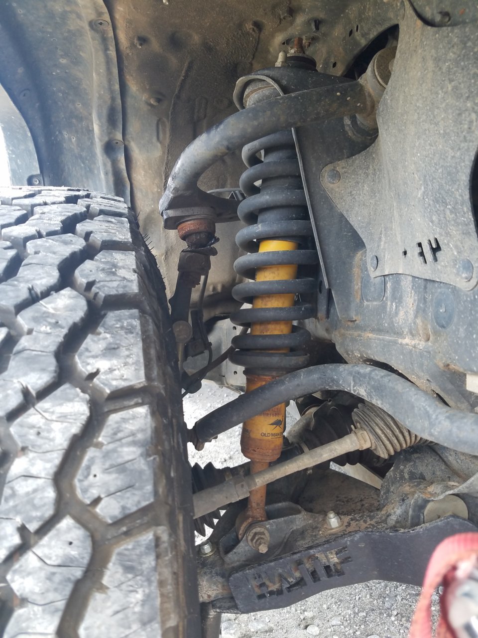

    Got the wheel up and control arm is center back on the ball joint, where should I throw the straps to keep it together
    Alexely999 likes this.

    I'd probably try making a V from behind the bolt to either side of the ball joint. Hard to explain.

    Thank you for the ratchet strap trick, drove it forward and took out of 4wd. Not sure I should try going farther, tow truck is on the way

    I think you're gonna need a few more raps around the spindle and uca.

    Make a lot more wraps around where the ball joint should be to hold it together once it starts flexing. A V pattern back and forth between both sides of the upper arm where the ball joint mounts and both sides of the spindle where the nut is might work.

    Before you go on with that, if you have a piece of leather or something else to put between the strap and spindle. This will help the strap last longer before it cuts.
