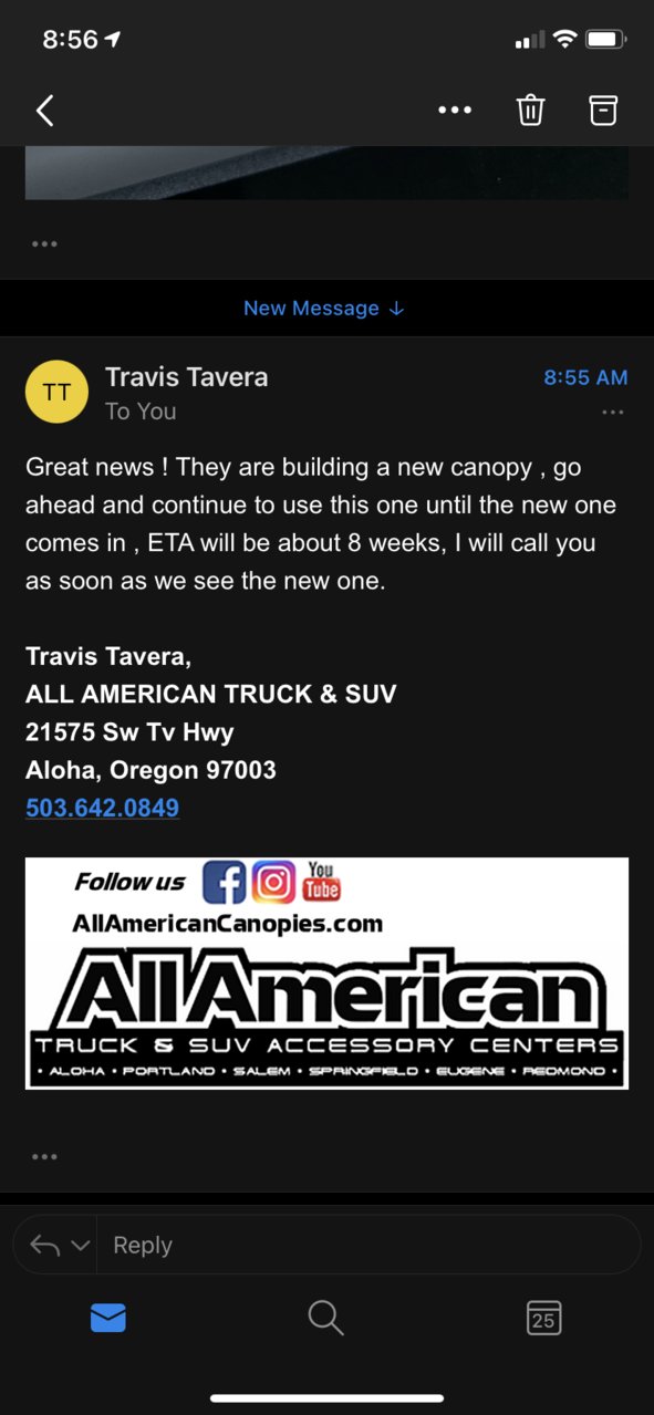

    major win! hahaha for now being the key term... until the next one shows up and I have to do it again :rofl:

    Really happy to see this! Crossing my fingers it’s second time lucky, but still glad they’re standing by the product and making it right.
    Keep us posted on how take 2 looks.

    I truly hope I got one hell of a lemon, but I’m starting to think I got industry standard and had too high of expectations before buying. I’ll update when new canopy comes in. You can bet I’m doing a full inspection before it gets installed

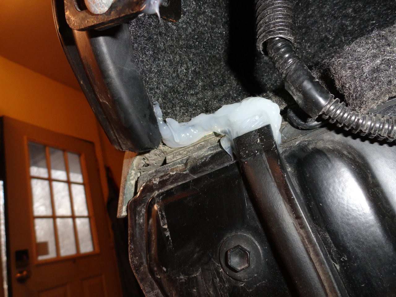

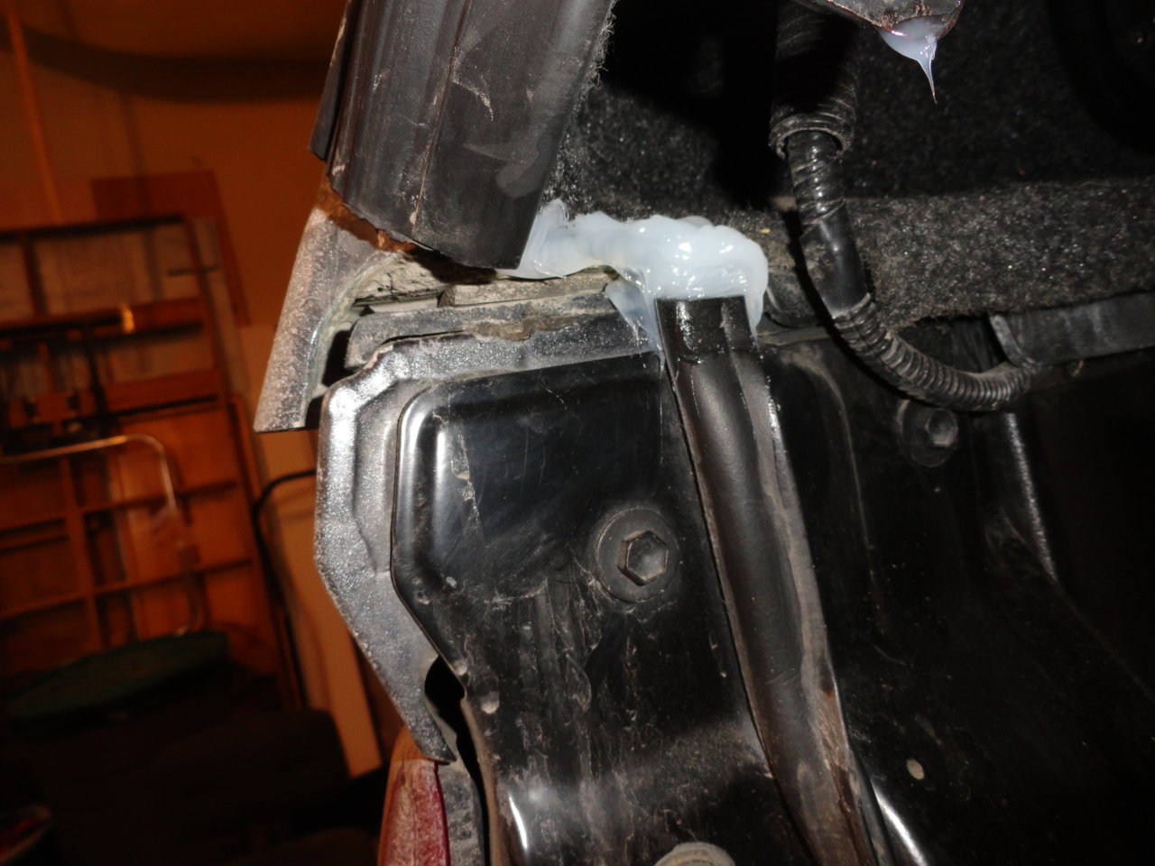

    I did a little more investigating on my (leaking) cap. I thought that the side windows were leaking because I could see water dripping down the sides of the bed. I actually took one of the windows out. Everything looked O.K. on the windows. I've concluded that water is entering at the bottom corners of the rear window and wicking along the carpet and eventually dripping down on the sides of the bed. I cut back the carpet (just like the O.P. had done) and made a silicone dam at the top of the tailgate weatherstrip (that I installed). Hopefully, the water will hit the dam and drip down the side of the tailgate instead of being wicked in along the carpet.

    Here are a couple of pictures in case anyone is interested. I cut the carpet that used to extend below the silicone in the picture that was picking up and wicking water that dripped down along the rear window weatherstrip. I attempted to seal the lower edge of the newly cut carpet and made a dam at the top of the tailgate weatherstrip.
    It hasn't been above freezing here since I did it so I don't know how well it will work but I'm optimistic.
