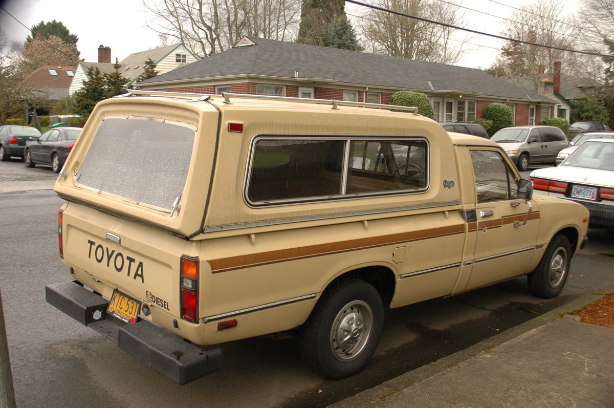

    For what it's worth, back in the old days, there was a shell company called Glasstite that made a shell that had a rear door that wrapped around the back of the shell and the tailgate which was probably very effective at keeping water out when closed as well as keeping the back of the bed and the tailgate dry when open. It seemed like a great design to me.
    Here is a random picture that I found on the web:
