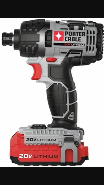

    All the rest can be done with 3/8. I have a 19 volt Porter Cable driver that I use for 90% of the work I do. I use 3/8 drive sockets with this tool. This impact driver is just short if amazing. I have 6 air driven impact wrenches that I haven't used in a year or more.
