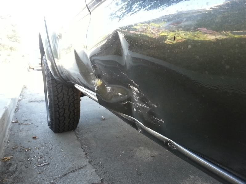

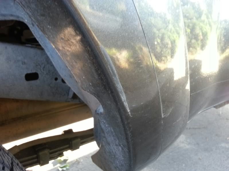

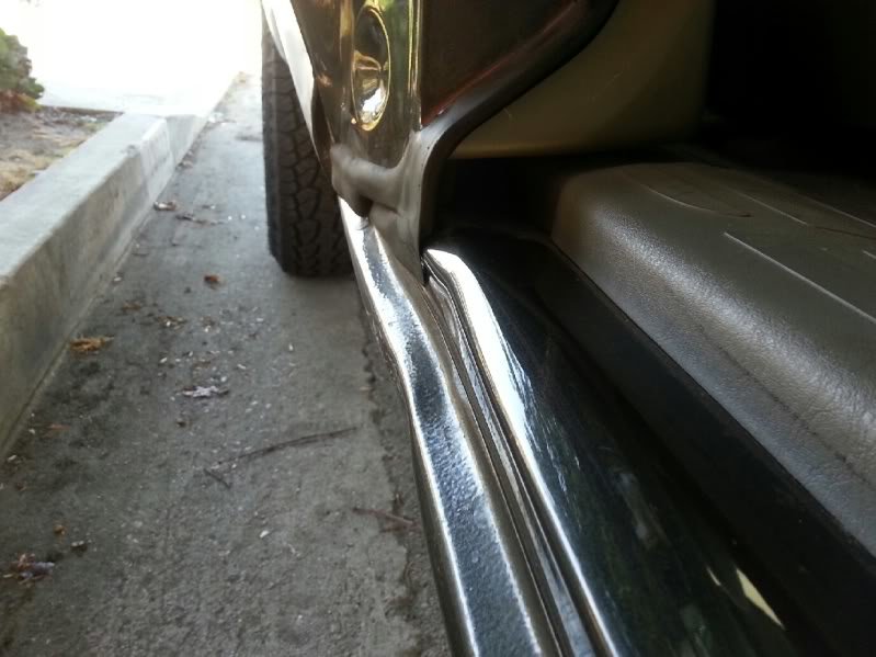

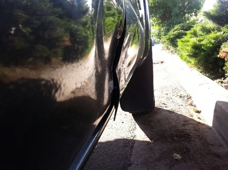

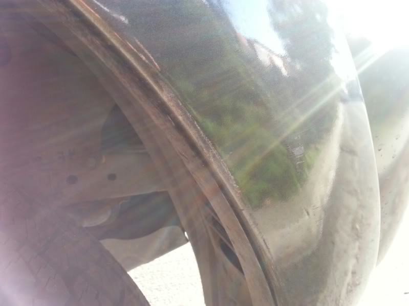

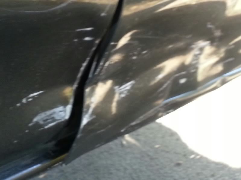

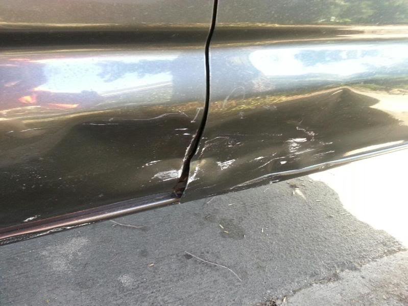

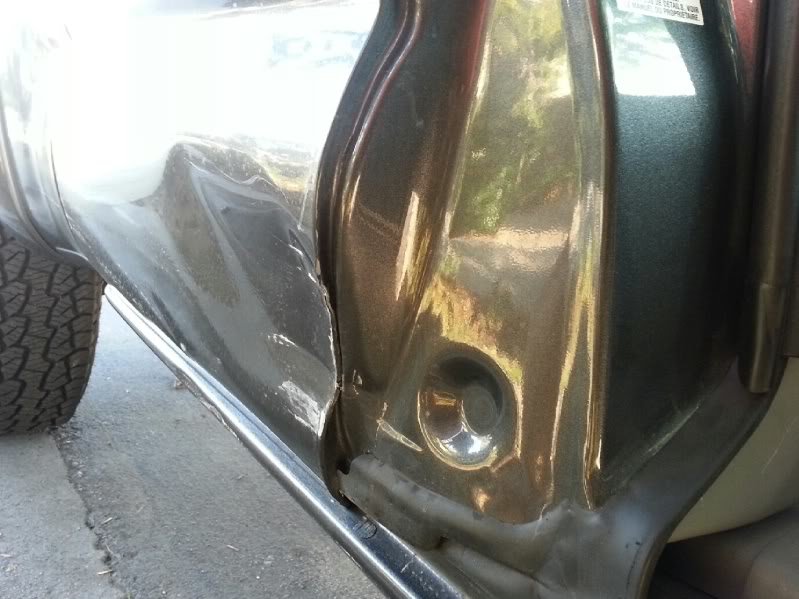

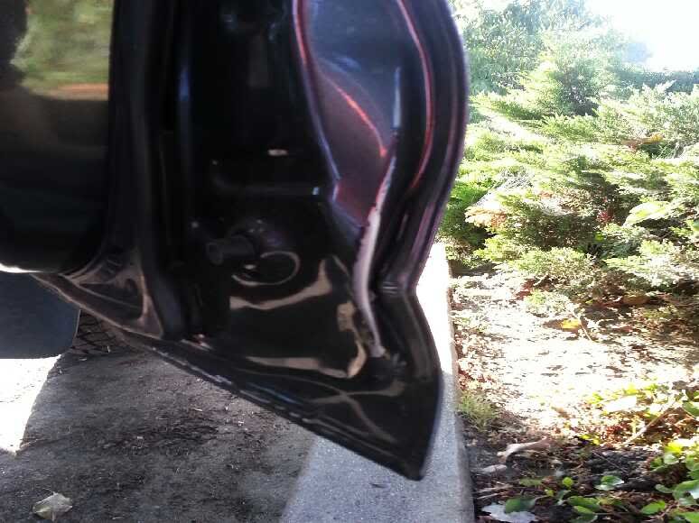

    The other morning I got hit on the passenger side of my truck. :( I have a few questions and I know this is the place for great advice and opinions.
    Is it better for me to go with an auto body shop that my insurance company has on their list or do I go with one that I find on my own? I did find one of the shops on their list on Yelp with a 5-star rating with 20+ reviews.
    I took some pictures so I could get some advice on what kind of work I should expect to get from a body shop, i.e. new doors, body filler -- which I really don't want -- etc.
    Any and all advice/opinions are gratefully appreciated.
    P.S. My wife and I are leaving in a few minutes to go to the range (she is getting her new guns today :D). So I will not be able to reply right away but will do so when we return.
    Thanks in advance
    Here are some photos

    Usually insurance companies has a list of "approved providers" that they will recommend. That does not mean that you have to use them. Check with your insurance people, but they should tell you you don't have to go off their list. From the pics it looks like that is not going to be a repair job, it is going to be a replacement! The door is done!! Ask a lot of questions and make sure they use OEM parts. Keep in mind too that the other insurance company is paying for it as the other driver caused the collision. As such you should have zero deductible.

    no way in hell would i let them use body filler! make sure you get them to quote replacing the rear bed side, pass. door, and front fender flare. when you bring you truck, tell them you want to see all the old parts to prove they did change them and not just blew smoke up your ass to make a buck.

    I can't really tell the amount of damage on the inside of the door from the picture (and I'm not a body guy, so take what I say with a grain of salt), but there is a possibility that they will just re-skin the door. If done properly, I don't see an issue with that. Basically they'll take the outside sheet metal off, and re-weld a new piece. I have a family friend who works at a body shop, apparently it is fairly common, and as good as replacing if the rest of the door is easily repaired.
    If you're concerned about filler, when you get the truck back, take a magnet and a thing cloth and slide them across the old area and the new area. If the magnet doesn't hold as well on the new area, then chances are there's bondo in there.

    They don't make aftermarket doors for his truck anyways, won't need to about that since oem is the only option! And it will need a door shell for sure, the inside of the door shell is crushed so a door skin isn't really an option here.

    Thanks everyone again for the great advice!!! I went to Rich and Famous and they did a fantastic job. I paid extra for some PDR work behind the rear left wheel-well and for them to fix some scrapes and repaint my front bumper and left front fender($380). The color matching was excellent!!! They even did a little extra touch up work here and there, no charge. I am very happy with the work they did and would recommend this place to anyone who is looking in SFV.
