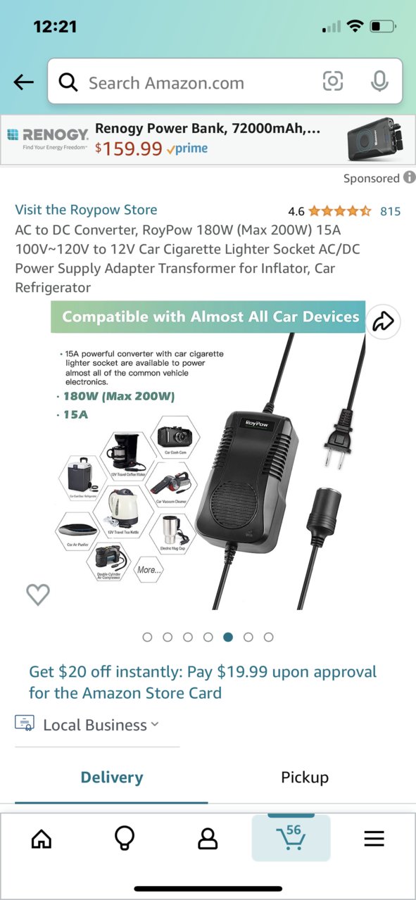

    Hey guys I also have a Ecoflow 1300 and trying to power my 5k diesel heater. Would buying this inverter (plugged into my Ecoflow) resolve my issue? I tried powering it up and it wouldn't. However a buddy has a Jackery 240 and it was able to power the diesel heater. I'm assuming cause the jackery was able to handle the 10amps where my Ecoflow wasn't upload_2023-6-13_12-23-46.png
