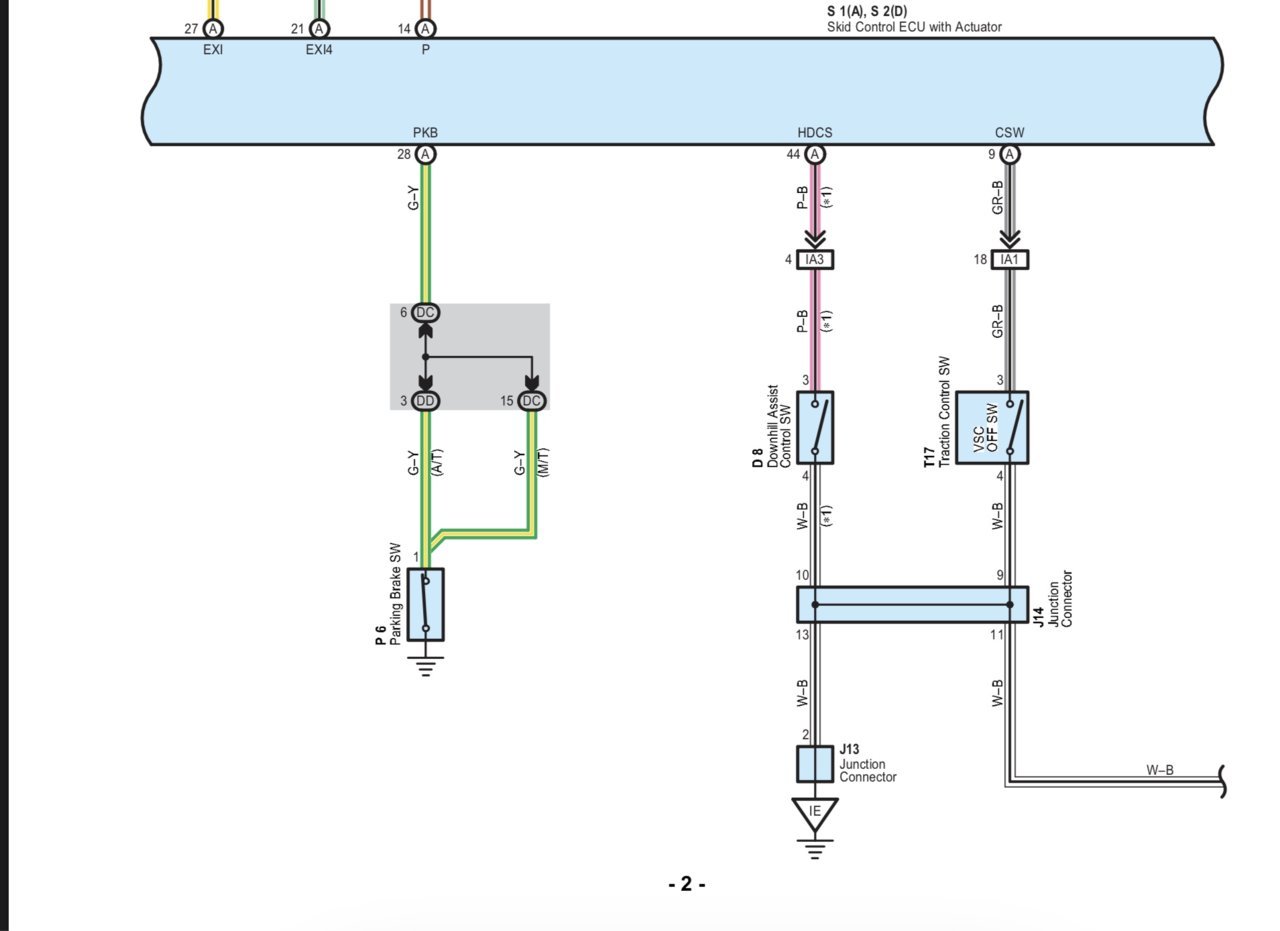

    FWIW, the VSC grounds to the Skid Control ECU.
    You don’t want to feed power to it for sure.

    Roger that. Fried computers are my least favorite fried thing.
    Understood. I think AirOnBoard's "OEM replacement" tagline signifies that they look identical to OEM, nothing more.
    Is a relay necessary to make the switch lighting work this way? How would one go about rigging up this relay? Is there a way to do it that won't drive me into the bottle at 9am?

    I mean no disrespect, but you are a long ways off from being ready to do creative wiring and cutting on the factory harness. You need to get a soldering iron, heat shrink, multimeter, and scrap wire. Practice soldering, read about how relays work and their purpose, learn the purpose and location of fuses and their rating relating to wire gauge, learn how to check voltage and resistance, and start with simple projects like wiring in a light bar with a proper fuse and relay. If you get stuck on wiring a simple project, ask and we'll help you along.

    Wire the 'b' contact of the relay to the switch LED.

    This wiring configuration will allow the switch to light up when the circuit is open? Do you have a @caribe makaira-style wiring diagram you could sketch up?
