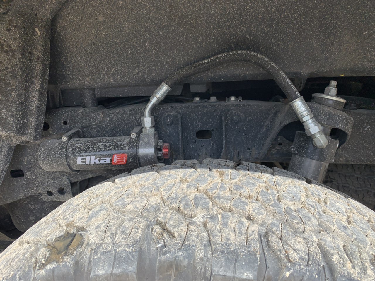

    The truck is fully stock except for the suspension. I had Elka 2.5 DC suspension, dobinsons leafs and SPC UCA installed in the spring to give a 2.5 inch, still running stock sized tires but have had a steering alignment done after the lift.
