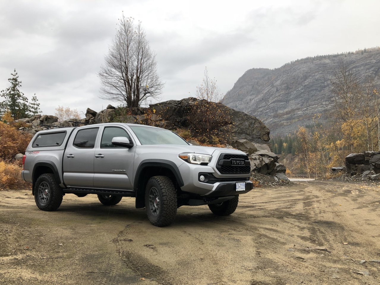

    A 3” lift will look goofy unless you go up to 33” tire IMHO. In some ways your lift is determined by what size of tire you want to run.
    I have a 1.5 lift in front and the same in the rear using Billstien 5100s and an add-a-leaf, with 31” c-rated kO2. I maintained the 1” factory rake because I don’t like the “stance” of a level Tacoma, especially if you load the bed with gear and it goes nose-high.
    This setup is perfect for the uses I have for my truck. I want to keep it lightweight and fuel efficient for long distance travel and good ride quality, without the negatives of larger/heavier tires.
    I don’t want to CMC, or blow through wheel bearings or regear to make up for lost power.....so as good as 33”s look, I’m out on those.
    jamesfishn09 and mgmdclb like this.

    Any photos of your setup?

    It’s nothing crazy, but it works for me.

    Looks great, this is exactly what I'm going for with my DCLB. I feel like maybe this might be more in line with what the original poster in looking achieve. Thanks for sharing.
