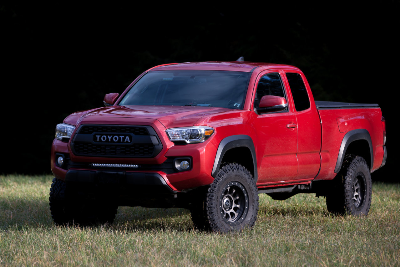

    I went with OME medium complete package because its all designed by one company .
    2016-Present Toyota Tacoma Old Man Emu Suspension Lift Kit - Medium Load 2" (OMETAC16MKSB)
    and there are great video's on youtube so I could install it myself.
    How to Install an OME Suspension Lift on 2017 Tacoma–Part 1
    How to Install an OME Suspension Lift on 2017 Tacoma–Part 2

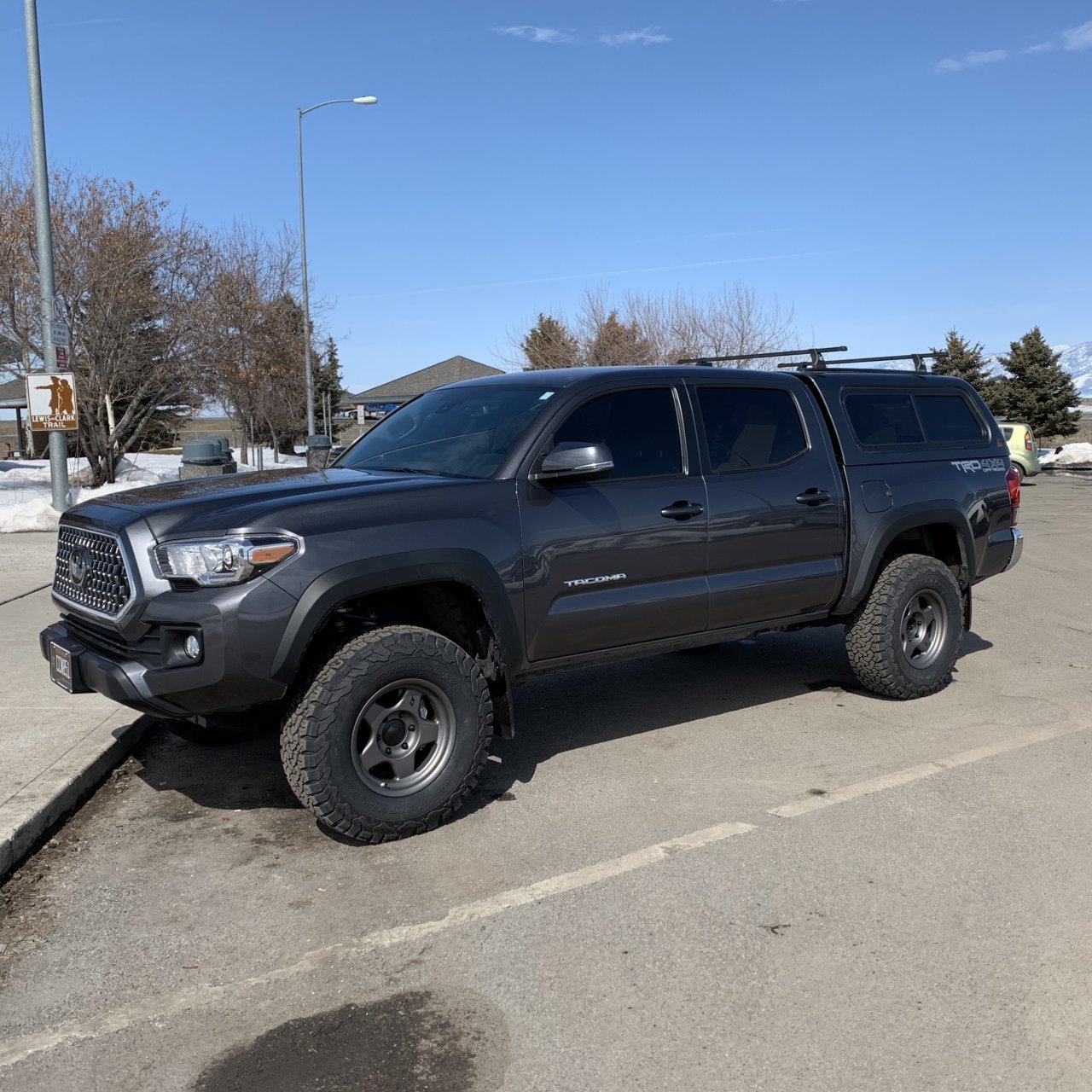

    Here’s a 2” lift sample on mine: OME BP-51 (set to 8mm in the front), SPC UCAs, 16x8 4.50 BS F5s, and 265/75r16 K02s.
    The bed is filled with the stock wheels, tires, and old suspension parts in this picture so the rake isn’t showing as much here.

    So you kept the rake and didnt level? I was thinking about that cuz from time to time I'll have stuff in my bed. Especially on our family trips to the mountains and I dont want to be riding with my nose up in the air.

    Agreed, I don’t like the nose up look in any situation so I kept the rake. It’s the full OME BP-51 kit which included front coil overs, and rear shocks and leaf springs.
