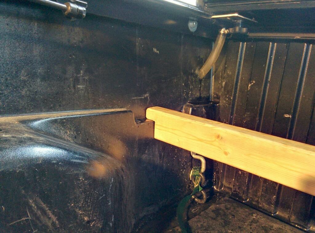

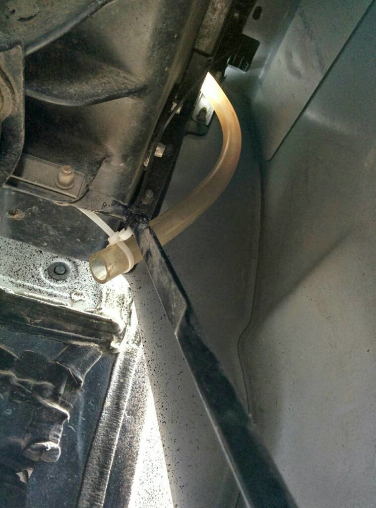

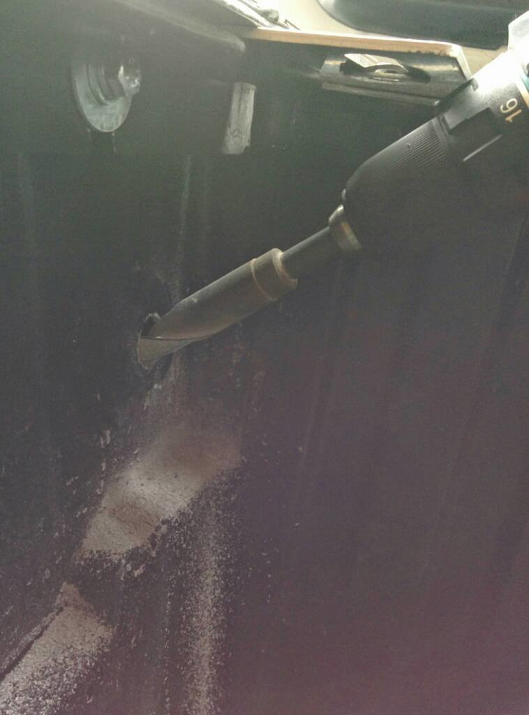

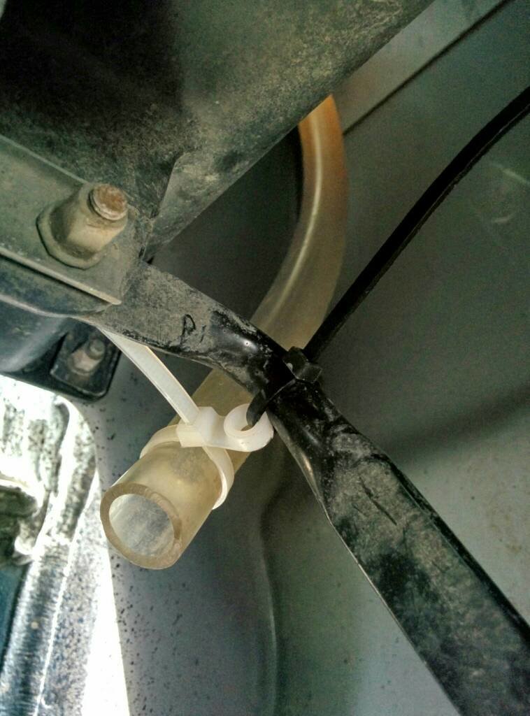

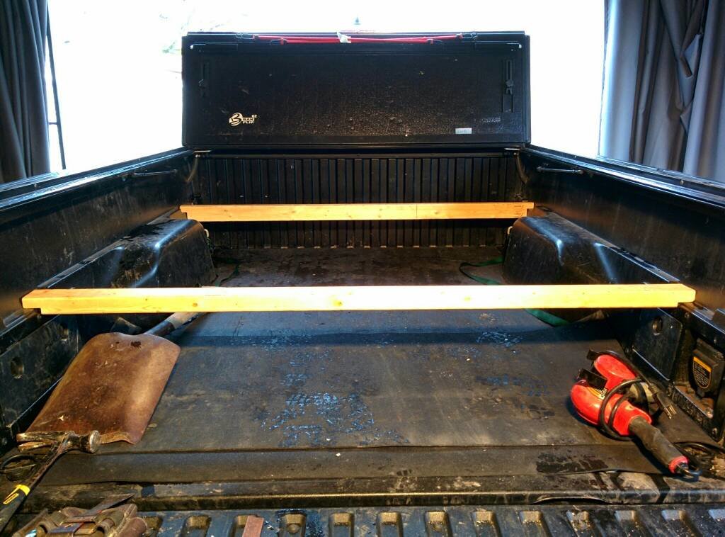

    I had the backflip G2 on the truck from the dealer, very pleased with it. I'm a carpenter so I like the protection to my rear window when fully opened.
    I've tucked the tubes away, only did it this weekend, I don't feel they where useful this winter though.
    But the part of the year that's not freezing, should work just fine.
    Here's a few pics, I'll tell ya later if drainage is a problem but there's no kink in the tube.

    Winter's pretty bad over here, the rubber seals good along the bed sides, keeps the flex rather then breaking witch I was afraid of but they held up fine for 2 winters now.
    If you leave the drain tubes hanging down, I find there pretty useless, draining the water in the bed. Instead of dripping of the end of the gutter, water as a slide to go on the bottom of the bed. I've seen some connect both to a T and out the center thru a hole in the floor, but I need that extra inch'ish in the bed, so I went for out the sides
