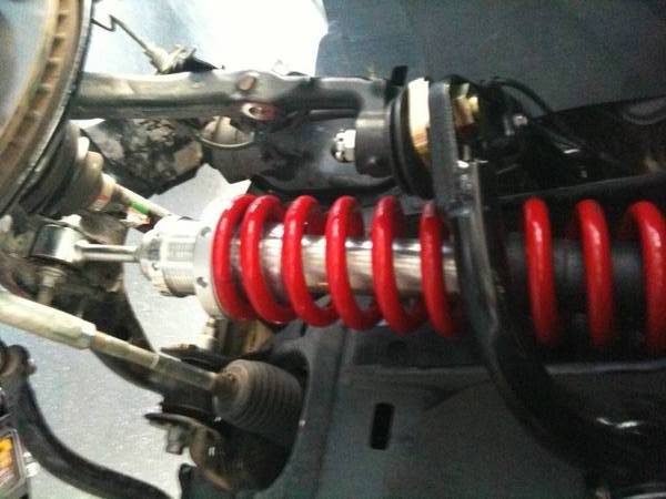

    That's a very popular kit on here.
    Do a quick search for "Toytec coilovers"
    Toytec sells that kit paired with 5100's, so they are definitely compatible. Just make sure you set the 5100's at zero.

    Since we are on the subject can someone educate me why those and billy 5100's are so much better then just the 5100's?

    there is no difference 5100's are the same shcok. Toytec just has a collar where you can adjust it, the shock is the same thing as any other company who uses 5100's they just might have added there own feature to it

    Sorry let me elaborate whats the point in new springs? Like what he posted? Are thye engineered better/differently then the stock ones? Give more height or what?

    coilovers give you the hight the shock help control the rebound of the coils.
    Instead of doing that spacer lift, many chose to replace the whole shock/coil cause you will get a better ride with new shocks. I have the toytec ULK and i just put it in, ride is very good much more absorbing than the spacer lift that was installed before.
    OP just buy the toytec kit you wont regret it
