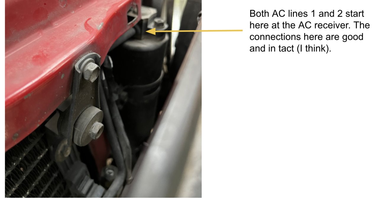

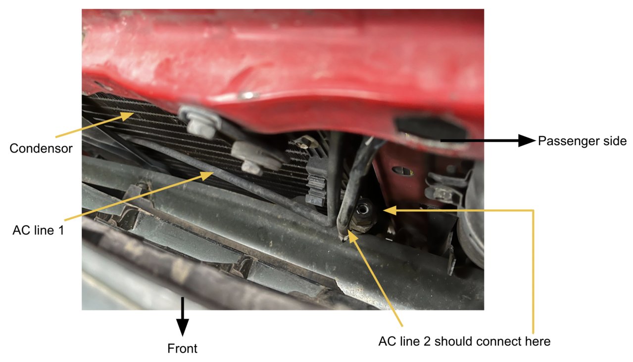

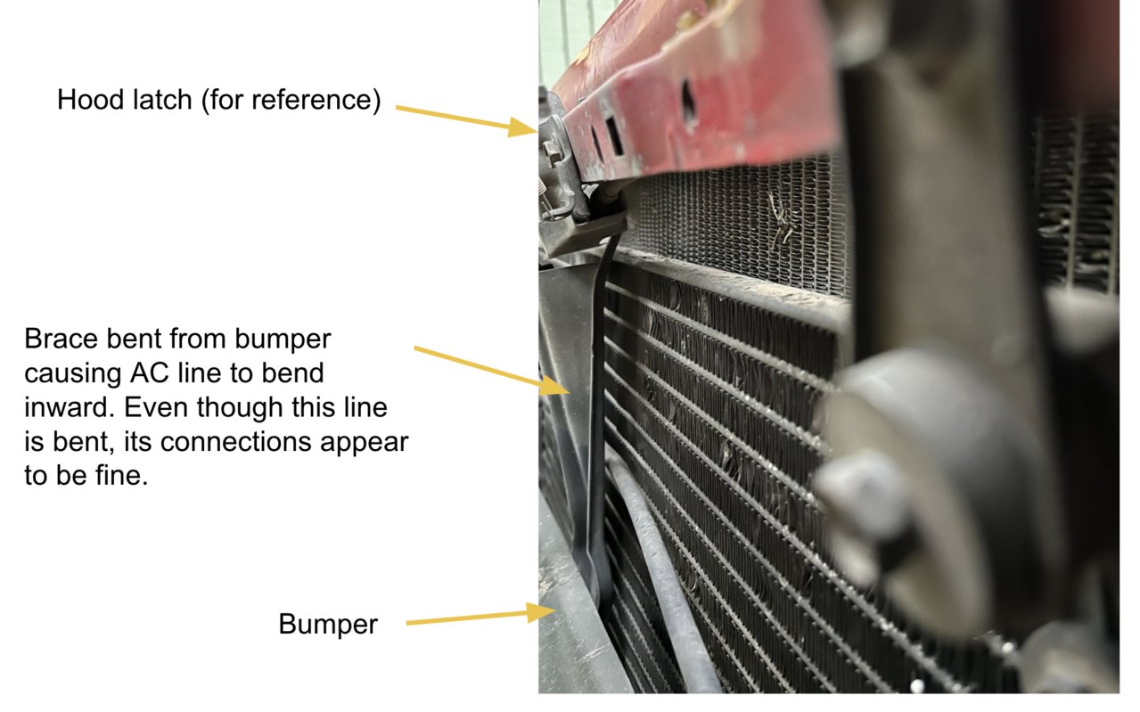

    I recently bought a 95 Tacoma. The previous owner had a minor collision on the front end, and it broke the AC. The collision caused the front bumper to bend the AC line that crosses the condenser to bend inward. It also caused another AC line running from the drier to become completely detached. See attached photos for more details.
    Supposing I can find replacements for the bent and broken AC pipes, is there anything else I should take into consideration? The AC system has been like this for 2 years at most, I think, if I go completely on the previous owner's word. Given the exposure, are there other parts of the AC system that I should replace/clean before/after I replace the lines and run new refrigerant?

    either way i guess. you really should get the accident straightened out at a body shop. then you'll probably need an a/c kit plus that 1 broken hose. i wouldn't re-use any old components as they haven't ran for a long time and are more than likely contaminated by outside air. the evaporator should be the only good thing out of this. you might need to replace the a/c pressure/cycling switches. i would 'cause it's a lot of labor to replace them since they would later have to drain the system, test it again, and refill. that's costly. these systems are supposed to be fully vacuumed and refilled with refrigerant/oil ONLY. outside air destroys the components on the inside. youre probably looking at a 3k fix total

    the truck will serve you for a very long time. if the only damage it has is in the pics, it would be worth straightening out early on in your ownership. i say fix it any way you can on the cheap. even if you have to pay a body guy on the side to use pry bars to straighten things out a little more.
    additionally, if you're going to have the a/c system replaced, you don't want the condensor to sit on a messed up body part. it might not fit properly and get damaged by something that is crooked.
    before i go any further i need to say this. a/c systems can ONLY be repaired by EPA certified mechanics. refrigerant is harmful to the environment so certs are required everywhere. they are the only ones that are allowed to have the machines that will evacuate the systems, test them for leaks, and then refill them with the correct amount of refrigerant. this is going to be costly on it's own. anyone else doing this saying they can do this on the cheap is full of shit. finding a friend or family member that is certified is your best option.
    Now to why you should replace all the components.
    1, you need to replace the drier in any case. it's purpose is to remove any moisture left over from the installation process. being opened to the elements for so long im 100% certain it's fully saturated with moisture and can not do it's job and will even release moisture in to the system if you have it all put back together the way it is. anything in the system that isn't refrigerant or lubricating oil is it's enemy. when you buy these new, they actually come vacuum sealed so they don't accumulate moisture while sitting on the shelf of an auto parts store.
    2, dust has traveled to the darkest recesses of the system which is where your expansion valve is. you can't clean those unless you take it out and clean it by hand. the labor to do this costs more than the part itself. not to mention there's a lot of labor just to get to this component to be able to take it out.
    3, moisture and dust has touched your compressor for too long so rust has built up and dust will cause micro scratches that will snowball in to bigger problems within minutes after putting lots of money in to get it all recharged.
    4, a little bit of dust has most likely gotten to the orifices of the switches and sensors. they'll most likely be contaminated.
    5, if you take your truck to a shop to have the a/c system recharged the way it is, the shop will not give you a warranty on their labor or materials. your system will fail either on the spot, after the repair, or within months. the shop will charge you full prices again for any further attempts to get it working. most shops will not warranty their labor unless you replace all of the components anyways
    again, anything in the system that isn't refrigerant or lubricating oil is it's enemy.
    your only option really is to have a shop replace the components and the hose. luckily there isn't TOO much to the system. compressor, drier, and expansion valve. 3 items plus 1 or 2 sensors/switches, the hose, and you might as well swap out the condenser since it was right there up front for the accident. rockauto sells a replacement kit for all this for about $250. buying this from a parts store will cost $300-$500. a mechanic will charge you around $800-$1000 for this kit plus the labor, oil, and refrigerant. you're looking at probably $1300-$1700 for the total parts, labor, and materials install.
