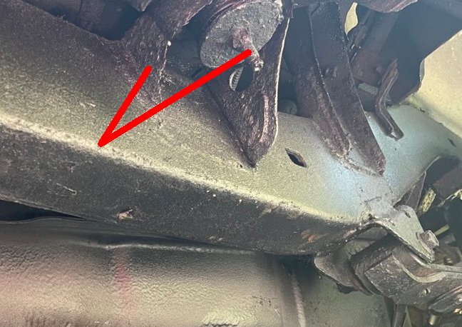

    Hello! I’m asking for some advice/feedback on a Tacoma I want to purchase. Went out and test drove it today and it felt great, shifted smoothly and handled well, I just have some concerns about the underside. I’m new to trucks and I can’t tell if the underside looks good or if it’s been coated with something to hide rust, and I’d like this truck to last me a while cause I’ve heard Tacomas are supposed to lol. Any advice or thoughts would be extremely helpful! I put a deposit on it earlier today and was going to pay for it tomorrow morning, it has 50k miles and a clean carfax report. Link to the original listing: https://www.carsforsale.com/vehicle/details/94200771#

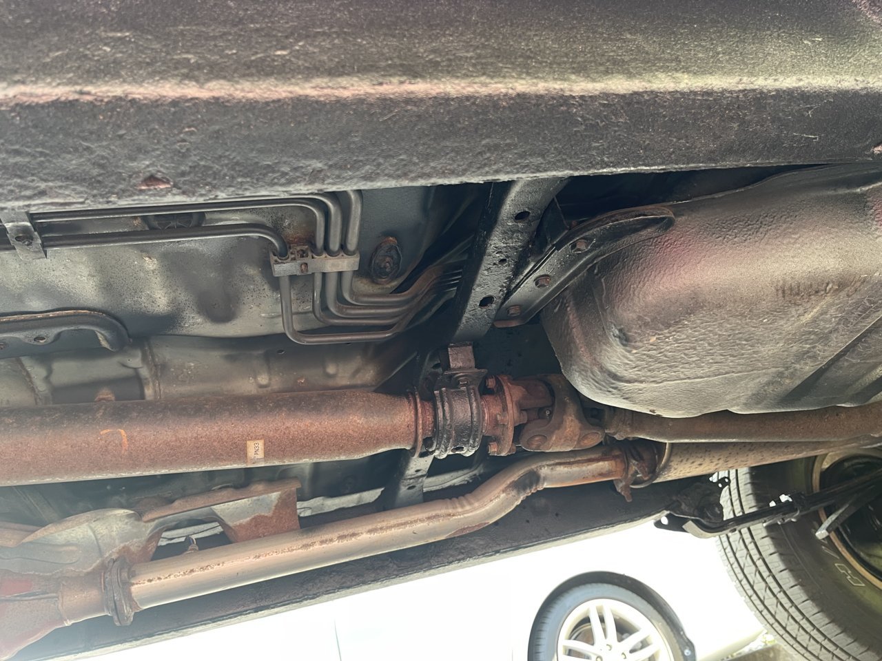

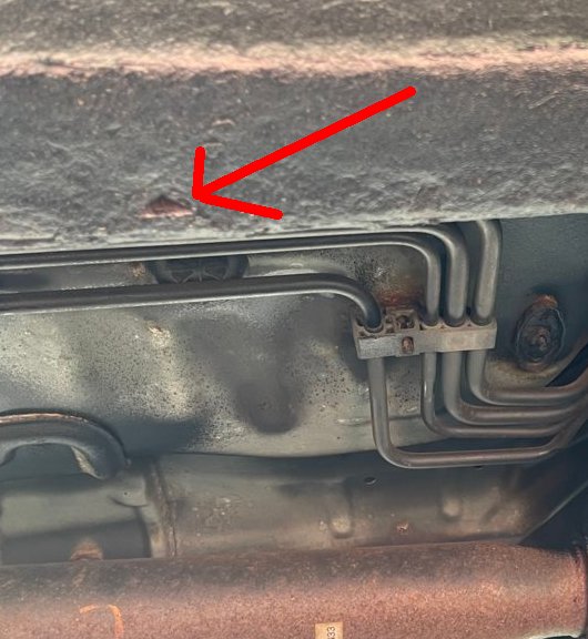

    I can't speak much on the rust, others will chime in, but it **looks like** it may have been fluid filmed or as you say painted to avert further corrosion. The rust on the tranny/driveshafts appears to be surface rust, minimal worries there (though they look like they may be "fun" to service/remove.) The problem with these is the box frame can rust from the inside out. The first thing I'd do is get under there with a hammer and tap around, starting with the spot I've arrowed in the first pic. It **may** be just flaking paint, hard to tell by a picture, the only way to know is to be there with a hammer.

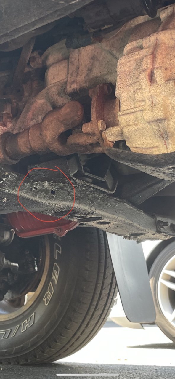

    I would also have a closer look at places like these body mounts.

    Thanks for the advice! How do I check the frame with a hammer? Just tap it and see if it goes through?

    Bingo, exactly what you do.

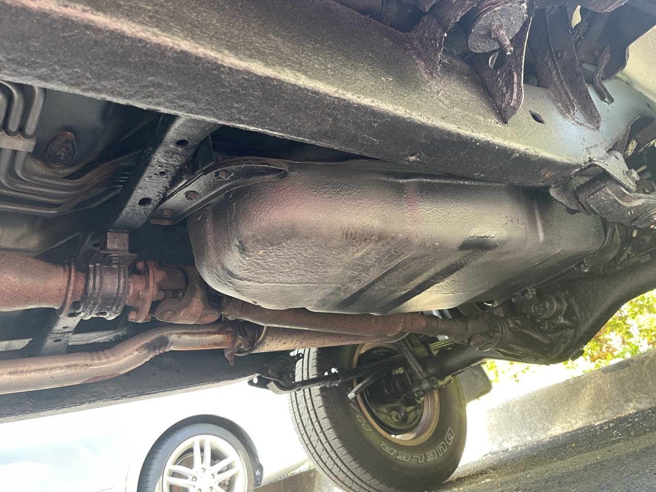

    Look at the fuel tank, its missing the skid plate and the forward strap hanger, all that rusted off in 50,000 miles ?......theres more to this story.

    To answer the OP, As others have said hammer test on the frame. Seems odd to me that underside of the body looks pristine but that one body mount is almost eaten away. I suspect all the crap applied to the frame covering up a similar condition. Damn shame because that is a beautiful truck.

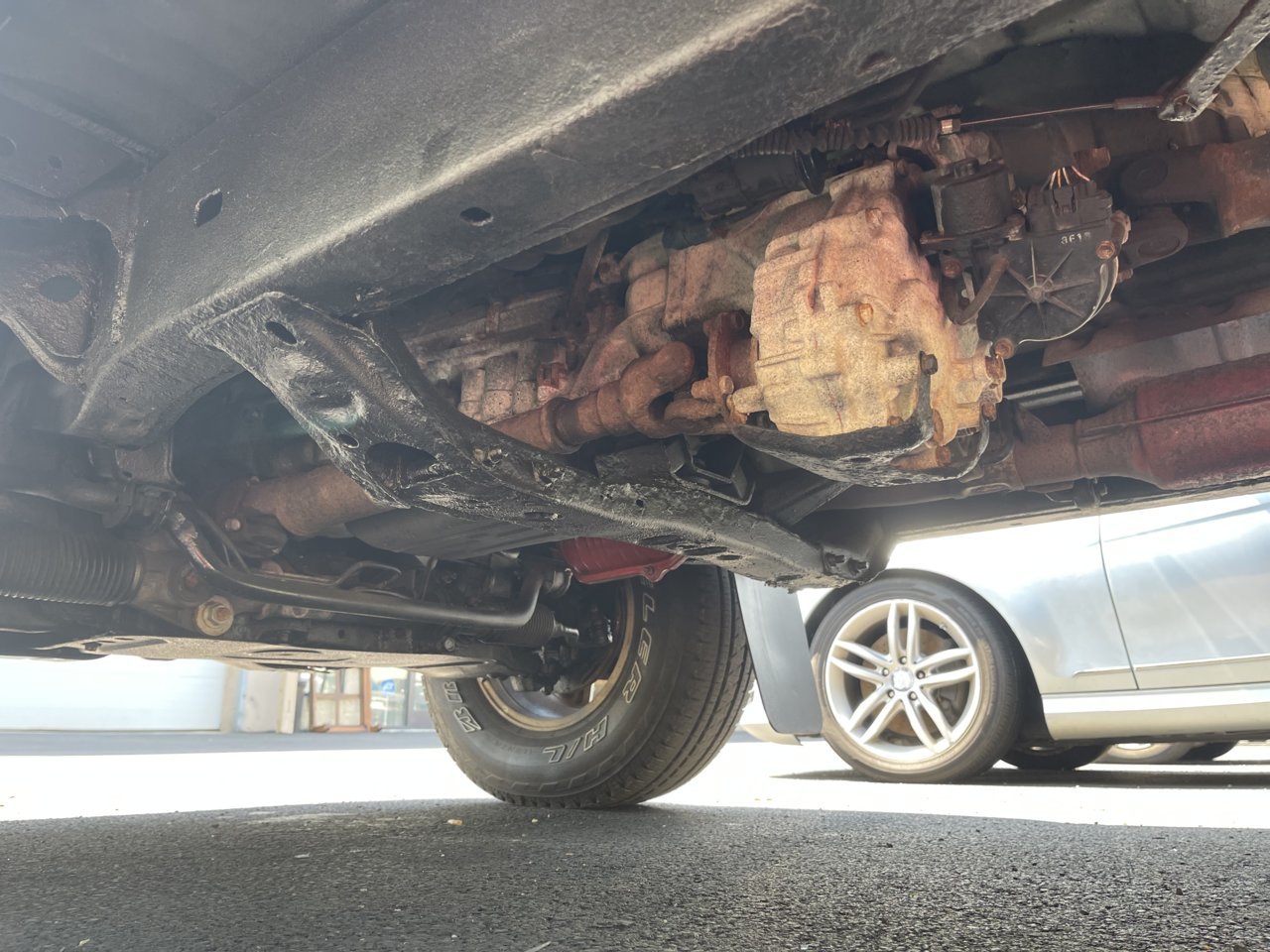

    Every photo of the frame looks like intentionally coated to hide the rust underneath.

    The part that gets me is why people miss the part where tons of components are covered in rust yet the frame is miraculously free from any of it IE painted/coated frame.
    Are people that oblivious?

    Coming from someone who bought probably the most rusted out taco on this side of the Mississippi on a whim, be careful and don't make the mistake I did. I had my rear leaf spring mount disintegrate and lodge up into the frame rail.
    Test with a ballpeen hammer, hit the very top of the frame rail where it should be the most solid (it was on mine), then compare the sound to the bottom corner. Even if you don't poke a hole through it, it could be very rusted and thin. Notice the bounce (more solid=more bounce) and sound change. Check around the sway bar brackets in the front and the rear around the leaf spring mounts.
