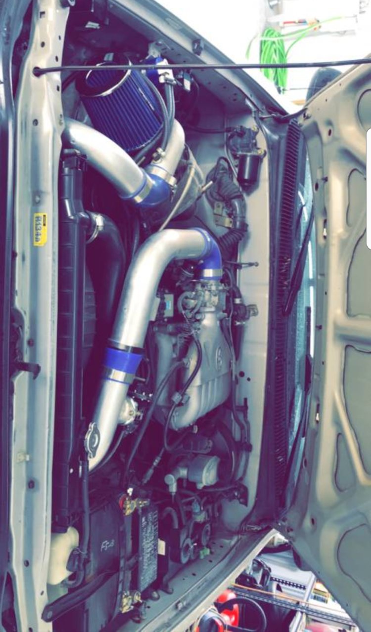

    I'd be worried about losing oil pressure - looks like it'll end up all in the driver's side. :rolleyes:
    Clean looking setup. @Brice and @j0shu4 have turbo'd 3.4's. They may be able to help more than my pointless comment lol
