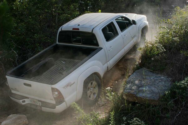

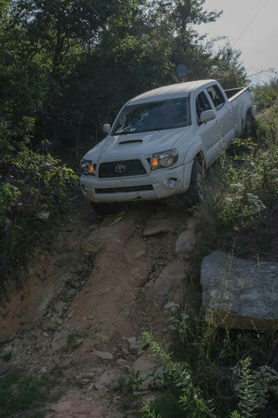

    2011 dclb sport 4x4, no issues track control is pretty awesome. Here's a few pic's. bcf4e27102e46bd8acd90af0036e70ca_a047bfbe31e33fa0939d1b3a8593461812de30f6.jpg
    Not much else to say.
