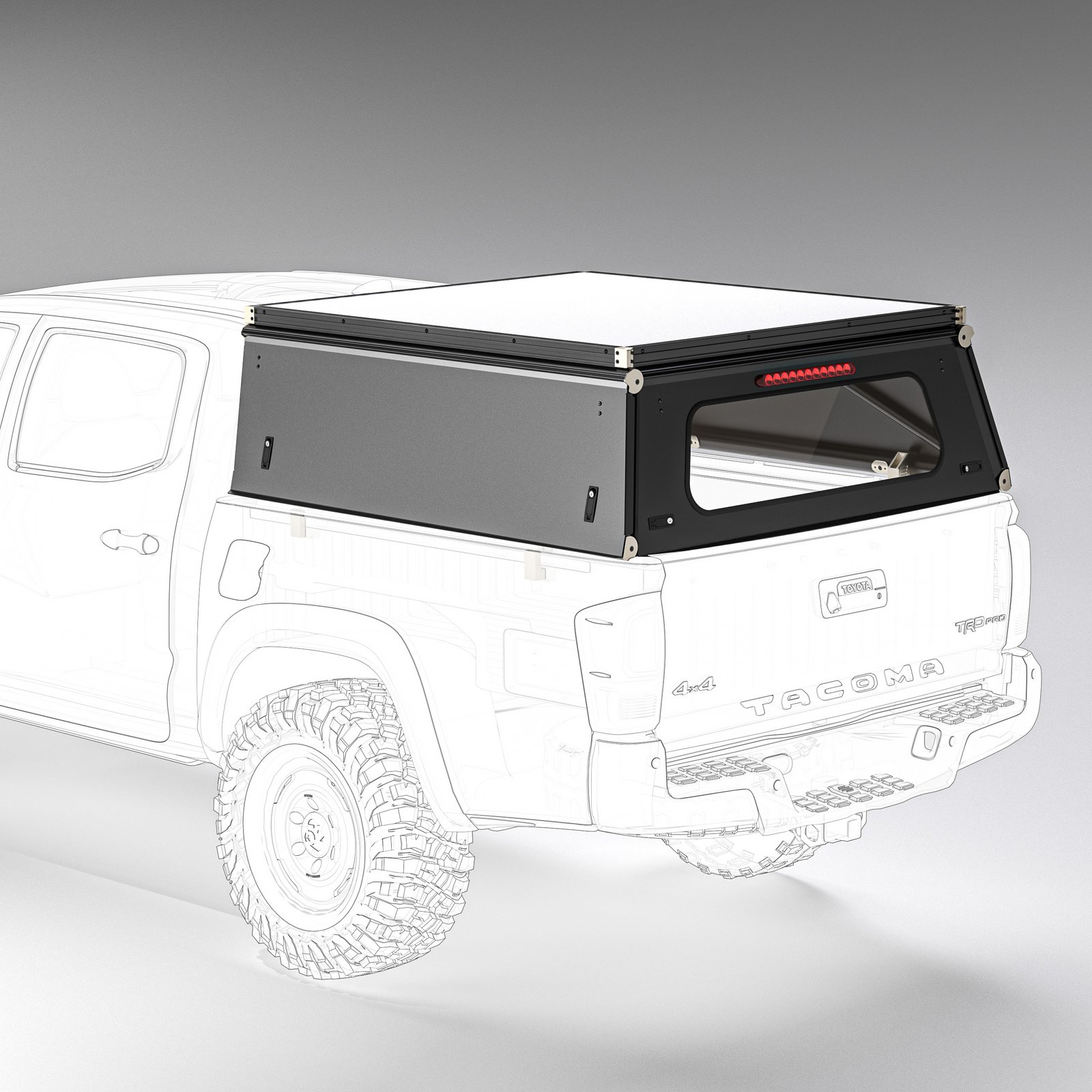

    I'm planning out a DIY camper shell build modeled after the GFC Topper and need to figure out what angles to use for the walls. I was thinking having an 8° forward lean in the front and 15° forward lean in the back, and lean in 15° for the sides.
    Does something like that sound reasonable? Do y'all think it would look good?
    AustinMada likes this.

    Ripcord uses steeper angles for the space frame IIRC, around 5° forward (both in the front and back) and 12° inwards. I think that makes sense when strength is a priority since it's holding up a fairly heavy RTT permanently. I'm not going to have an RTT so I'm hoping to sacrifice a bit of strength in exchange for aerodynamics and a less boxy appearance.

    I would think making them the same as the side of the cab. If they stick out past the sides, the possibility of them making some sort of wind noise would be my concern. Use the level app on your phone and see what degree the cab is.

    I did mine about 13 degrees inward and forward on all sides. matches the truck almost perfectly.
