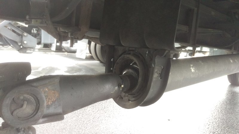

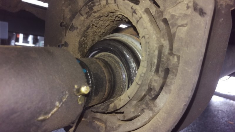

    Speaking of drivelines...
    Don't forget to check play in your carrier bearing...
    This truck was from Sacramento and on its way to Arizona before I stopped the guy in our yard...:boom:
    Rambo54 likes this.
