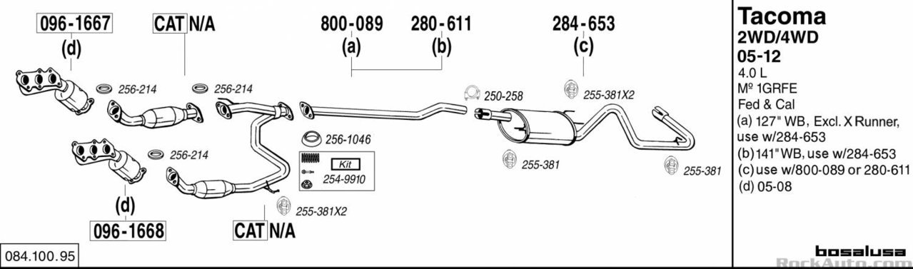

    I didn't put my vehicle in the website, I just ordered it. I did this because the Rock Auto website shows a diagram of the exhaust. I have attached. It shows how the difference in the wheelbase is made up using their exhaust parts. I don't really care, I am cutting my stock exhaust with a sawzall and sliding the bosal exhaust over my stock pipe and securing with a clamp. I suggest you do the same and get it welded later.

    So it's not actually bolt on. What you have to do is measure your old one, cut the pipe after the last gasket and bolts with springs on them, and weld that. It's made so it's universal. My shop just mounted up my new one, measured the distance, and cut the old pipe so they could weld the new one to it. Its only one weld though.
    EDIT: I saw in your other post that you're cutting it and clamping it so that works too
