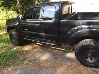

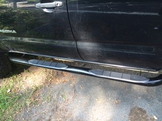

    For the folks who helped me think through how to solve this problem I wanted to offer an update. There was some really good advice here and it definitely helped. Call me old fashioned but I think when someone offers you advice you owe it to them and the community to provide a wrap up.
    First, great advice and great help. What a community of nice folks trying to help people solve problems and reach their goals. Thank you.
    So what I did was this:
    > I confirmed the size of the bolts that go into the Tacoma body (not the frame) for the step rails. I searched online and here and there were a number of folks who were given free step boards with no bolts so that info was readily available. So I confirmed the size of the bolts.
    > Went to the auto parts store and used the bolt selector to determine that the bolts that came with the Ionic step bars were in fact the right size. The good news is that they were -- so the bolts were a match.
    > I then bought a wire brush and really cleaned out the holes after removing the plastic screw type plugs. I made the mistake of thinking that since the screw plugs were in those holes there wasn't any rust or debris in there. Boy was I wrong! After a while of cleaning the holes were in good shape.
    > Then based on excellent feedback here I put some anti-seize lubricant in the holes -- a fair amount. That really did the trick.
    > I slowly inserted the bolts and got them to thread -- some went in easy and some went in tight but they went in.
    > One thing I did learn is that the part of the truck you screw into is not a flat surface. You have to angle each bolt to match the contour of the truck bed. That also helped a lot.
    > Everything else went in perfect and the steps were on in about 20 minutes.
    A few final thoughts and comments for folks here or any other amateur / newbie dealing with this stuff:
    1) The Ionic step bars are okay. The price is $123 for the pair. The quality is fine but they are not heavy and don't feel substantial. I think they will serve my purpose as a step in. If we decide to upgrade to more rugged or substantial sliders I will definitely come here for advice.
    2) Pretty easy one person job -- as these are not that heavy.
    3) Small victory! Folks here could probably do this in their sleep but for us newbies there was definitely a sense of accomplishment.
    4) I look forward to more projects -- some within my skill set and some that expand it.
    Pictures to follow.
    Thanks everyone who gave freely their insight and advice.

  14. Sep 4, 2016 at 1:01 PM
    #34
    averagejp
    averagejp [OP] Well-Known Member
    Aug 8, 2016
    #194056
    1,443
    2005 Black Tacoma Extended Cab
    Work in progress
    As promised. Here are pics.
    Duck_Hunter, 03f5sp and Fitz235 like this.
