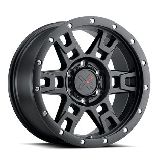

    @TacoJack69 welcome to the forum, a good wheel and tire set up would be a 17X8.5 6-139.7 +10mm offset DX4 Terrain with a 265/65R17 A/T tire. No mods needed but you achieve the rugged look I think you want. Send us a DM if you would like more information.

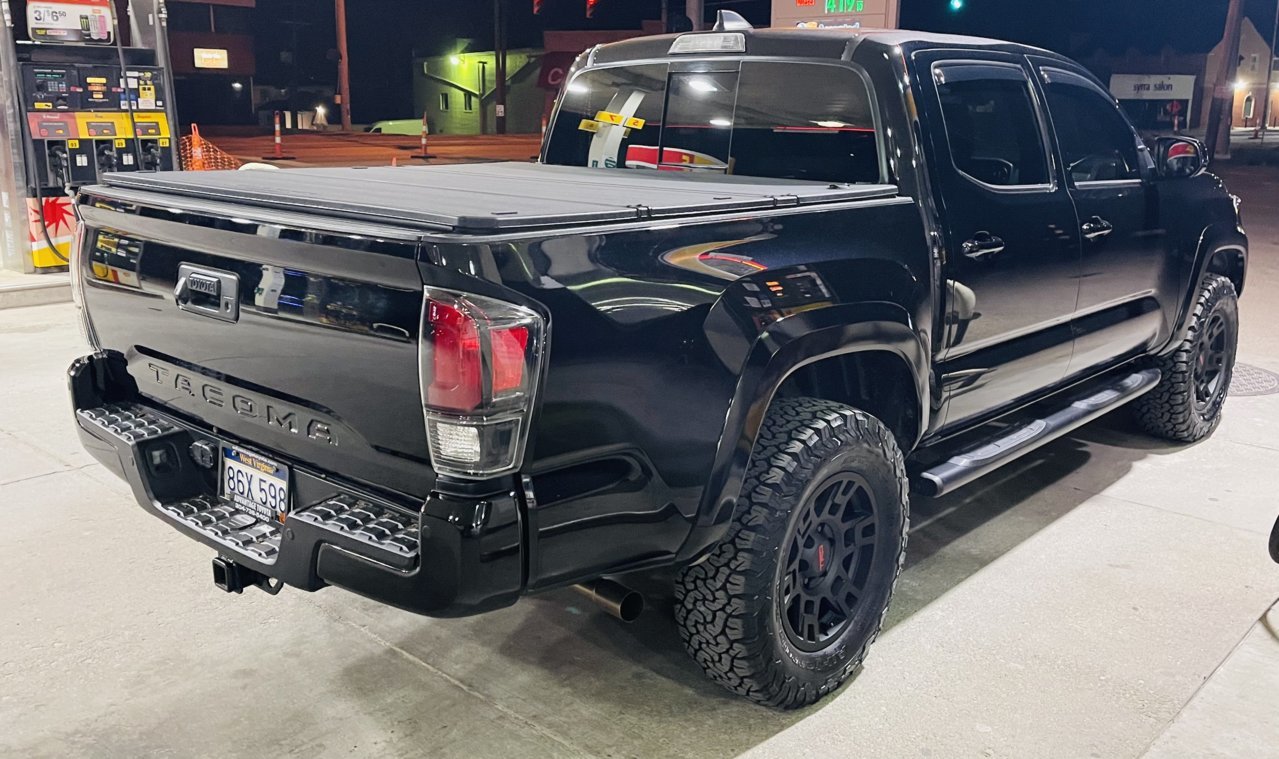

    0FCB3937-F616-4981-A1F4-D4F601ABB684.jpg No lift and no rub. 265/70/17 OEM TRD PRO wheels
