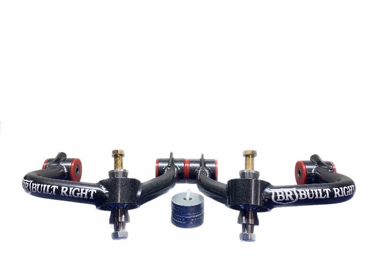

    I was looking at this cant spend lots of cash right now . Is a bender from here having black friday sale
    what u fellas think
    shes really a city queen rig

    I'm running 881's on 5100's now on 2 nd notch not stiff but firm .
    I ask on the spacer cuz if you see my pictures a have them on now should i take then off or just add UCA's my front end is higher right now .
    thanks for the reply

    If it were me, I'd ditch the spacers get different springs that'll give you the lift height you want. 883s will give about 3", 882s about 2.5". Adjusting the settings on the 5100s is what stiffens the ride along with using spacers
    In the mean time though you're fine to just put the UCAs on until you change the lift. With that much lift on stock UCAs I can imagine your alignment numbers aren't ideal

    Ok ima pull the trigger on the jba uca's put then on for now .
    In the future i want a full ome lift kit o_O
