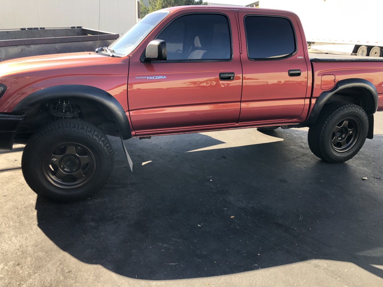

  3. Nov 23, 2019 at 10:34 AM
    #43
    taco03Trd
    taco03Trd [OP] 03 rig trd v6
    Sep 29, 2016
    #198568
    1,154
    Carlos
    Riverside ca
    03 DC prerunner trd v6 2wd
    Ome 881 5100's jba's looking for more
  4. Nov 23, 2019 at 10:47 AM
    #44
    eon_blue
    Mar 4, 2016
    #180213
    69,810
    Azusa, CA
    Yeah that is a lot of lift for stock ucas...no wonder your tires are wearing weird. The JBAs will help a lot.
    Kolter45 and Ritchie like this.

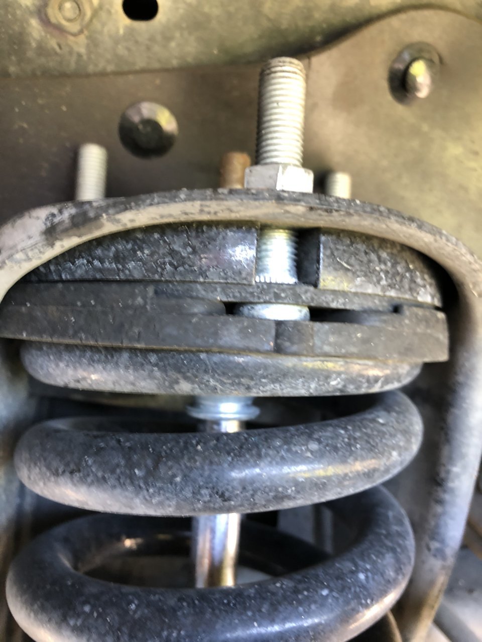

  8. Nov 23, 2019 at 12:03 PM
    #48
    eon_blue
    Mar 4, 2016
    #180213
    69,810
    Azusa, CA
    I don't think you need to take them out until you get a better lift to put in its place...unless you're talking about doing it in the meantime to avoid more wear on your tires? It might rub it might not...hard to say. How much lift do the spacers give you? They don't look very big in the photos. I think having the 5100s on the 2nd notch is probably the main source of your stiff ride and height over the 2" the 881s provide

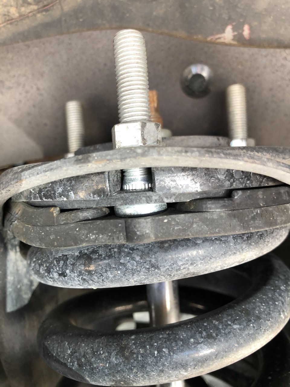

  9. Nov 23, 2019 at 12:10 PM
    #49
    taco03Trd
    Sep 29, 2016
    #198568
    1,154
    Carlos
    Riverside ca
    6B747CDB-2B5D-44C6-B536-5A04A2449684.jpg D88213D4-AE4E-42B5-BA42-687ED39BF4CE.jpg Cant remember how much lift i got but i think it was 1 inch .
    The ride is firm not stiff IMO
    driver side is bigger for the taco lean

  17. Nov 27, 2019 at 10:30 AM
    #57
    eon_blue
    Mar 4, 2016
    #180213
    69,810
    Azusa, CA
    yeah you will definitely want a different size spacer for taco lean...a 1/2" spacer giving 1" lift will be way too much unless you have some really abnormally bad lean on that side. Usually a 10mm spacer is used, or a 1/4" if necessary
