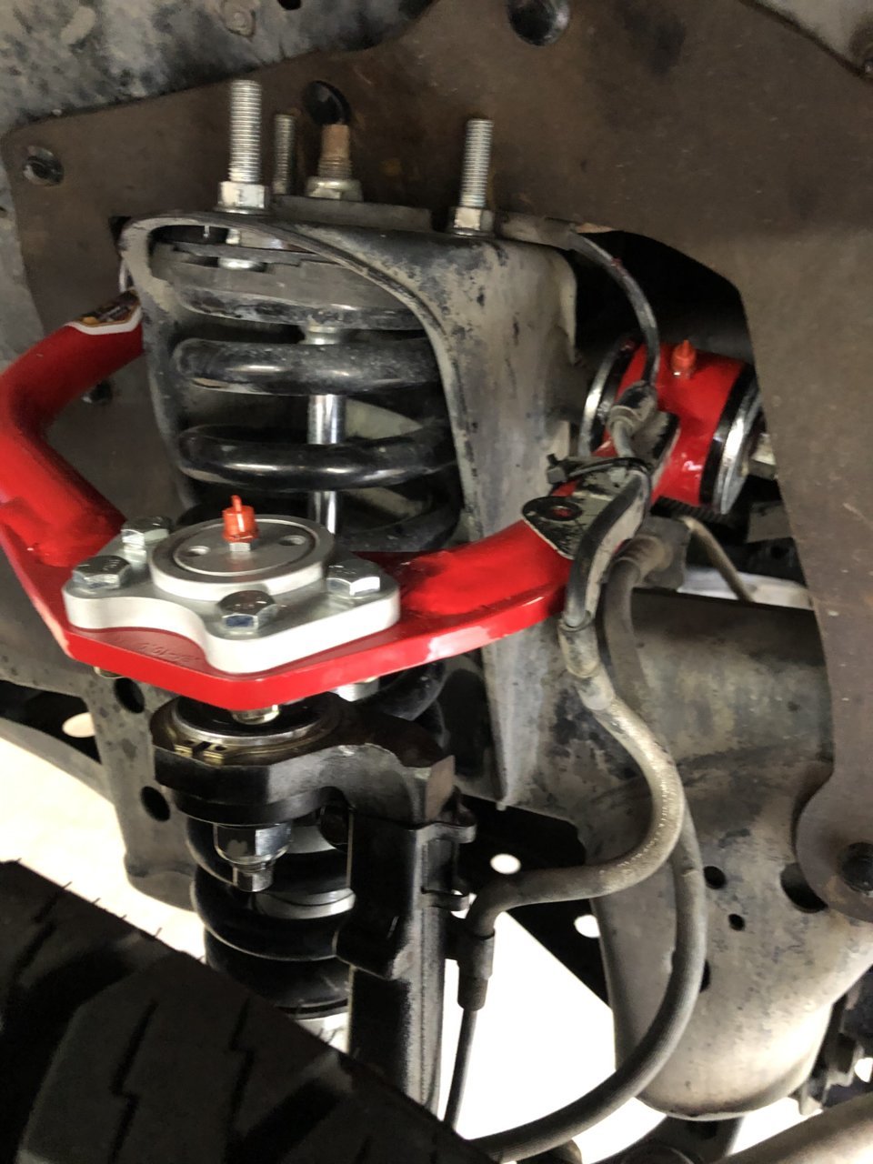

  14. Dec 29, 2019 at 7:05 PM
    #74
    taco03Trd
    taco03Trd [OP] 03 rig trd v6
    Sep 29, 2016
    #198568
    1,154
    Carlos
    Riverside ca
    03 DC prerunner trd v6 2wd
    Ome 881 5100's jba's looking for more
    204F3E1F-6618-46ED-B8D9-07D219948E1C.jpg BD399312-D9B9-4DE6-BBDE-42388725E321.jpg
    So finally install this babys on .
    Big thanks to
    @whatstcp for the help this morning great guy met on TW . Can wait to do more stuff together .
    @eon_blue for the advice on this topic
    thanks guys again :thumbsup:

    @eon_blue
    @whatstcp
    Going to alignment shop today any special number i should be looking for ? Or just wait an see how it comes out
    With the new UCA'S i can feel big difference already aim sure with the right specs would be a dream drive .
    Please let me know
    Thanks in advance again lol
    whatstcp likes this.
  18. Jan 4, 2020 at 10:34 AM
    #78
    eon_blue
    Mar 4, 2016
    #180213
    69,810
    Azusa, CA
    Well the JBAs have some positive caster built into them so you should have some already just by installing them
    What size tires do you have? I recommend aiming for 3° caster on these trucks to avoid pinch weld rubbing with larger tires.
    Camber and toe you just want to be even and at or close to 0
