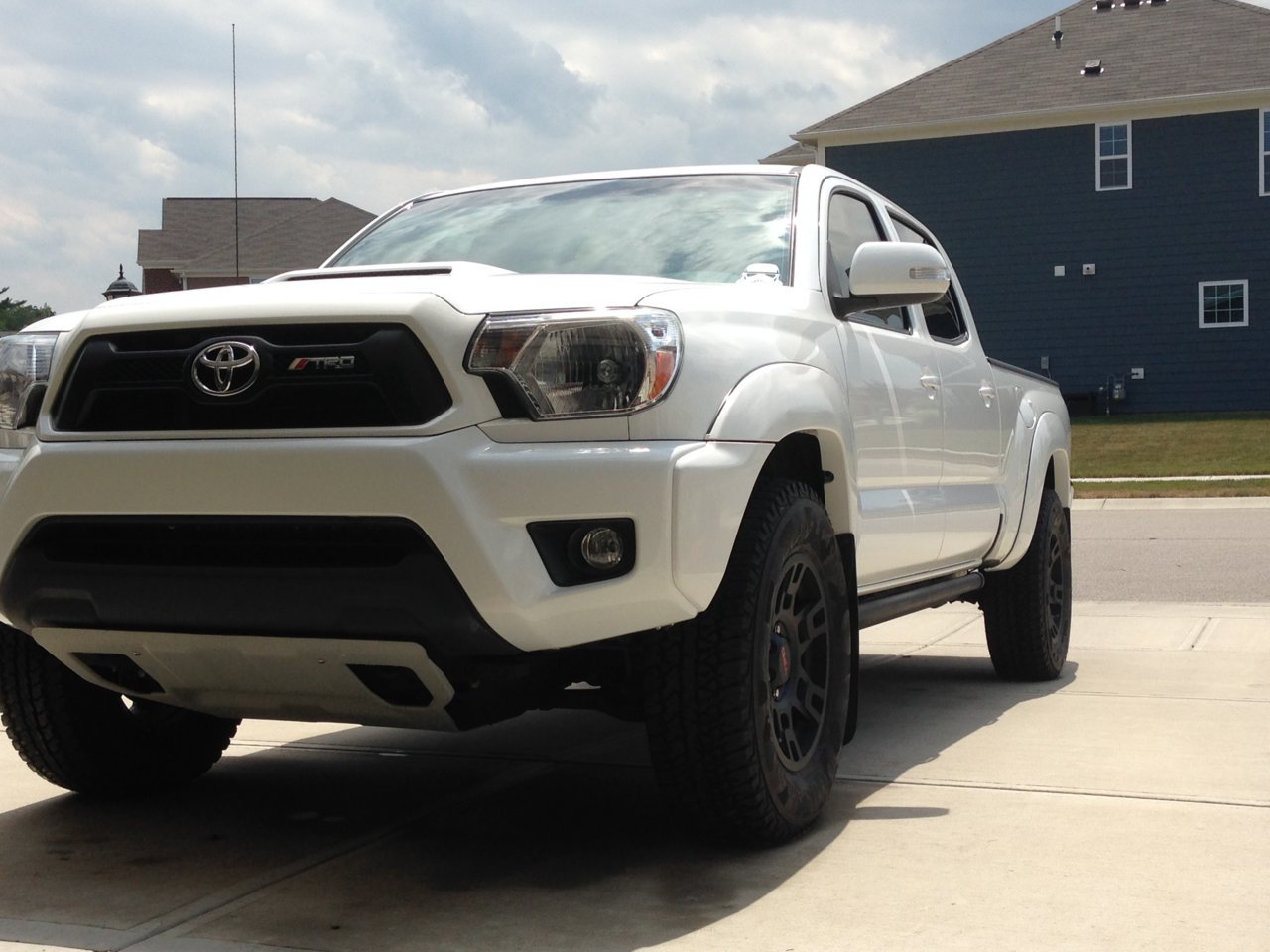

    I painted mine. I just sanded the chrome down pretty darn good, then used adhesion promotor, and primed, painted and cleared. Came out pretty damn good. That was almost a year ago, and it's holding up well.

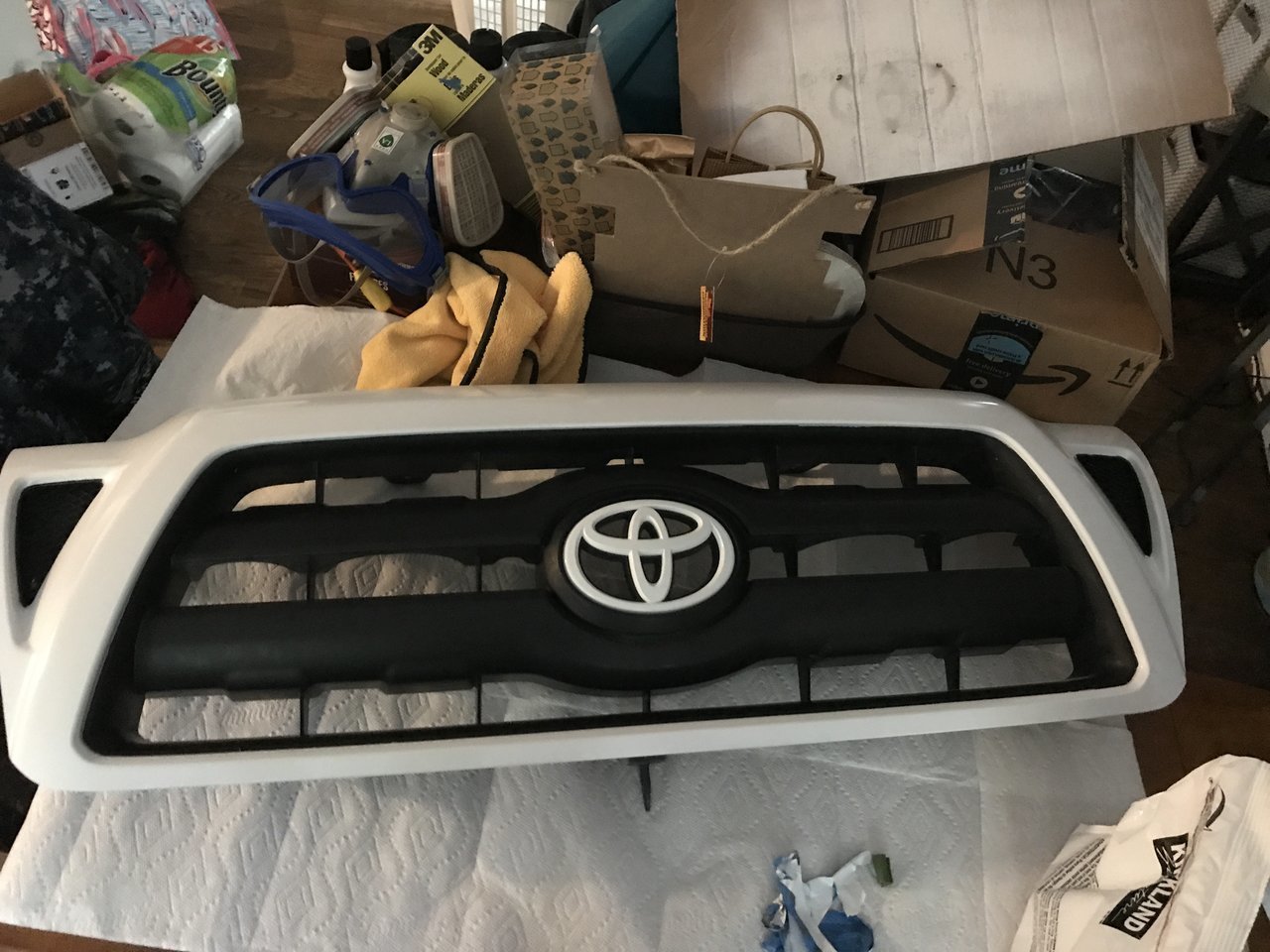

    Just wanted to share some of my input. You can buy the paint from an online vendor called automotive touch up.
    I would sand and primer (adhesion promoter is for flexy plastic parts like bumpers and assists in flexing, where the grill does not need adhesion promoter), flash dry and paint two base color coats. After about 30-45 minutes, use 2 PART CLEARCOAT ( Spraymax 2k ). The clearcoat is what will make the entire job stand out. Ive never used a more resilient clearcoat. I painted a myriad of bumpers in the last few years and spraymax 2k resists all rock chips, petroleum and gas chemicals. Not to mention it really makes your base coat pop. Don't waste time with plastidip or vinyl wrap, where you will have to redo it after a few months. Spend some extra time to do the job correctly and you wont ever have to go back to repaint.
