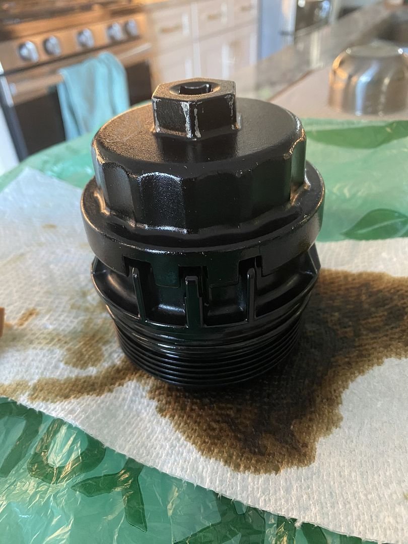

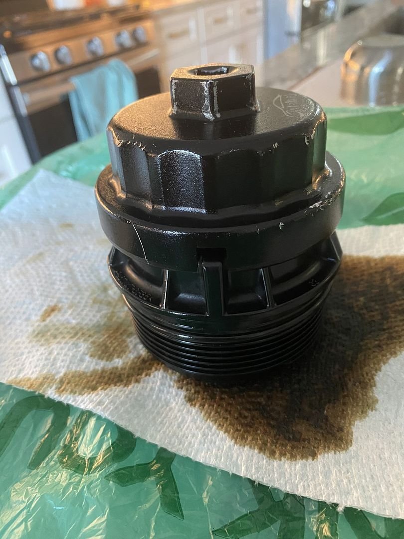

    Onto the investigation of the broken cap.
    The housing removal wrench should not make contact with the winglets. Photo below is from this weekend...I still have the plastic filter housing and the wrench for fit check.
    The bottom portion of the housing (with the ridges on top in this photo) is what makes the most contact. Not sure how the winglets are getting broken off because they shouldn't make contact with the wrench.
    Here's the other side. The notches should match up on both sides.
