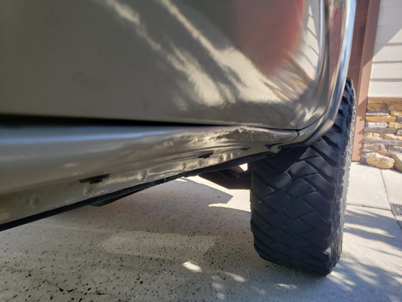

    Hey y'all,
    looking for advice on how to repair my dented passenger side rocker panel. Got hung up on a rock pulling a fellow taco out and bend it pretty bad. Already took a paint pen to it so it doesn't rust but I want to pull the dent out without having to replace the whole thing. Door still opens just fine thankfully. Does need to be perfect as I'm going to blast it with raptor bedliner afterwards but I want to get rid of the dent as much as possible.
    Thanks in advance.

    Thats going to be a hard one to do without a body shop visit. There is no place to push from the back side to get the dent out, and its too structural to pull from the outside without welding tabs on (what a body shop will do)
    If your not too concerned about how it looks, I would take a hammer and pound down the top of it so its not so close to the door, then hit it with bed liner and hope it being black hides it well.

    Its too strong of a place for the glue on ones. I have the same thing and it usually only works well on large open body panels (rood, hood, doors).

    Dude. Glue on tabs will pull off. With that dent, probably weld on tabs will tear the metal.
    Get black, not tan bedliner and paint it. Then mount a set of sliders. THis will cost less than fixing that dent. I hated fixing those things.

    You can try, but it wont do much. I went to school as a body tech and worked in the industry for a few years before moving to a new career. Weld on tabs, or a stud gun. But your going to mangle the panel pretty good and will need filler and more welding to make it right.

    Yeah the glue thing just doesnt have the sticking power needed to pull that out. Remember, it took the weight of the truck to make that dent, its going to take the weight of the truck to pull it back out.

    Take it to a body shop tell them your plan. have them rough it out, and coat it with the bedliner or whatever your plan is. estimates are free. Ski

    Very true. Stud gun or an obscene amount of bedliner it is then.

    I've gone around to a few places and most won't do what I'm asking. They want to do an insurance quality job and charge thousands

    That due to liability and warranty on their work. They either do it right or wont do it at all.
