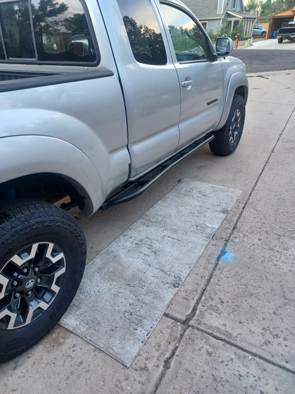

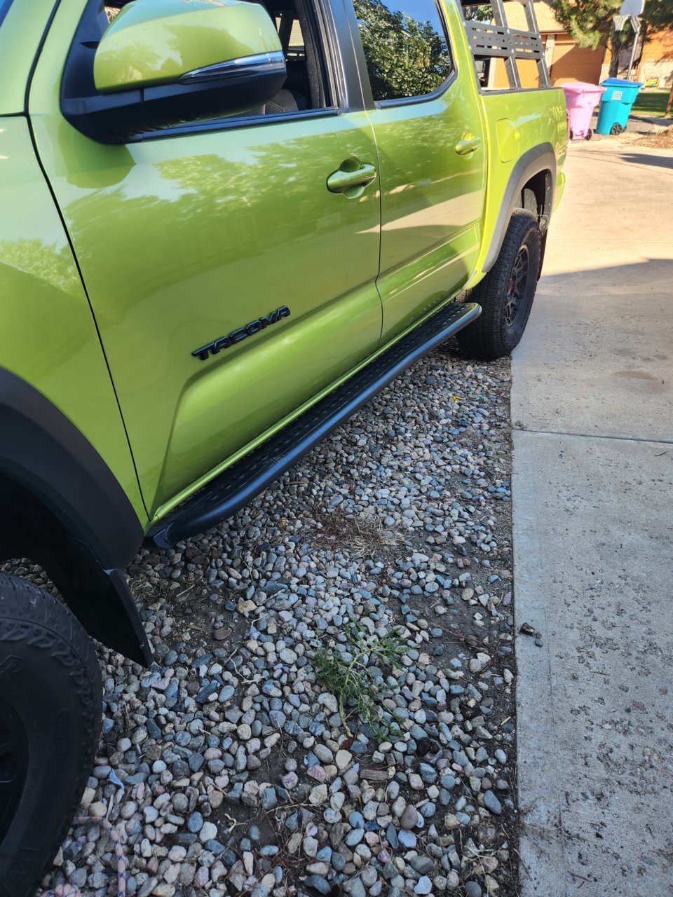

    A few, mainly added skids. I like leaving the suspension alone. I drive forest service dirt roafs in the desert west extremely extremely too fast. Toyota nailed this suspension going 65 across desert terrain. Changing it is dumb unless you have a specific need like crawling or mud.
    Ouch bro.. go buy a nice set of sliders. Lesson learned. I'm a big fan of not pulling dents. Let your truck age.
    You clearly were exceeding your tacos ground clearance. I'd look at finishing all your plates as well. A-ARMS, transmission, transfer case and rear diff...
    Your truck will thank you later

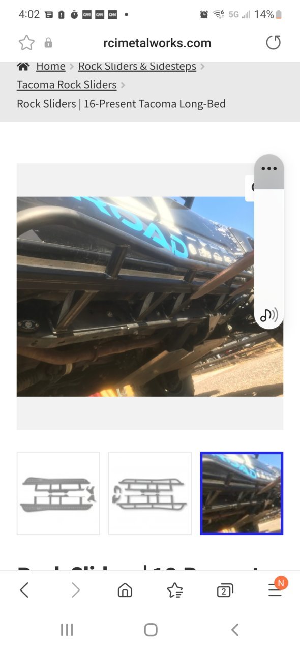

    Rock sliders are not step bars. They attach to the frame, and force the impact out and away from the truck (if you didn't know). You can pick up either one of my trucks by the slider using a forklift. That's how strong they are. But you only need them in Rocky terrain, otherwise they are just weigh.
