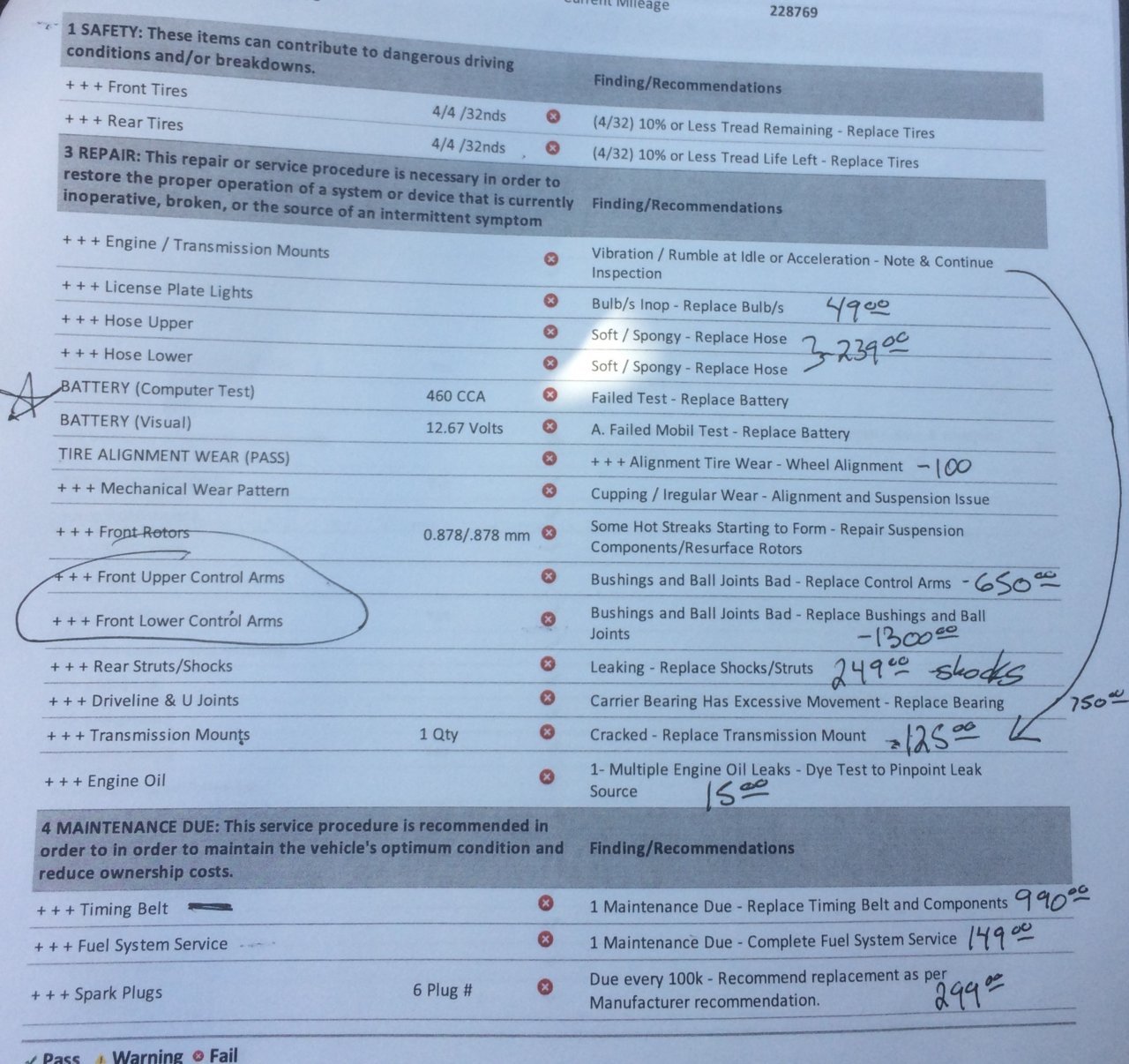

    I won't be in a position to buy a new car for a long while, I'm aggressively attacking my student loan debt. Seems like it will be more cost effective to fix the existing car instead of buying a beater, but I could be wrong. I live and work off the light rail in Phoenix, so that hasn't been so bad for getting to/from work, especially since it's cooling off now.
    Just bought new tires a few weeks ago, the ride has been a lot better. Figured I would take care of the arms and maybe replace the front coil overs since I'll be in there anyway. I suspect the rear shocks are fine. Rear leafs are pretty flat, but I don't do much hauling these days.
    When I replaced the spark plugs I wiped the engine block down pretty well hoping it will make it easier to spot leaks. I haven't seen any yet. Not sure if they had spotted old oil or what, but I haven't noticed any leaks :notsure:
    Recently changed the oil and filter and did a coolant flush when I replaced the radiator. I haven't checked the tranny in a while, I was going to look into the procedure for getting that fluid changed out.

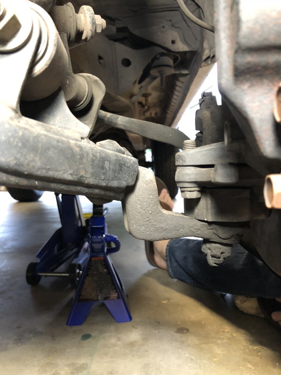

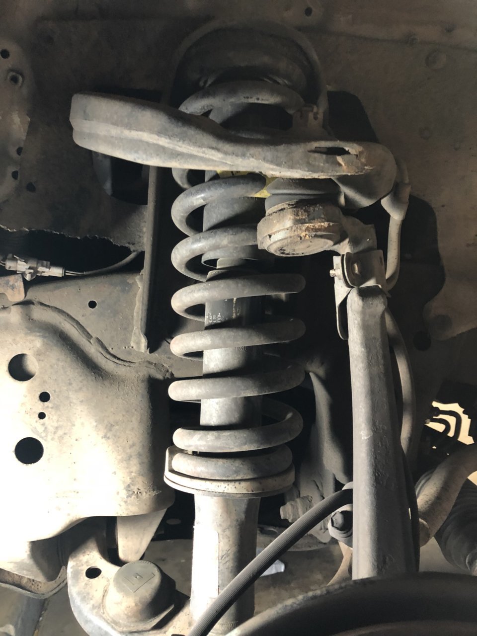

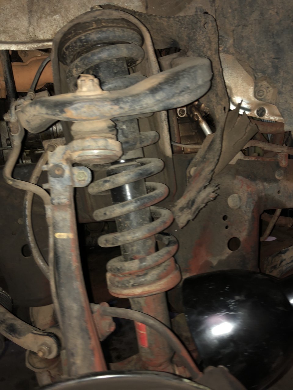

    Okay, I had an opportunity to change my brake pads over the weekend and took some pictures. I can’t see any evidence that the shocks are leaking, so I think I'm gonna leave those until they bust (though quick-struts are crazy cheap on amazon right now).
    I followed bartmaster’s advice and tried shaking the wheel while it was on jacks. There was a lot of movement forward and backward. The bushings are definitely bad. The ball joints look okay, but a quick look around the forms shows they typically fail with little warning. I'll look into getting those replaced, it seems they're prone to failure and fail catastrophically.

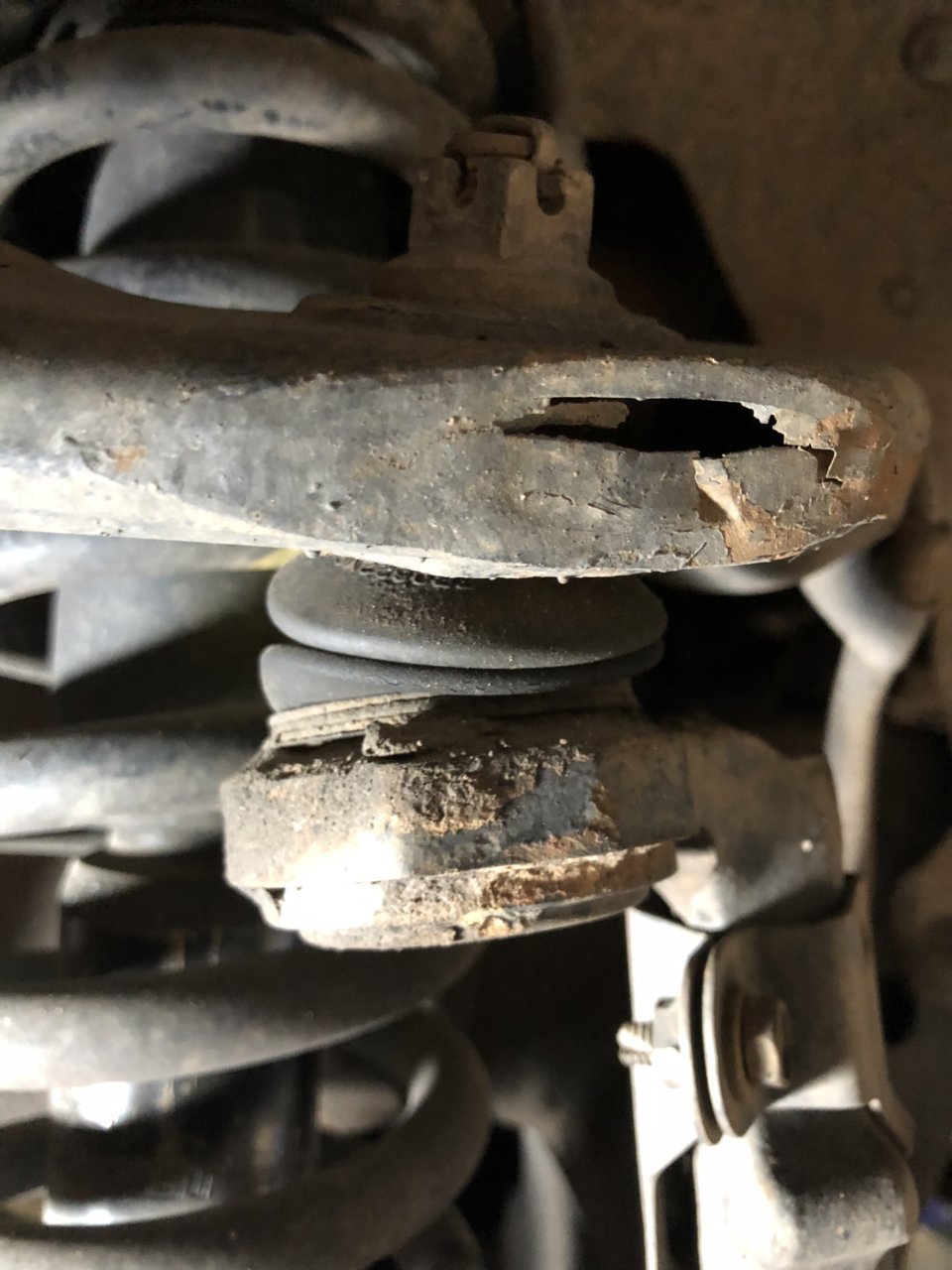

    Would someone mind taking a look at my upper control arms? I believe they're stock, but there's a hole in the side that has me a little concerned. Not sure if it's worth replacing them or not.
    I'll upload photos in a moment....

  11. Oct 10, 2018 at 11:12 AM
    #31
    MacGyvR
    MacGyvR [OP] Well-Known Member
    Jul 21, 2010
    #40533
    449
    Tom
    Dallas, Texas
    03 Prerunner (5VZ-FE)
    OME 2.5", 881, Dakar, Nitrochargers
    Photos328A00B0-27DA-453F-BE8A-D9E6755D7D18.jpg70730D83-455C-44C5-BD66-7CF780DAD089.jpg0597F740-F98E-46DC-98D0-B11E6417B6CF.jpg5D534032-90C3-41C3-AD3C-5A2A62160FDA.jpg2CA2423D-ED4F-40DB-A382-8430BCBE629D.jpg5AEE15B4-F1D5-44B4-BA77-302042B191CA.jpg
  12. Oct 10, 2018 at 12:08 PM
    #32
    DashMaple
    DashMaple Well-Known Member
    Feb 11, 2018
    #244129
    981
    Louisiana
    01 V6 4wd PreRunner DCSB OME lift
    I would definitely replace those UCAs, my suggestion would be to go with some stock replacement off rockauto or grab some JBAs if you have the spare cash
    MacGyvR[OP] likes this.

    Okay, I've been slowly making progress on all of this. I'm looking at pulling the trigger on this: With the 881 coils. My current suspension is made up of monroe quick struts that have 60-80k miles on them and my original leafs with 240,000 miles on them. This kit should replace all of that nicely while providing a bit of lift.
    I'm unsure of whichs UCAs to get though. Wheelers wants to bundle some SPCs, but since this is a prerunner and my daily driver that seems like overkill. Should I go with stock? Are any of the daily driver options on rock auto good? Do they come with replacement upper ball joints?
    Aside from that, gonna pick up some lower ball joints ($130) and new bushings for my LCAs. Is there anything else I should do while I'm down there?
    Really excited to see how she rides after all of these replacements with new tires!

    Is that a hole in one of your upper control arms?

  17. Oct 18, 2018 at 12:46 PM
    #37
    MacGyvR
    Jul 21, 2010
    #40533
    449
    Tom
    Dallas, Texas
    I had my steering rack replaced a few years ago, would that have come with new tie rod components?
    I'm new to a lot of this front end stuff. Taking my time to research and understand. I'm hoping to order everything in about a month
    It is a hole! It's starting to make me nervous, so I'll replace it while I'm down there. What are you looking for price wise? I was looking at buying these as a replacement:
    https://www.rockauto.com/en/moreinfo.php?pk=6691504&cc=1418453&jsn=18
    https://www.rockauto.com/en/moreinfo.php?pk=6691508&cc=1418453
    They're like $60 on rock auto, but I don't know if they're any good though. The part numbers don't return any results in TW. I like that they come with new ball joints.:notsure:
  18. Oct 18, 2018 at 12:52 PM
    #38
    frizzman
    frizzman Well-Known Member
    Sep 25, 2013
    #113212
    5,348
    Pittsburgh, PA
    04 XCab 4x4 TRD/OR
    OME 2.5,Tundra 17s,Falken Wildpeak AT3W hitch w/ 7-pin, ARE cap, JVC HU w/BT, HID/LED lights
    those are not the correct UCAs, do not order them.
    those are for 2wd NON-PreRunner
    4wd and PreRunner have the ball joints pressed into the knuckle, then the ball joint goes through the UCA.
    MacGyvR[QUOTED][OP] likes this.
