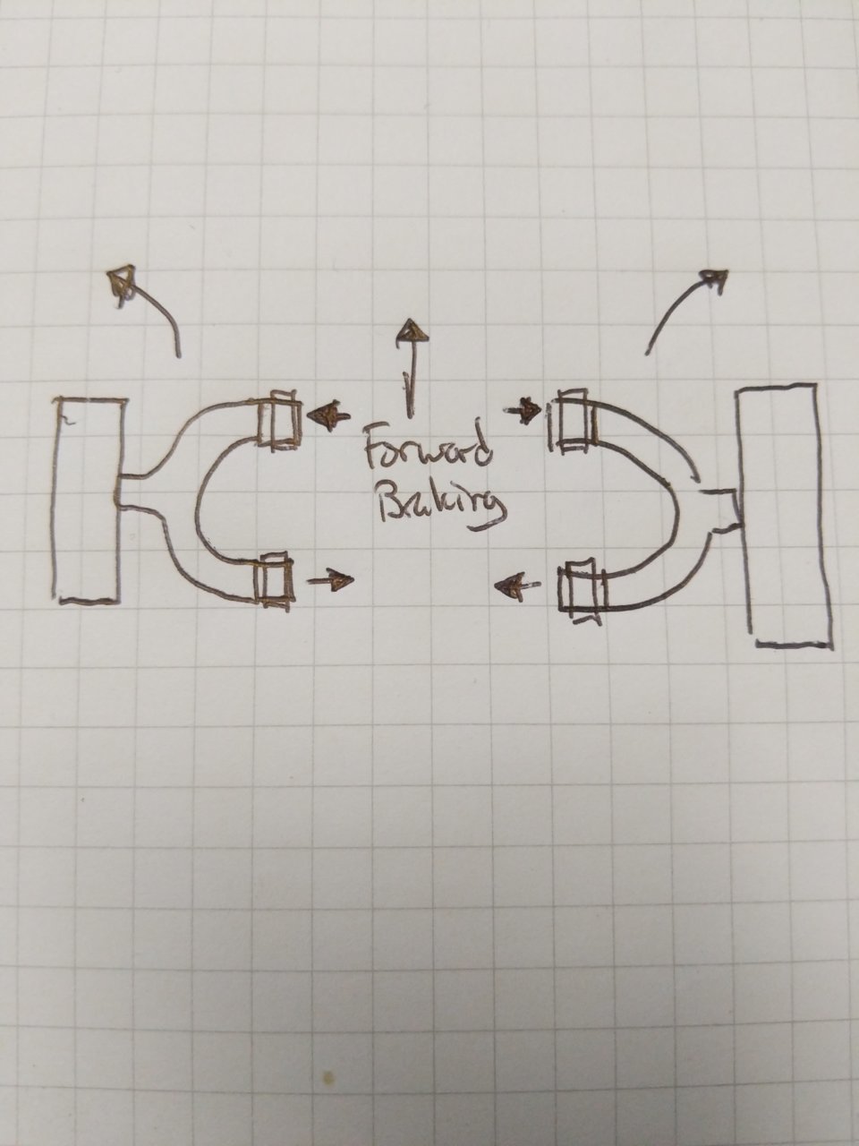

    I've been chasing down a hard pull to the left.
    Everyone laughing at my idea its been the LCA bushings.
    I had replaced every suspension component including a big brake upgrade to rule out sticking caliper.
    Finally did the LCA bushings this weekend and the truck now goes straight under hard braking.
    Used to damn steer me into the divider.
    -Interesting enough, the bushings didn't appear bad. I pried with a big screwdriver and wasn't feeling any slop.

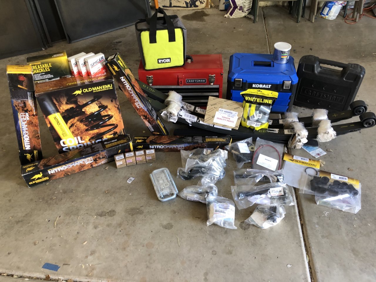

    Okay, I'm gearing up to buy the final pieces so I can do this in the next week or two.
    So far I've acquired a new suspension package from OME, a new steering rack bushing kit and a bunch of new tools. This week I'm buying some whiteline bushings for the LCAs, likely OEM bushings for the UCAs, upper and lower ball joints, and an intermediate steering shaft. Somebody mentioned I should do my tie rods since I'm replacing everything else. Should I do the inners and outers? For the tie rods I've identified these parts:
    45046-39295 - Right outer tie rod
    45047-39175 - Left outer tie rod
    45503-39075 - Left inner tie rod
    45503-39075 - Right inner tie rod
    Is there anything else I should do while I'm in there? Do I need to replace boots or anything for the tie rods? I haven't looked into what's involved with replacing them yet. I'm not eager to spend more money, but I don't want to have to go back in there for a while, you know?
