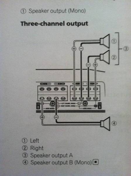

    Going to run it like this:

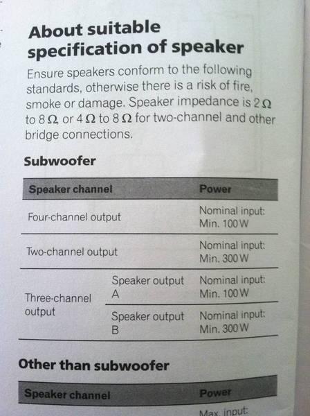

    It says the the RMS power range for the sub is 50-300? If I the set the amp up as a three channel it says-
    speaker A output= nominal input: min 100W
    speaker B output= nominal input: min 300W
    So B would be set up as the sub. I just want to make sure what I think is right and will work is actually correct! Lol

    Yeah, you'll be fine running 300w to the sub. Just means you should have zero chances of frying the voice-coil. Then again, I'm putting about 750w per sub at them, and they take that like a champ. Just be prepared for a large magnet. It's a shallow mount sub, but the magnet is huge!
