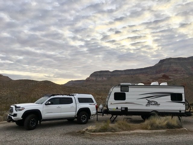

    Those are cool trailers, and the Tacoma can tow it with no issue, but personally, I think they will be happier with a Tundra. I have a 3500 lb 20-foot Jayco, and we enjoy taking it on the road with my Taco, but Like said above, full-time towing requires a lot of attention and monitoring the truck. The trailer doesn’t weigh that much, but with all their gear and supplies added on for full time living it could easily exceed 5000 lbs. Mileage will be 10mpg on interstates and mountain grades, and a bit better on slower highways. If traveling back roads, they will also want to carry extra fuel or plan to make more frequent fuel stops.

    I tow the same camper (16BHS ~3500lbs dry) with my TRD OR and all the above posters are correct: Generally 10-12mpg with stops every 2-3hrs for fuel, I use a WD hitch which helps things out considerably, and looking to install airbags this summer to help out the rear end a bit. Since mine is a MT the gearing seems appropriate for the load, and I sit in 4th on the highway with some shifting to 3rd and 5th for inclines and declines respectively.
