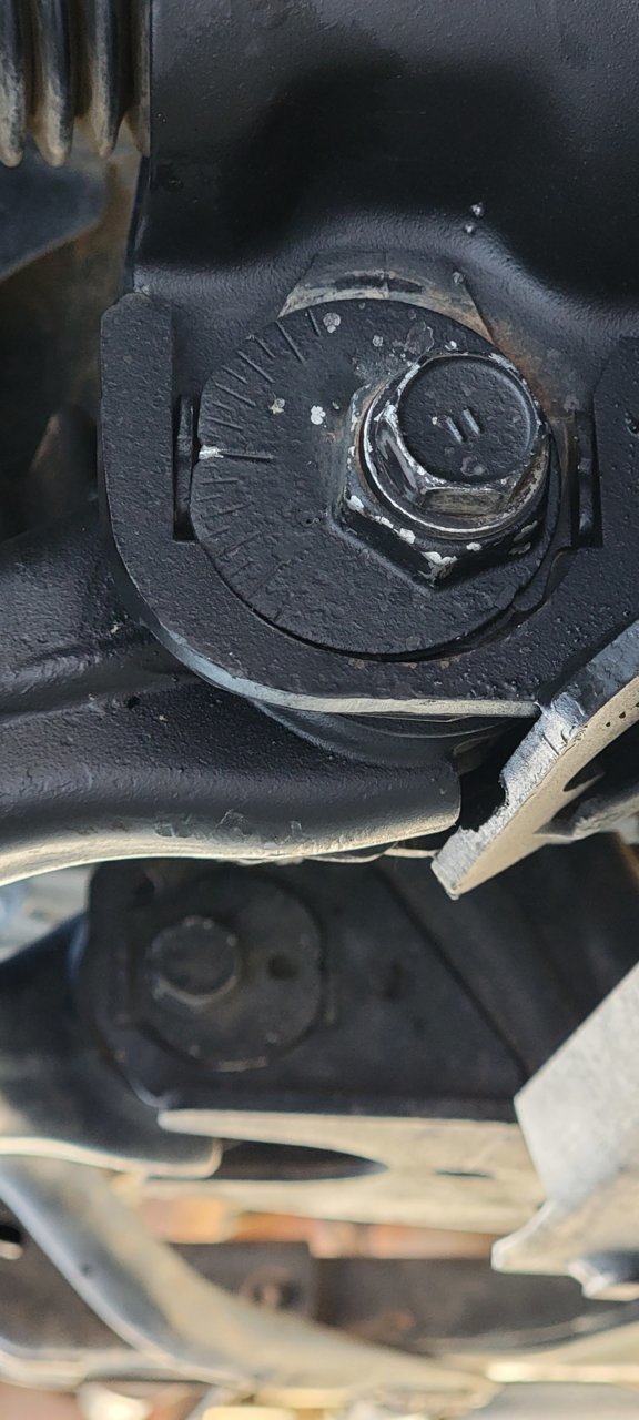

    Current setup on my 19 TRD OR DCLB is full Elka 2.5 IFP, Camburg UCA, and Icon RXT leafs stage 1. The coilovers are at the max preload and caster is maxed out right now which is around 2-2.5. Running 265/70/17 on SCS SR8s -10 offset. I had to removed mudflaps because of rub and no trimming has been done so far. From what I have been reading I shouldn’t have no rub even with the mudflaps but they are all over them so with my caster being maxed out. Should I have gone with a different UCAs to allow more caster? Current hub to fender measurement is driver 23 1/2 and passenger 23 3/8. Thanks!!!

    Did you verify front lower control arms are actually maxed out on caster? Or just go by what the alignment guy said?

    72
    Yes mudflaps are removed. I did not verify that the LCA are maxed. How do I determine that they are maxed out?

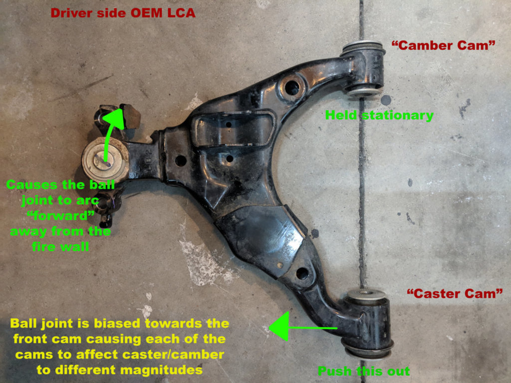

    Rear cams would be adjusted outward all the way or near all the way. Took this photo from another thread.

    Ok so need to check rear LCA to confirm being maxed?
  11. Aug 11, 2021 at 6:18 PM
    Vegasstunts
    Vegasstunts Well-Known Member
    Dec 27, 2019
    #314287
    751
    16 TRD sport
    All of them.
    You get more if you suck the front cam all the way in. My tire moved like 2 inches forward.

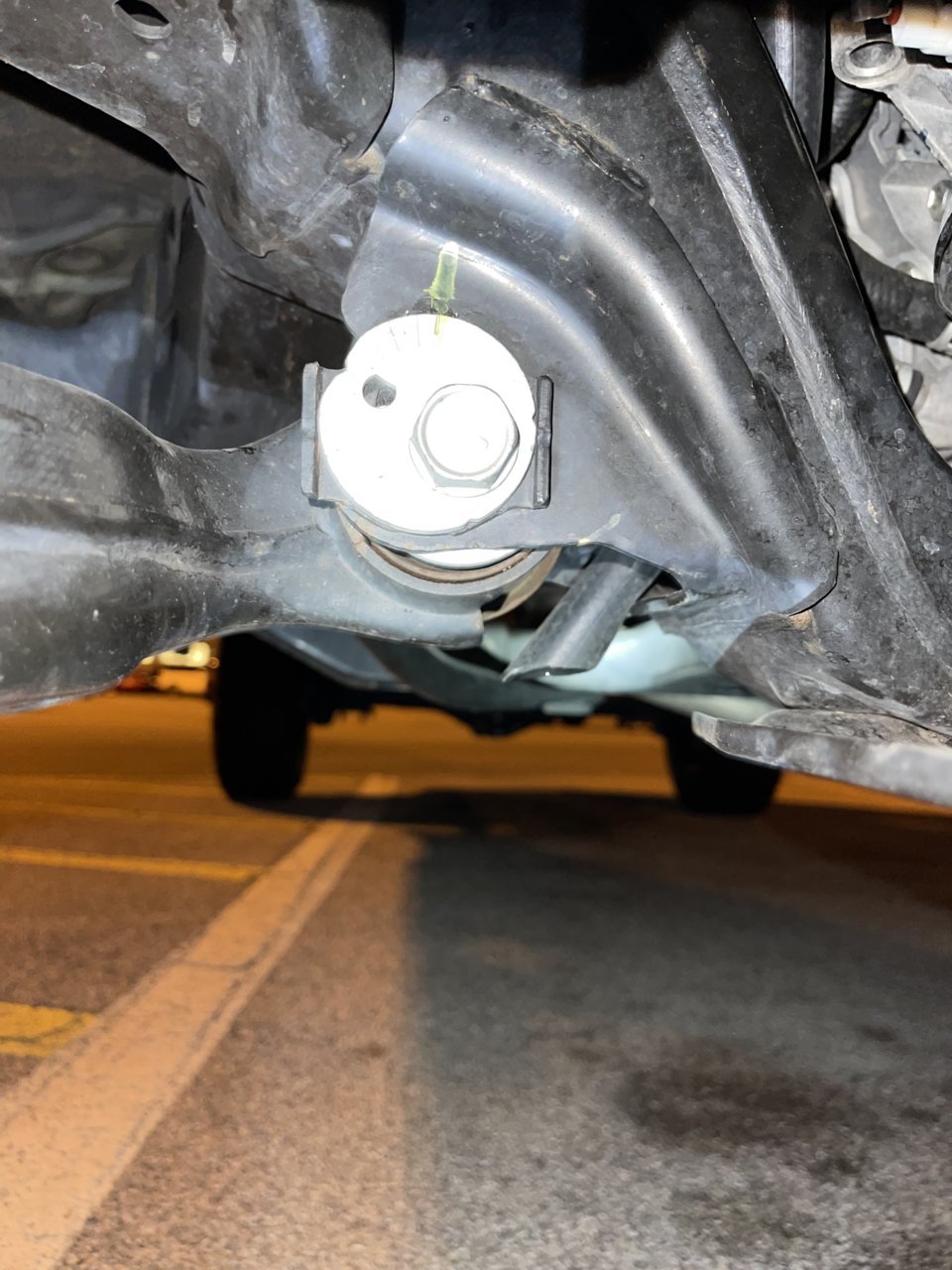

    I'd take a pic of the LCA front and rear cam tabs. Post them up.

    All of them.

    Gonna try to get some pics.

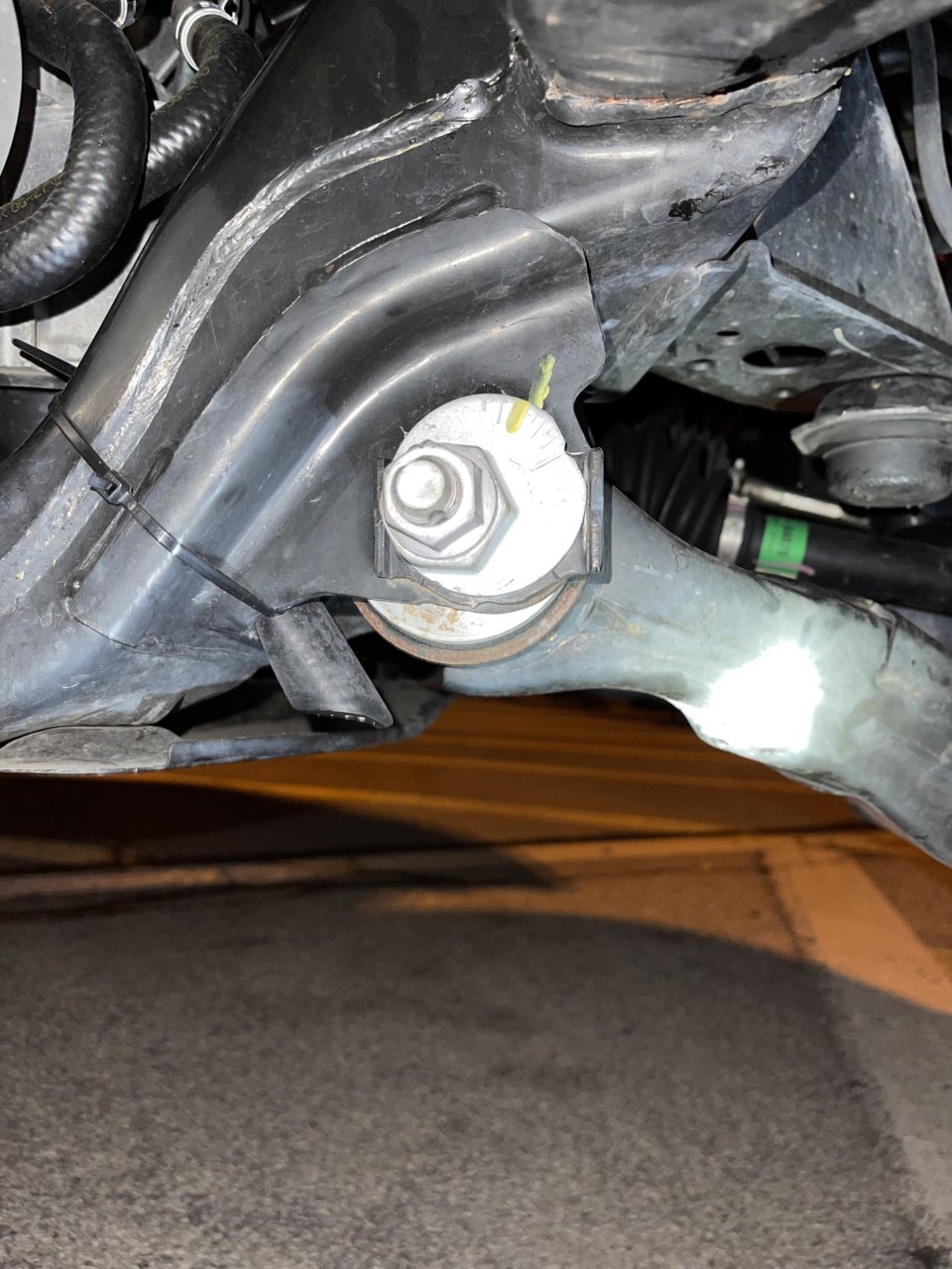

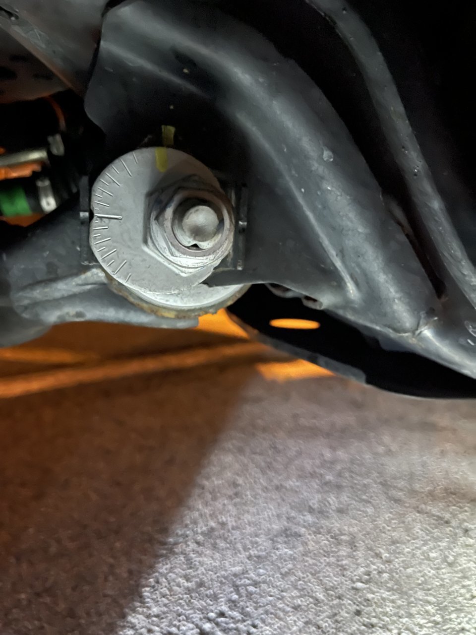

    Some driver side pics
  17. Aug 11, 2021 at 7:14 PM

    72

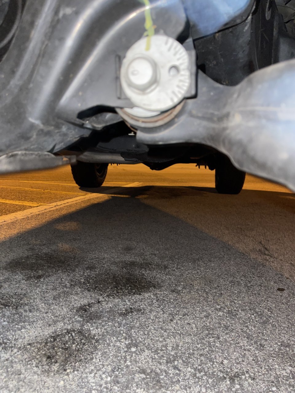

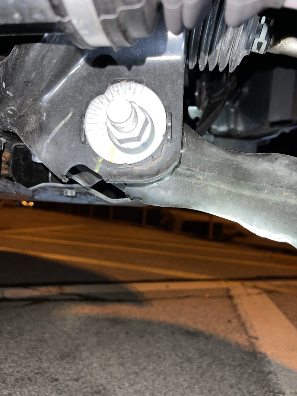

    Passenger pics

    All of them.
    That is way wrong. Your tire is pushed back, no forward. Whoever did your alignment had no idea what they were doing

    Yeah you are about as maxed the wrong way as possible.
    I had the same wheel offset and tire size and you and had the same problem. This is the reason why.
