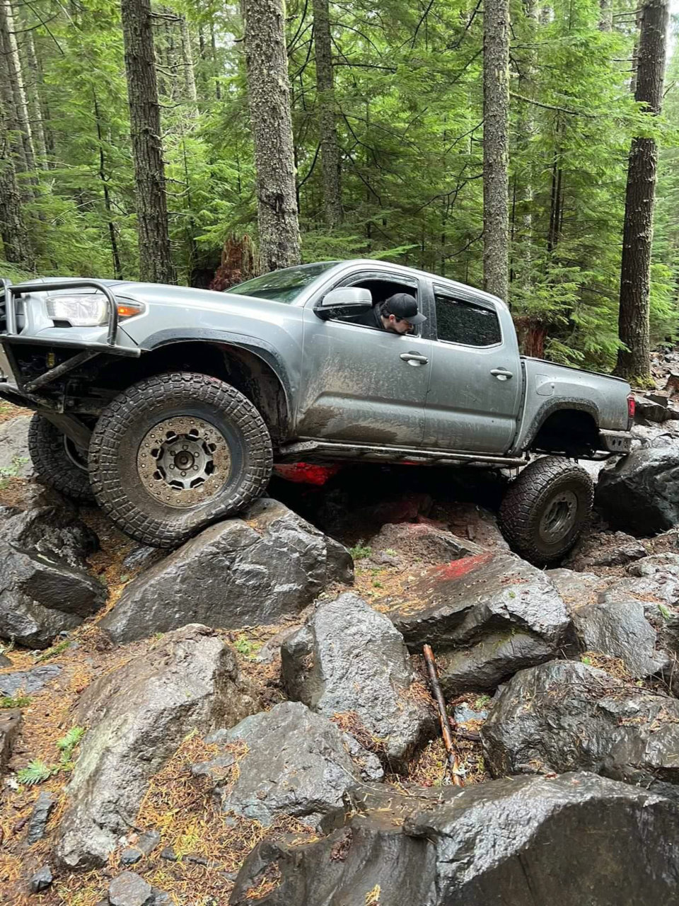

    Get Oem, I'm still running my factory wheel bearings with 80k miles on 35s/37s with -44mm of offset, heavy beadlocks. I had one bearing go bad, but it was because I fawked off a seal and the bearing rusted.
