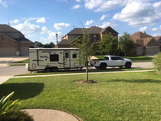

    I tow a 23fb Ultra Lite from Forest River. 4101 dry weight. 508 lbs tongue weight, 1377 cargo weight. I never haul with water tanks loaded. Truck is a 2017 trd sport. 3 inch suspension lift.
    Ie add a spring in the rear and adjustables in the front. Have a 1 1/2 inch rear drop with weight distribution hitch. Never got passed by a bicycle yet. I use a P2 brake controller. When towing I get about 7.5 - 8 mpg. No better. Would love to have a bigger fuel tank. Wife likes the small truck, says no to bigger one. By the way put a cat back exhaust systems. When wife is in truck she ears ear plugs. I turn my hearing aids off. 250 mile trip we have to stop for gas three times.21 gallon tank x 8mpg = +/- 160 mile range max. I don't cut it too close.

    I live in Central Texas, wind all the time. I have not had any problem with wind or handling. Get a good brake controller. We got a P2. Do Not use cruise control unless you are on really flat land. I use third at 4000 rpm at about 60-62 mph.
    I am now ordering an aux fuel tank, 37 gallons. It will fit between the wheel wells and front of bed. Has pump to fill primary tank as you go.
    width = B 48
    depth = C 12
    height = A 15
    cubic inches 8640
    cubic inches in a foot 1728
    total cubic feet 5
    gallons per cubic foot 7.480519
    gallons in aux tank 37.4026
    gallons in truck tank 21
    total gallons 58.4026
    Range at 7.5 mpg 438.0195
    Range at 8.0 mpg 467.2208
    Range at 15mpg 876.039
    Make sure you don't exceed your weight ratings. My TRD Sport 2w drive, 6600 lbs max tow weight, 660 lbs max tongue weight. Remember tongue weight subtracts from truck bed weight capacity. PS Originally from Baton Rouge.
