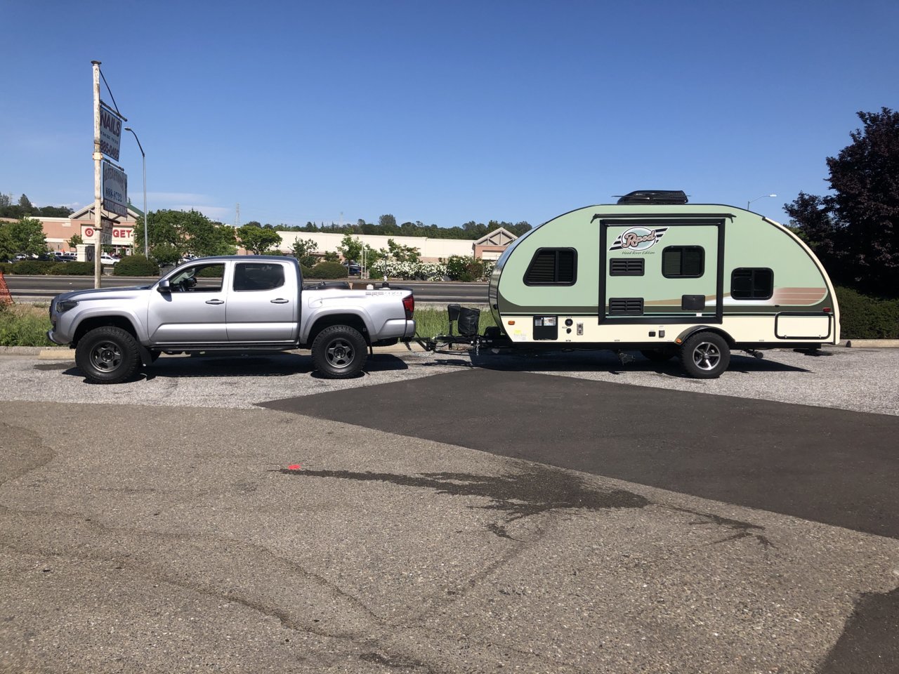

    17C6A1EA-83D8-4ED9-BB00-F2E6AA38636D.jpg You may or may not have seen some of my posts regarding towing. I'm rocking a 2019 DCSB 3.5l Auto Trans. I had a couple tows with my trailer bone stock and most recently after modifications and re gear. a little about my current setup. 2015 Rpod 182G, 3100lbs dry weight and about 3800lbs loaded up, around 450lb tongue weight. Trailer is about 20ft long. Truck 2.5" lift 285/75/16 (33"s) 5.29 Gears and OvTune. Towing mods, Prodigy P3 Brake controller, Firestone Ride right Airbags, Weight Distribution Hitch and Sway Friction device.
    In stock form with stock tires my truck pulled the trailer very well. Once i started adding tires, lift, and weight, gears will be a necessity if not already. They make a huge difference and with your setup and the trailer you're looking at i would 100% look into re gearing as your next mod. With my current setup my truck can just barely hold 5th down the highway rolling 55/60mph and averages around 10/12mpg, once i hit any hill or headwind i downshift to 4th and run around 3100rpm at those speeds and average around 8/10mpg. I think you'll be fine but i HIGHLY recommend both a Weight Distribution Hitch and Airbags both. The airbags will help compensate for weight/gear carried in the bed, while the WDH compensates for tongue weight. Any weight rear of the rear axle counts toward tongue weight as far as the WDH Spring bars are concerned, so the different loads you carrry are what the Airbags will be for. Also i love the Prodigy P3 Brake Controller its been fantastic and the brakes always feel perfect.
    edit: also i recommend a Scangauge 2 so you can monitor Trans temps and what gear you're actually in.

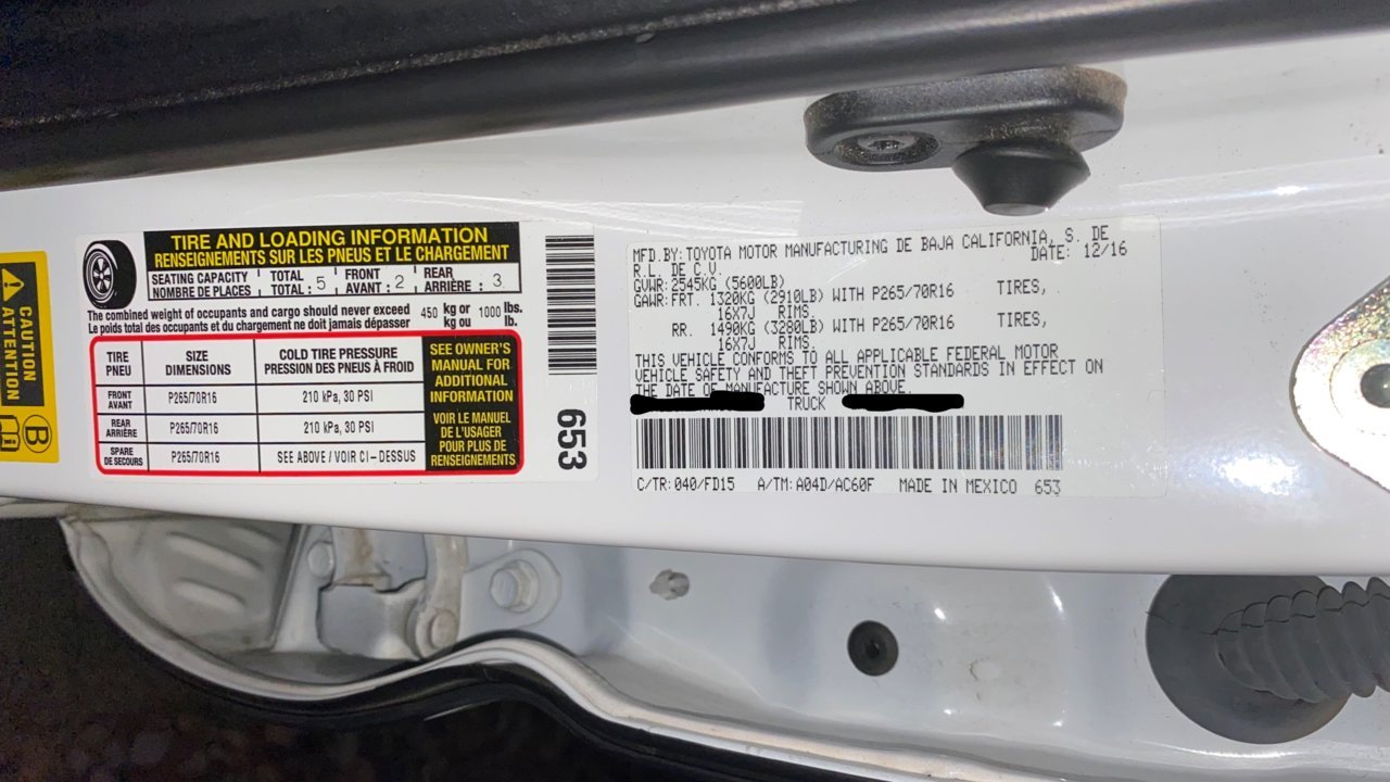

    Inside the drivers door will give your trucks capacity. The webs says 1620 lbs (which sadly is more than a CM Tundra)/6800 lb towing capacity. Your's could vary due to options.
    The 467 lb hitch weight is the empty rating. This weight will only go up with gear and what not. We should use the max capacity, and use 10% tongue weight (even though the empty tongue weight is 12%) and go off that. You could have a hitch weight of over 600 lbs pretty easily.
    1620-600=1020 lbs left in capacity.
    SAE J2807 towing standards allows for two 150 lb occupants and a 70 lb WDH, so 370 lbs. You said 475 lbs for occupants and two 60-70 medium sized dogs. 105 (humans)+130(dogs)= 235lbs
    1020-235=785 lbs left in capacity. Not bad.
    What kind of camping are you planning? You do dispersed or are you a full glamper and need hookups? The reason I ask is this will totally affect the weight. If you Glamp, no need for a generator, water, and most likely can go light on supplies. Dispersed camping....different story. So plan on those additional weights (this is why I use Gross Trailer Weight).
    The only thing left is the additional weight you add with modifications that needs to be subtracted.
    From the math perspective, you should be good.

    Just reading off the net man. This is why I told him to look inside the drivers door to get the actual payload capacity of his truck, then do the math.

    Thanks for your advice! it seems that from my door jam that is say i have a 1000. I dont know if that is with the stock tires or not and i dont know if the Falken Tires i have have made it better or worst.

    1000-600=400 lbs capacity left.
    400-235=165 lbs capacity left.
    You will be cutting it close. I really doubt you will ever use the full capacity of the TT, so there is that. Food for thought.

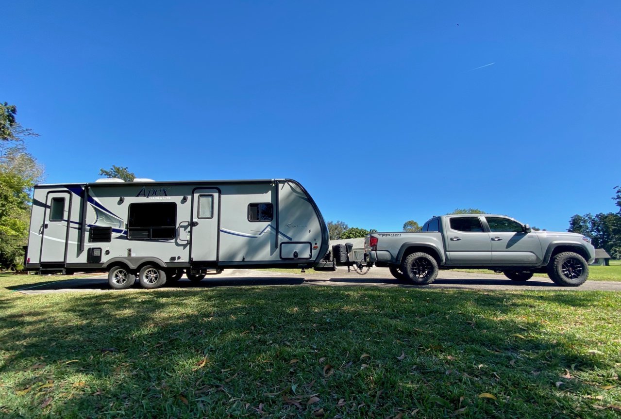

    You will be easily over Payload between the family, dogs and hitch. 6000 loaded is getting too close for me tow capacity. I like atleast a thousand pound buffer but many laugh at that idea.
    To me it's too much trailer for a Tacoma. 20 minute tow ok. But any real distance it's too much and will beat the hell out of the truck in my opinion. My trailer is 5500 pounds and I thought that was beating the hell out Of the truck. For a Tacoma I say keep it under 4000 pounds loaded and even then it's most likely over Payload.
    Oh and the Tacoma having such a small gas tank sucks too. It will only be getting 8-11 mpg when towing depending on terrian so it's not giving you much range between fill ups.
    Get a smaller trailer Or bigger truck and you'll be much happier.
