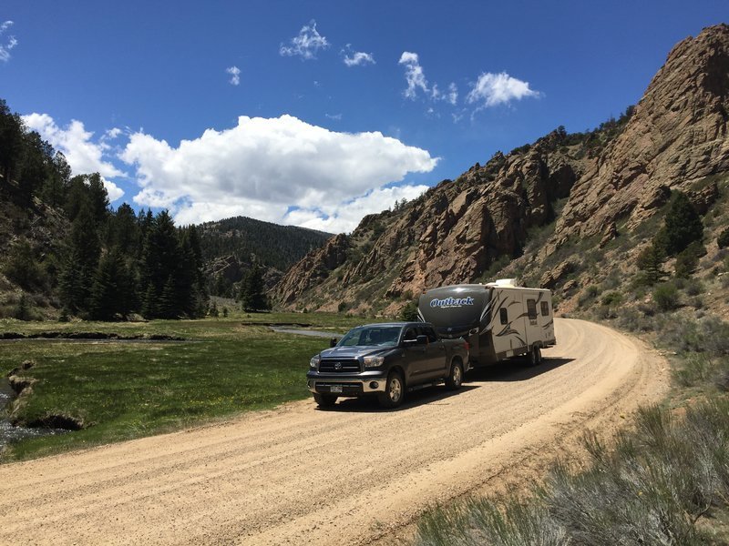

    The renting idea is awesome. We were supposed to do that with our Tundra. Instead, I went off load ratings, trailer weight and figured it would be fine since “others” towed bigger campers.
    That was an expensive oops.
