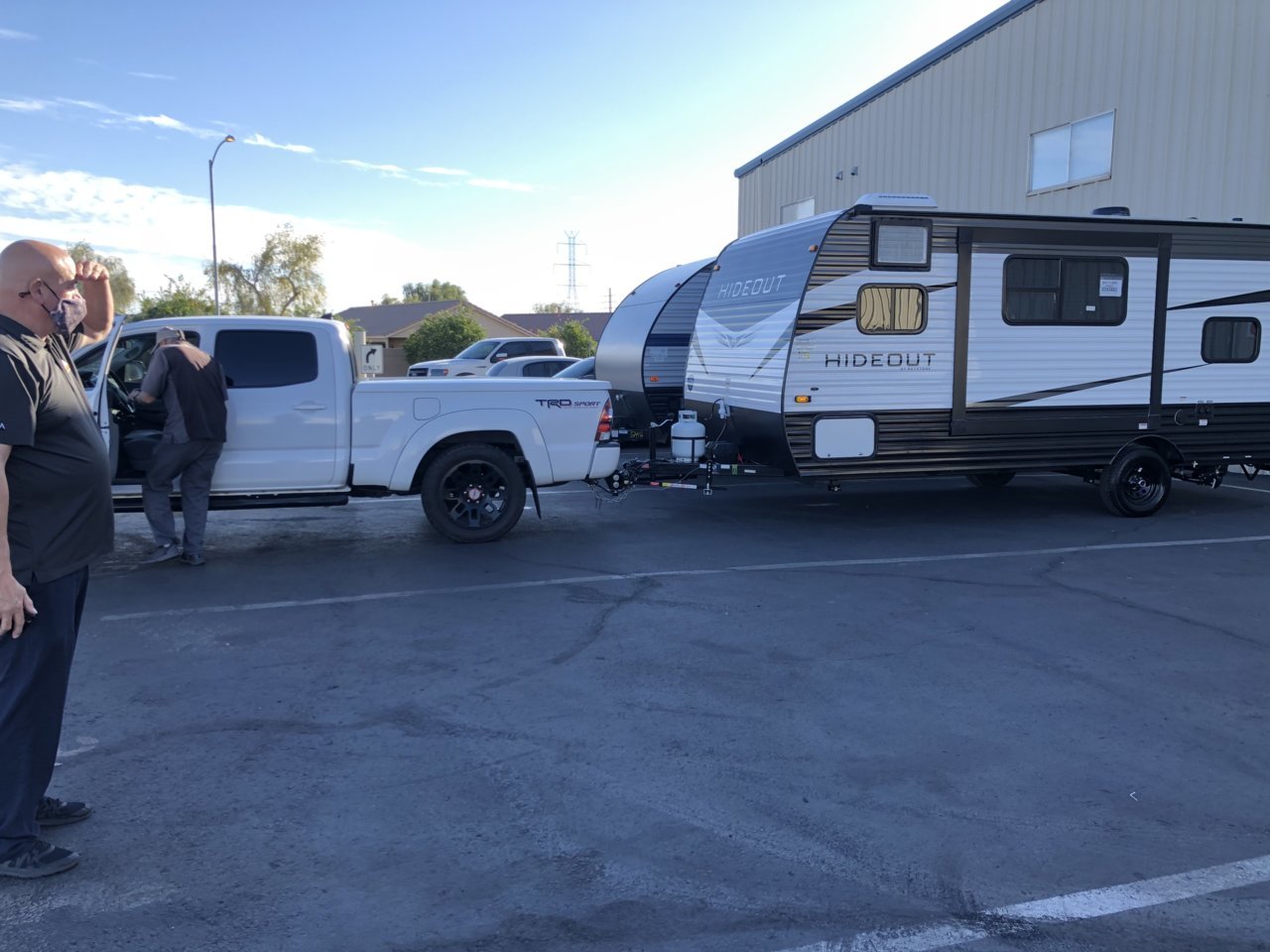

    Here is a photo of the rig attached
    before the sumosprings and w/full fresh water tank (drained before leaving)

    Water is really heavy and consumes a large amount of cargo capacity.
    1 gallon = 8.3 lbs
    Suggest to use the campsite hook-ups or the water fill station at the camp. Don't haul water when its avoidable.
    The larger tires will have 2 primary places of effect. Pulling torque and empty weight of the truck. I doubt either will have a beneficial impact.
