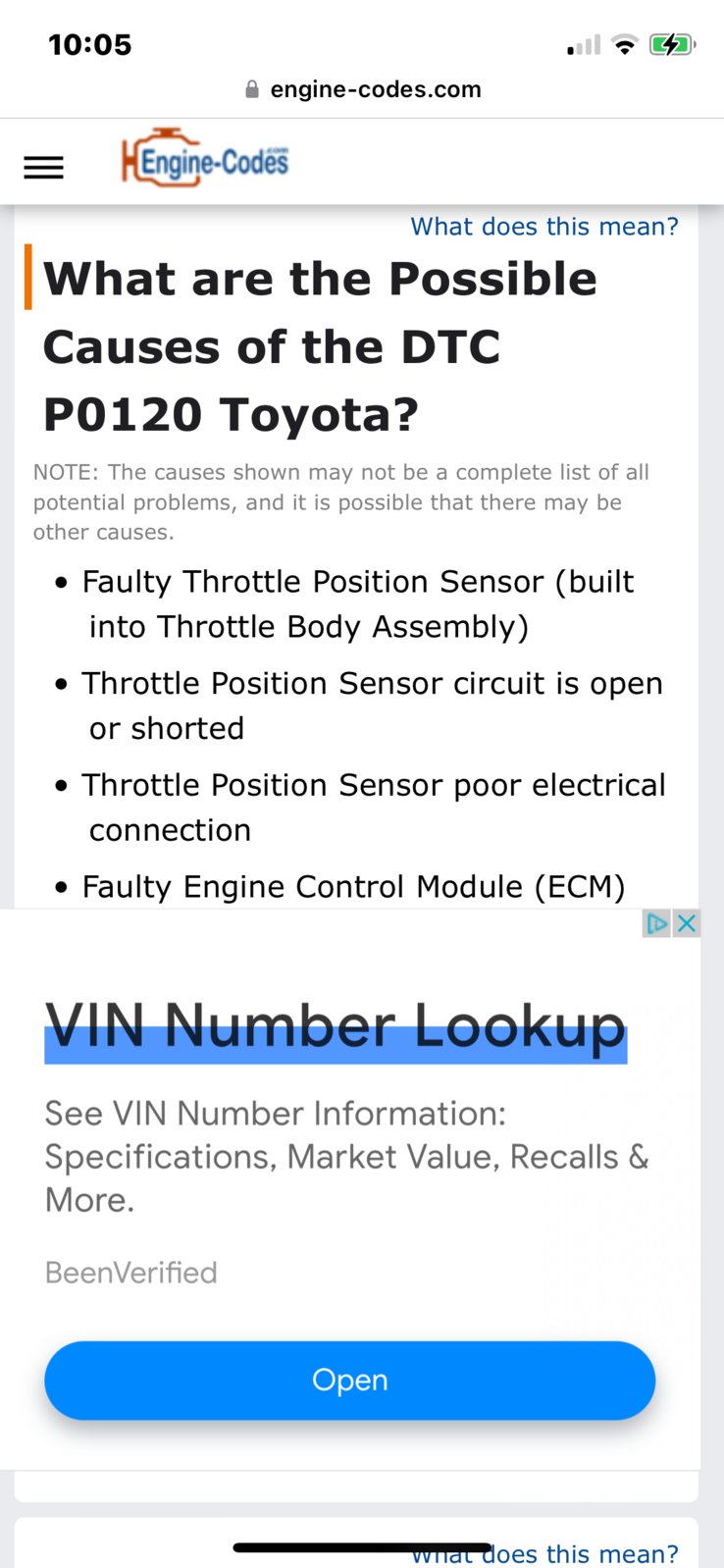

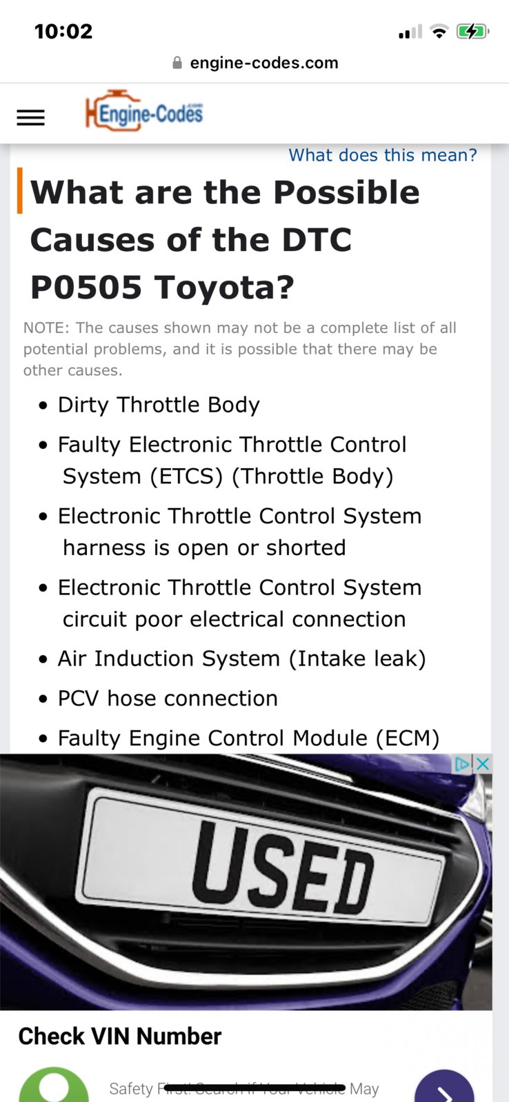

    Some start pts….

    Lots of possible causes pointing to throttle body…..both codes
